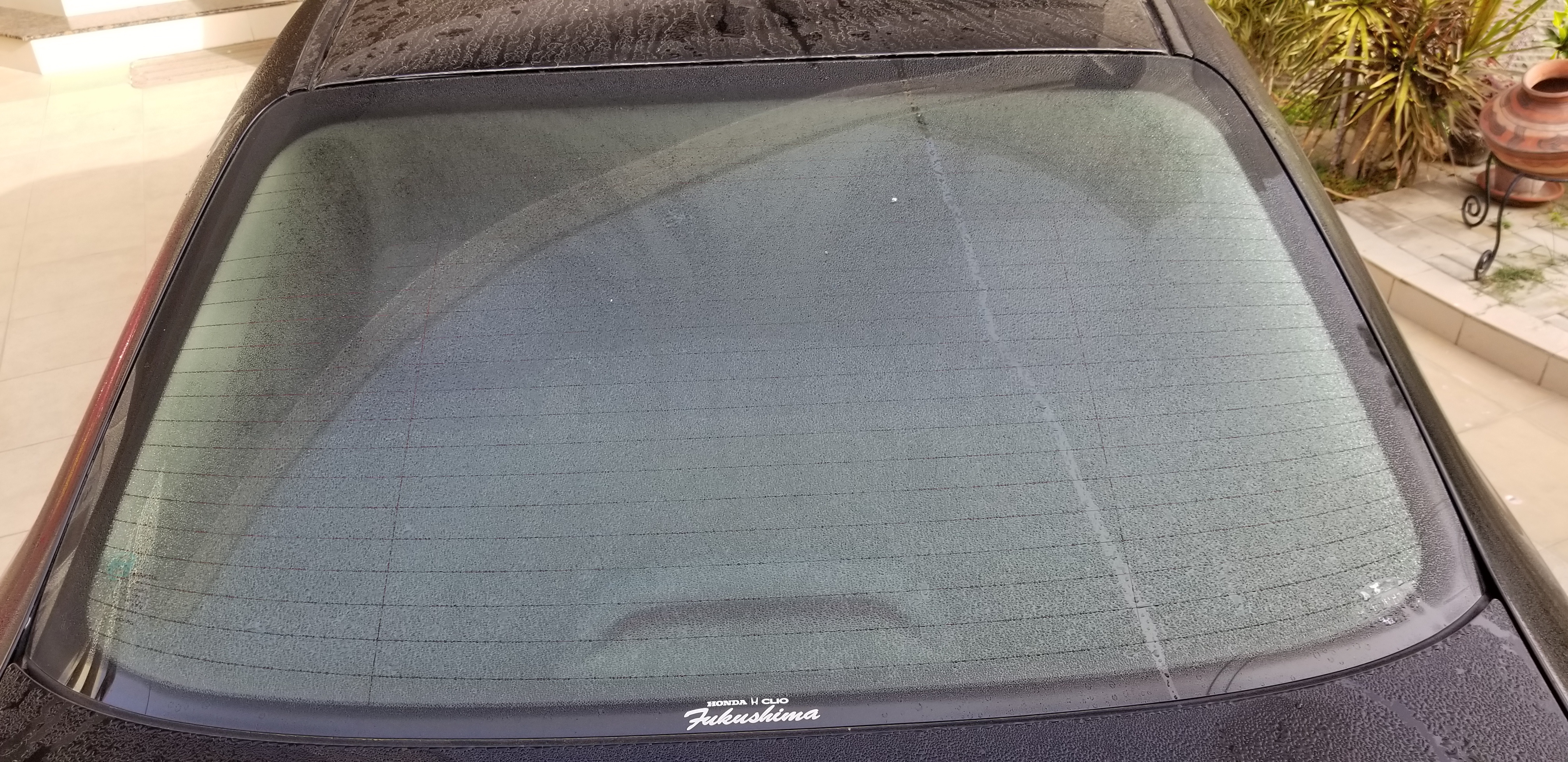

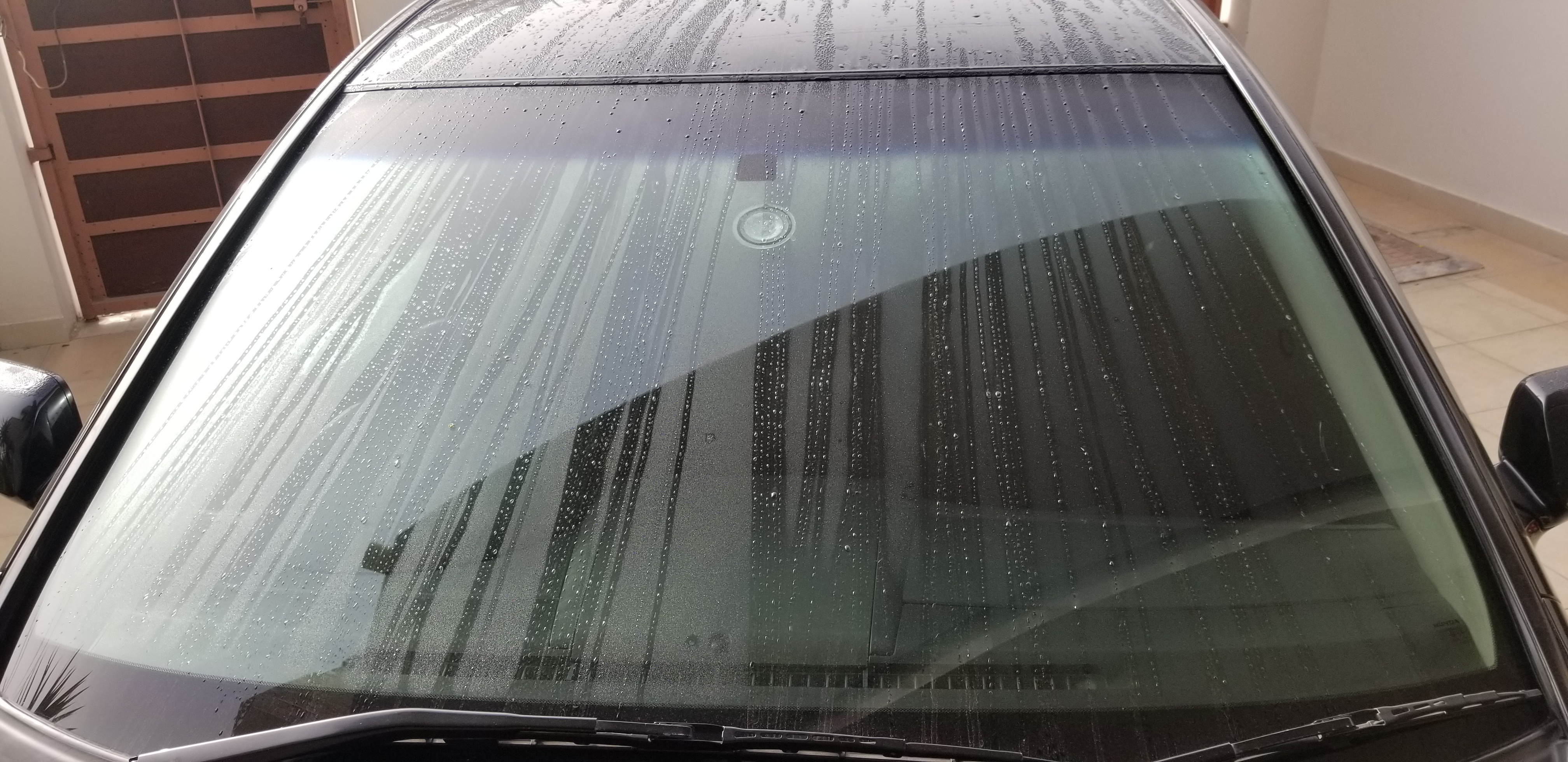

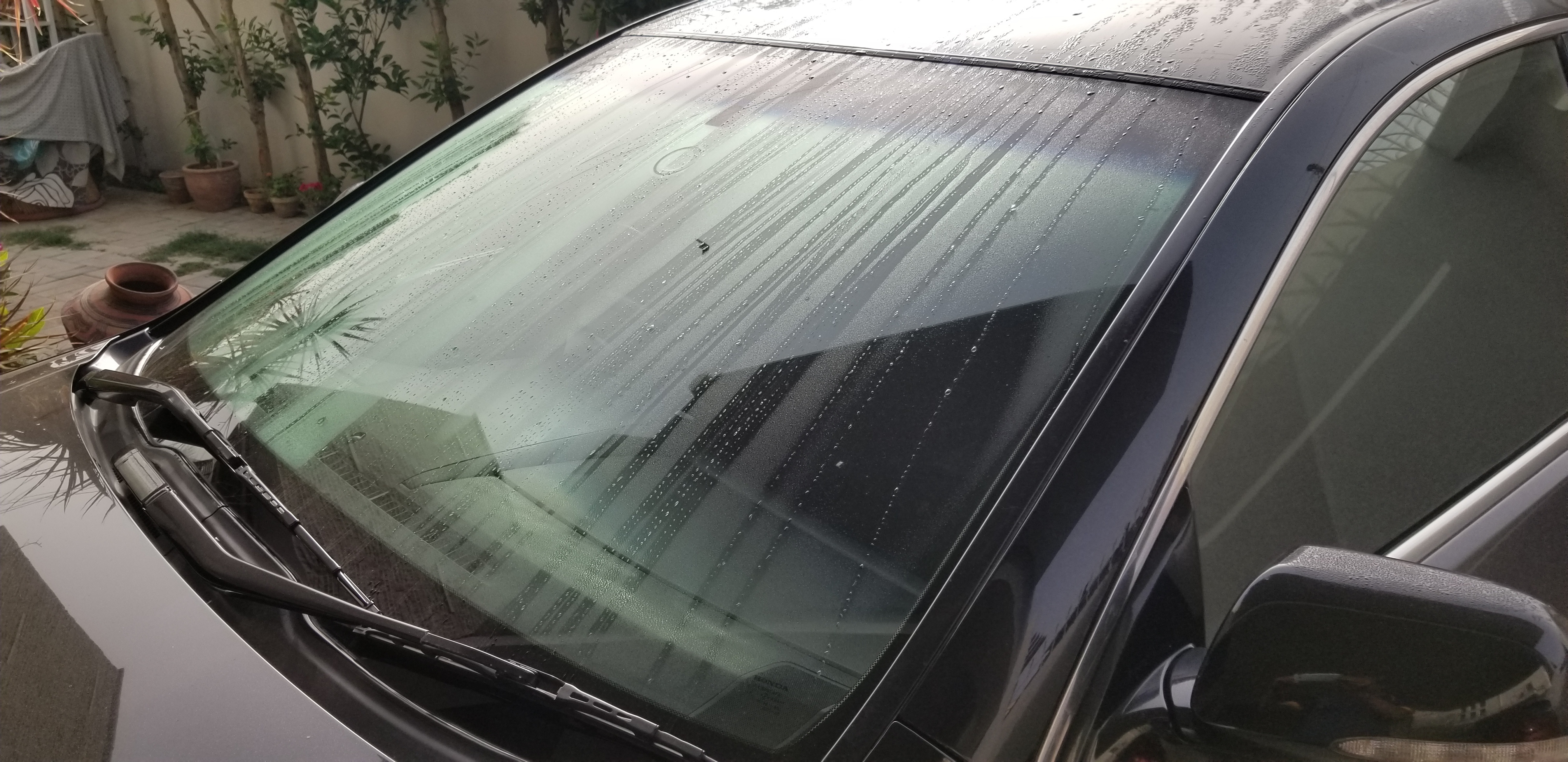

Insane dew in Karachi DHA these days. Approached my car which had been parked outside and was perplexed to see that there was more dew left over on the rear screen compared to the windscreen, even though the rear was facing the morning sun and should've been drier. Then I recalled that I had applied Fusso Coat to the windscreen couple of weeks ago whereas the rear is untreated. Fusso clearly doesn't last as long on glass as on paint, but man does it work.
