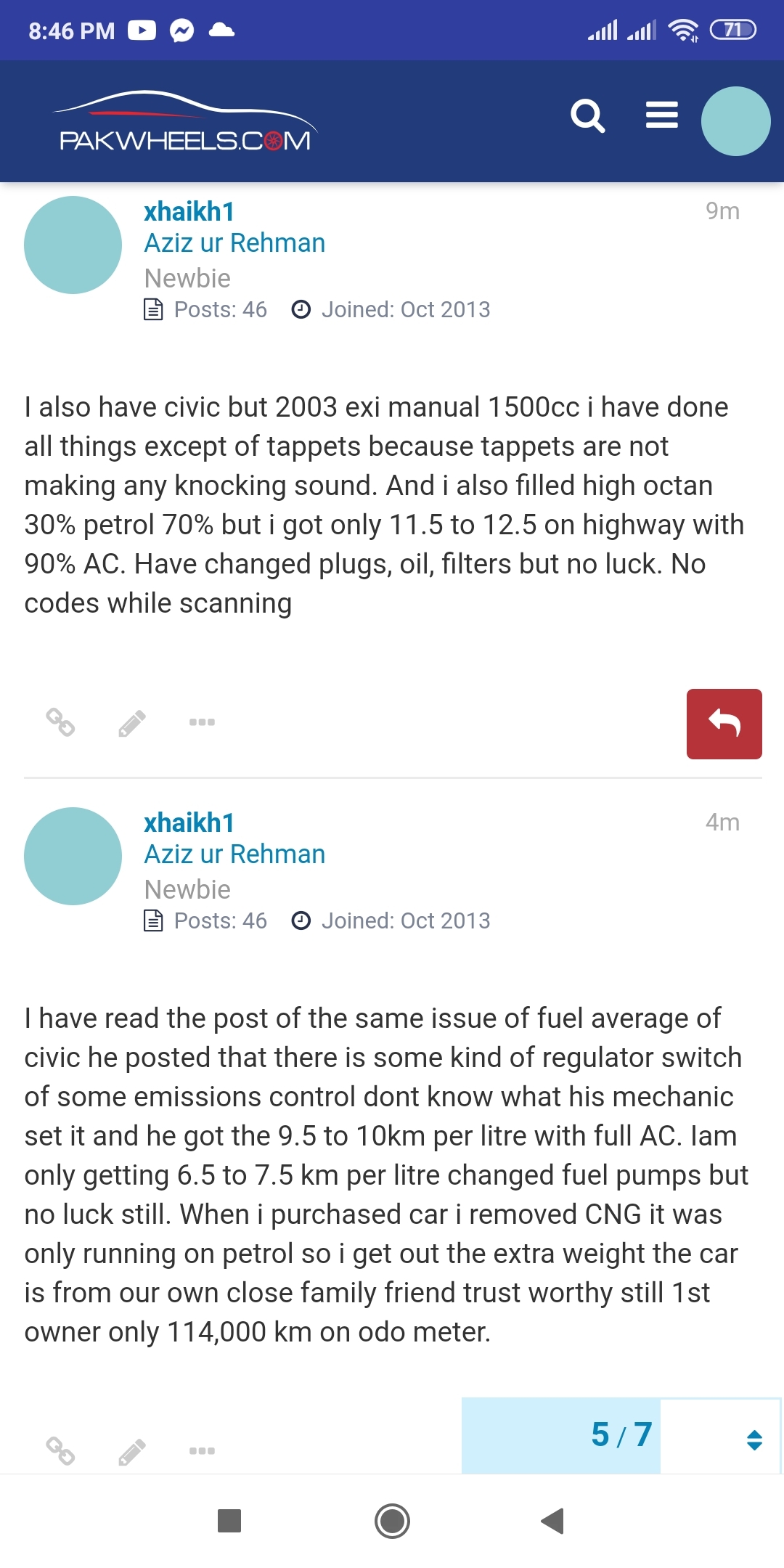

- High octane 15 litre and petrol 24 litre poured while driving at highway but got 11 to 12km per litre only.
- After driving plugs are orange or rusty orange color which means its running perfect but no good mileage. No fuel leakage found from any where fuel filter also cleaned
- Tires are also stock 185/65/14 wheel caps no alloys.
Now what things should be done to achieve th good mileage and what are averages of these exi manuals.

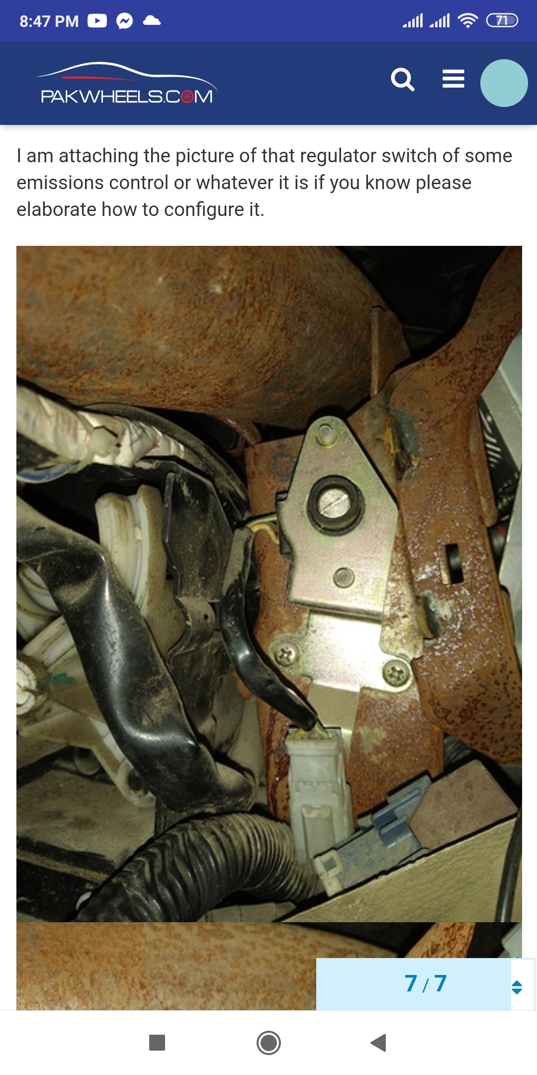

I have read somewhere that there some sort of regulator or cicular switch to maintain any emissions or what dont know much about it.
