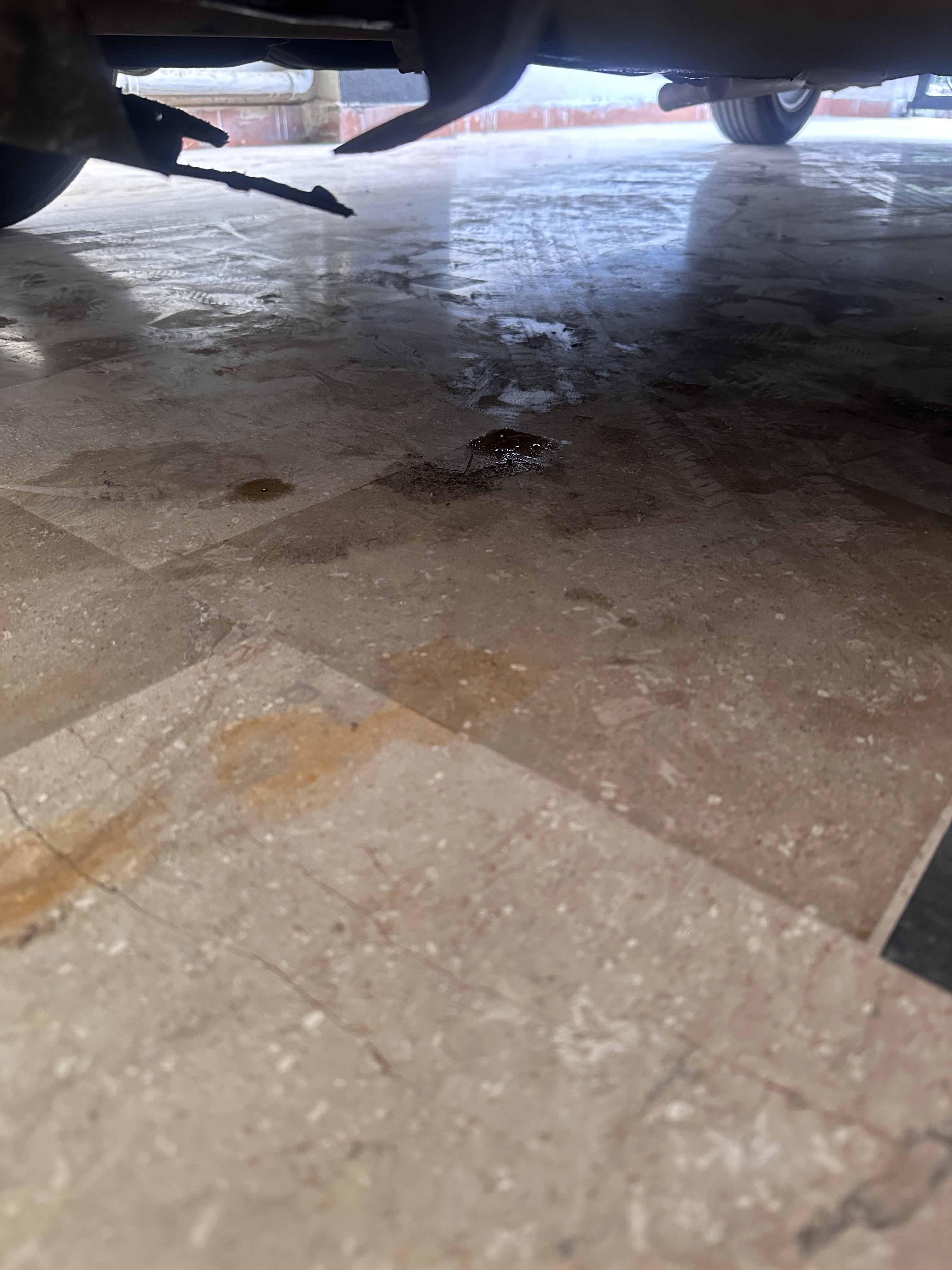

3) are minor leakages in these old engines normal?(Attaching a picture)Uploading... Uploading... By minor I mean that I don't notice much oil reduction or anythig, rather it's one or two drops on the floor
a) I recently got the tappet cover gasket (jang) changed, since that was something that concerned me, what else could be the culprit here and how should I investigate..if I shouldn't..who'd be the right honda guy for this in twin cities

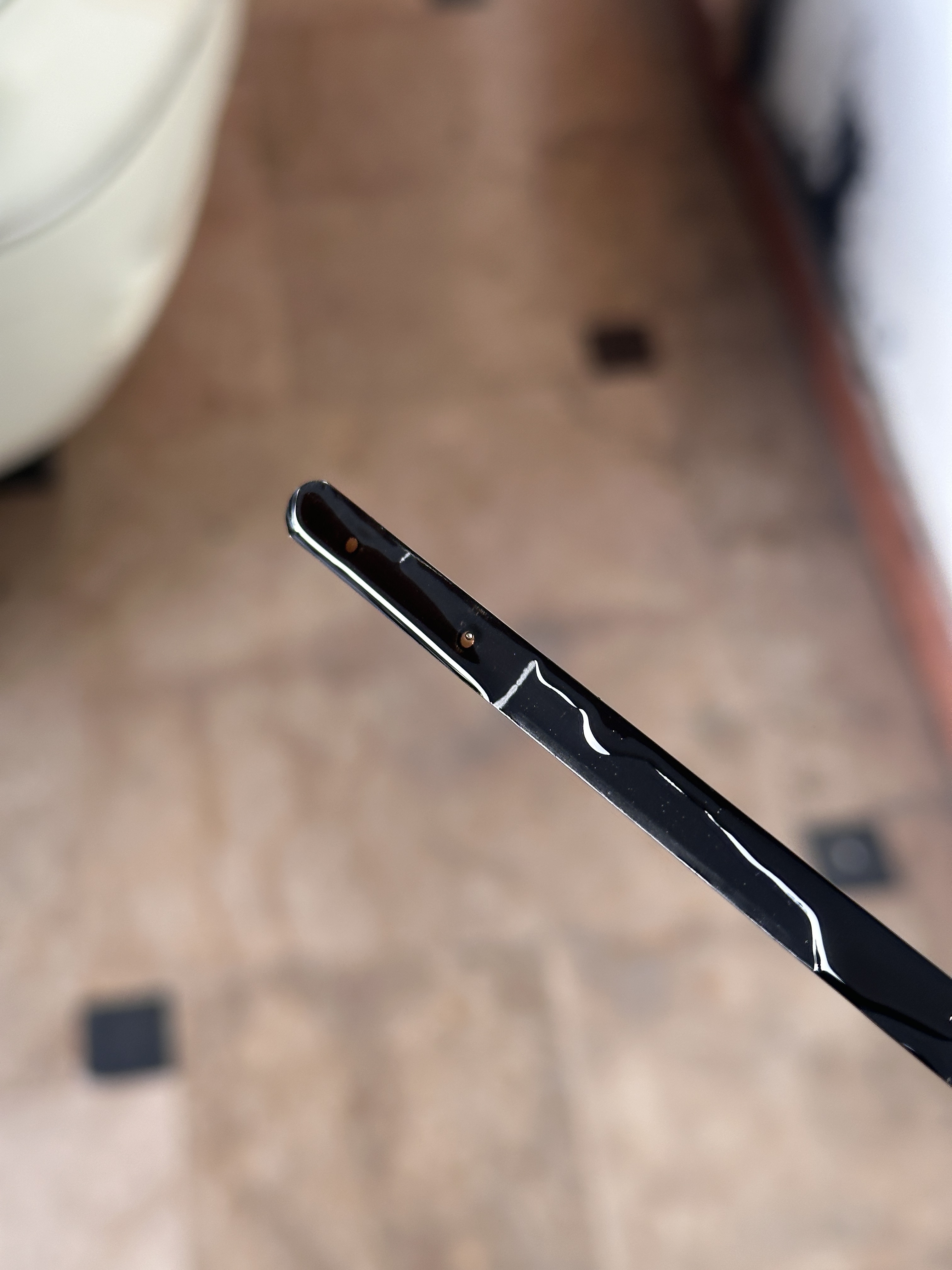

To that end, I've noticed that after my recent oil change (the mechanic put in 20w50 3.6 - 3.7 litres shell oil in the car)
The dip stick seems to show a really high level of oil in the car compared to the high low points that are generally there on the dipstick, is it possible that the previous owner or mechanic has been using a dipstick that is not meant for this engine type? (Attaching a picture)
Also..does this engine need 20w50 really or is supposed to run on thinner oil...
