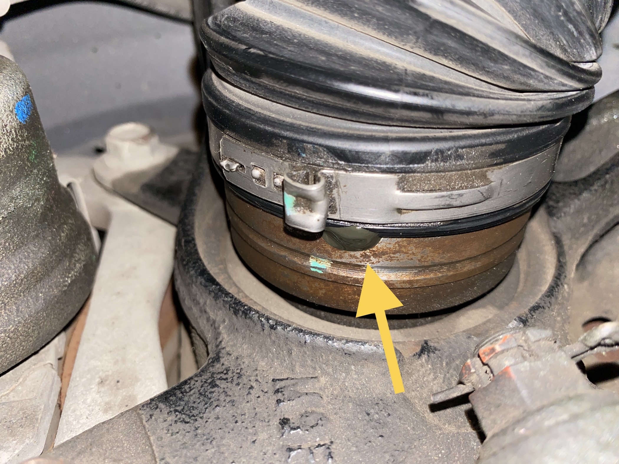

my Civic’s front outer axle boot is leaking liquified grease.

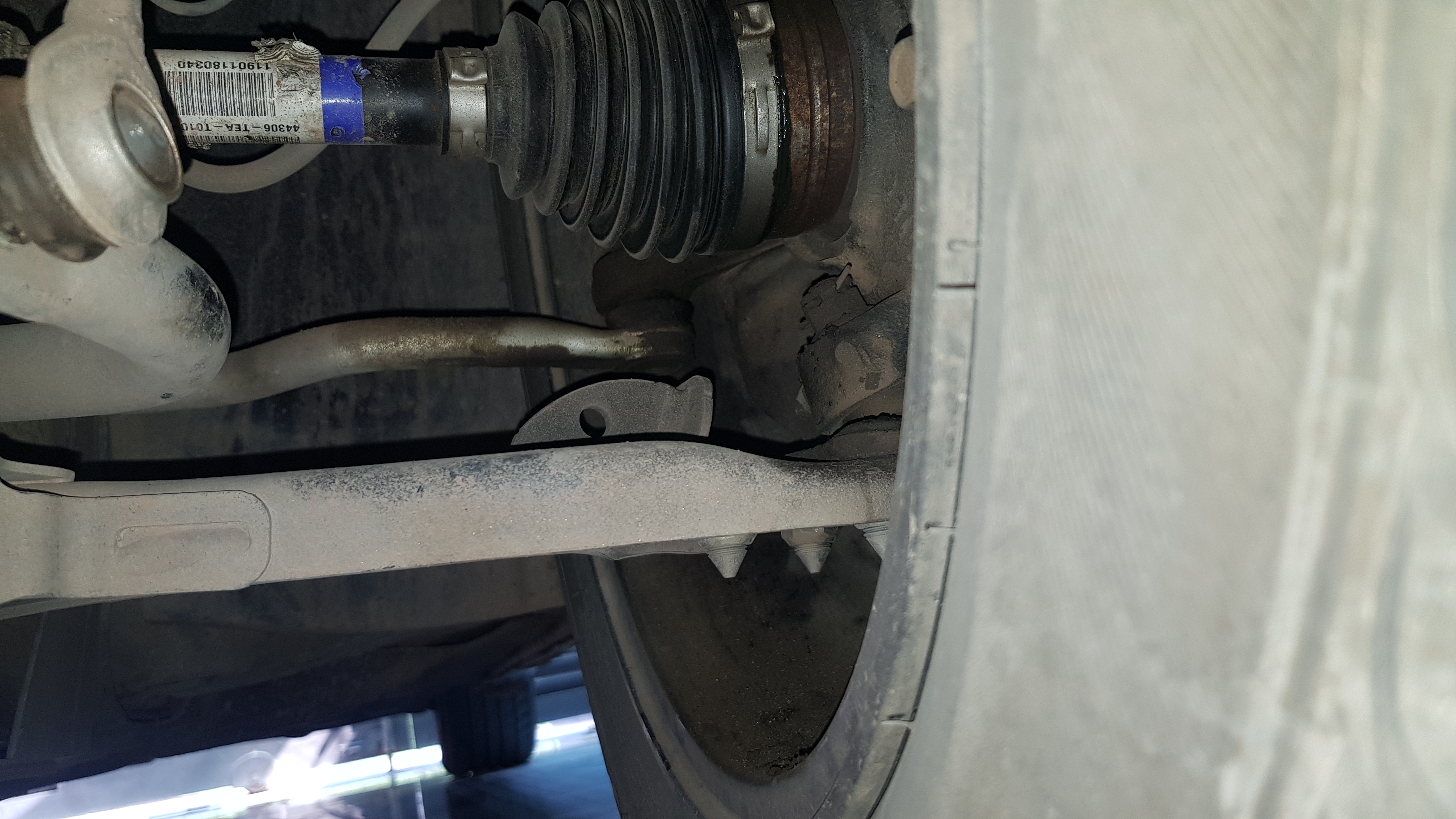

the first time, i saw some grease on my RHS front rim and it was all spread out on the inner side of the rim plus on the knuckle as well.
went to nearest workshop and upon inspection found out that it is the axle boot which is leaking.
cleaned up all the mess
drove it for 2 kms
came back to the workshop and it was again leaking
these are the pictures of the leak after cleaning:
I thoroughly checked the boot and the boot clamp as well, there are no signs of damage/puncture on the boot and clamp is also looking good and intact.
It is leaking from where the boot clamp sits on the boot and the leak is only from one spot which is shown in the picture.
Is it the boot which is failing or the clamp? The leak is not temporary and leaks a bit of grease every time i drive the vehicle. Please help !
