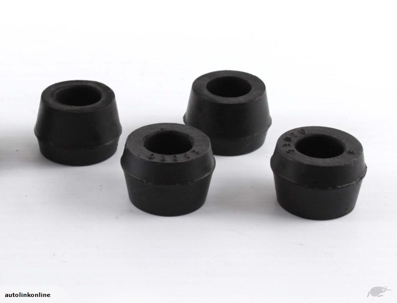

mine are this type of shocks which portion should be tightened first upper or lower?

then please check both upper & lower.check lower closely they may be bolted with extra torque fracuturing the rubber bushes

there shall be no fractures in rubber and the bearing shall be hard seated wiggling bearing means end of life, these mounts can be sourced from scarp after close inspection.
