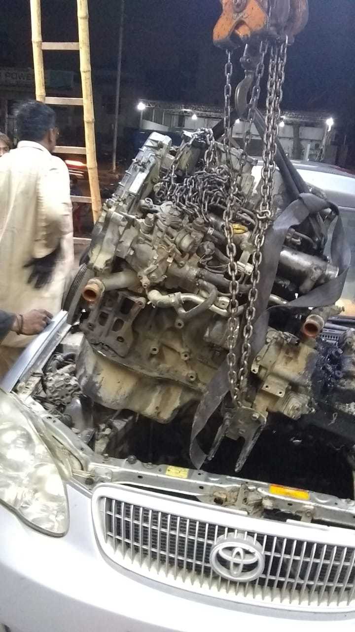

good that you choose to rebuilt the engine. please note following points & insist upon the workshop to do as you are asking before they rig engine into the ride and start it.
- thermostat valve is in the cooling system
- coolant is used in radiator
- cooling fans are running on auto
- fuel filter is genuine brand new
note down the meter reading before you take the delivery of car after rebuild .
change engine oil & oil filter at 1500 kms
- afterwards make sure to change the engine oil every 5000 kms,
please note there is difference between oil change & adding oil ( top up )
engine oil & oil filter are key elements for engine life, if you follow the maintenance it will be trouble free smoke less at light foot for another 150,000 kms of service
diesel engines have torque which give great momentum & acceleration
never expect - goli ki tarha nikalay - acceleration
over long run it can smoke any petrol driven vehicle of 2000 cc class.
Good luck
