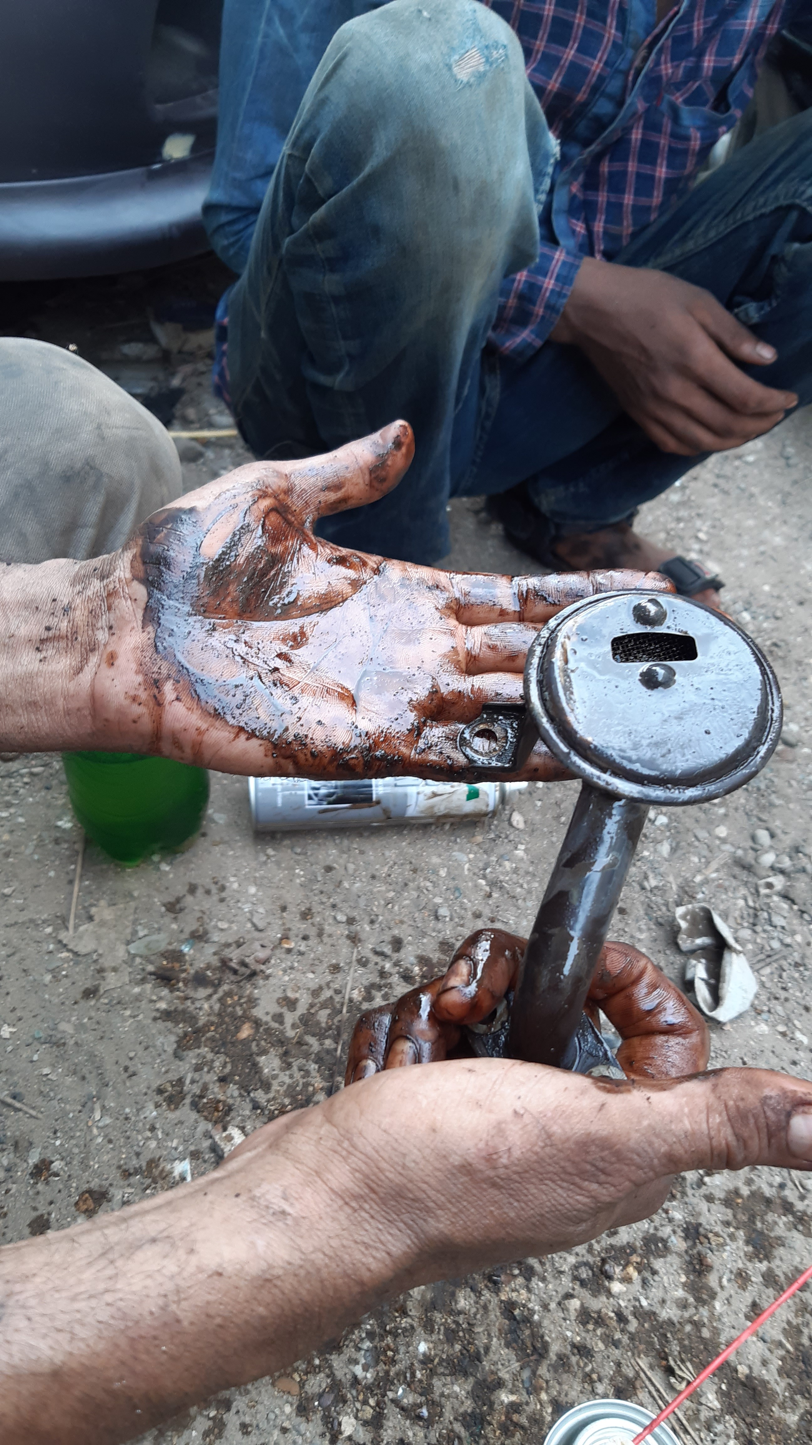

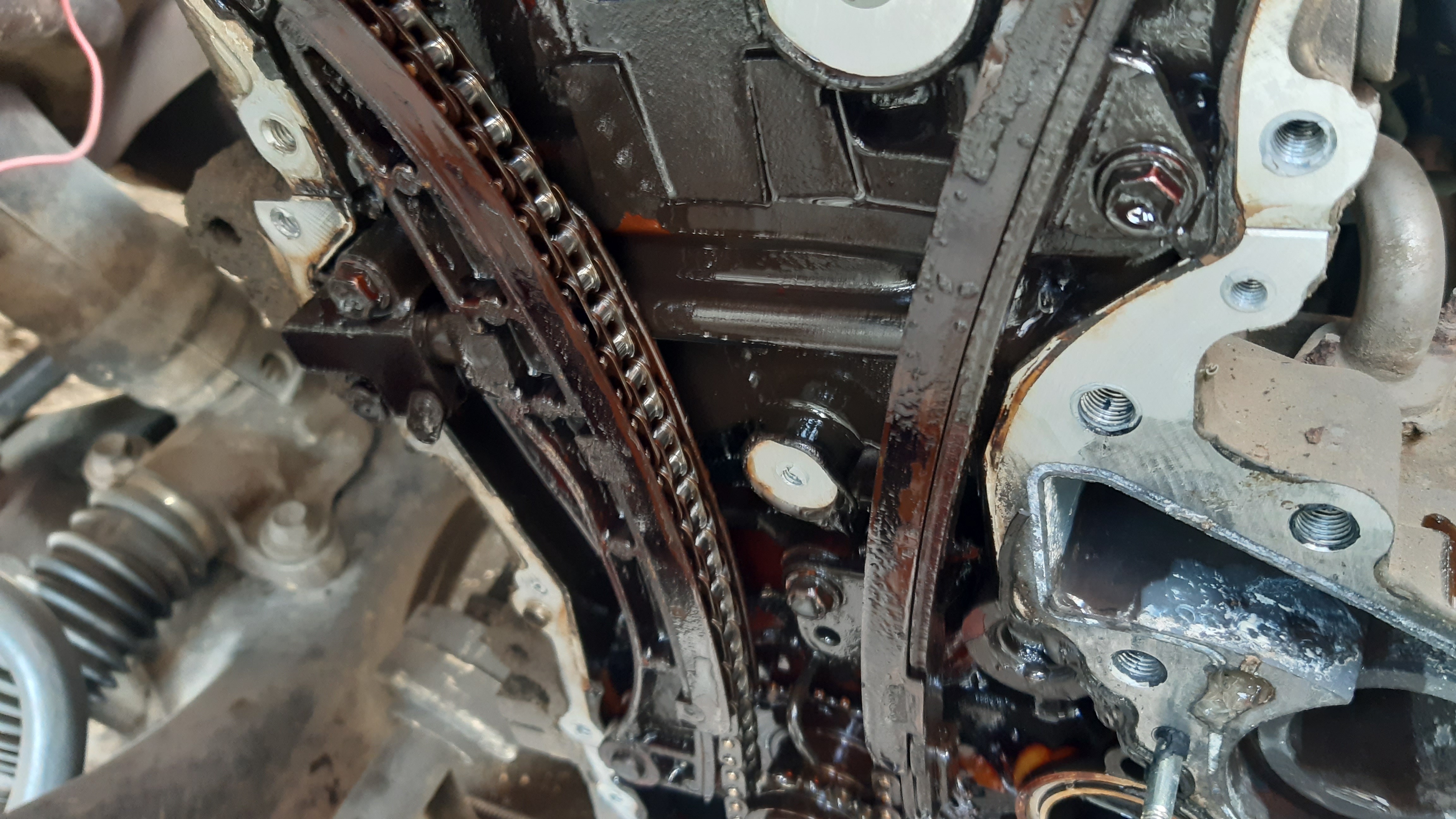

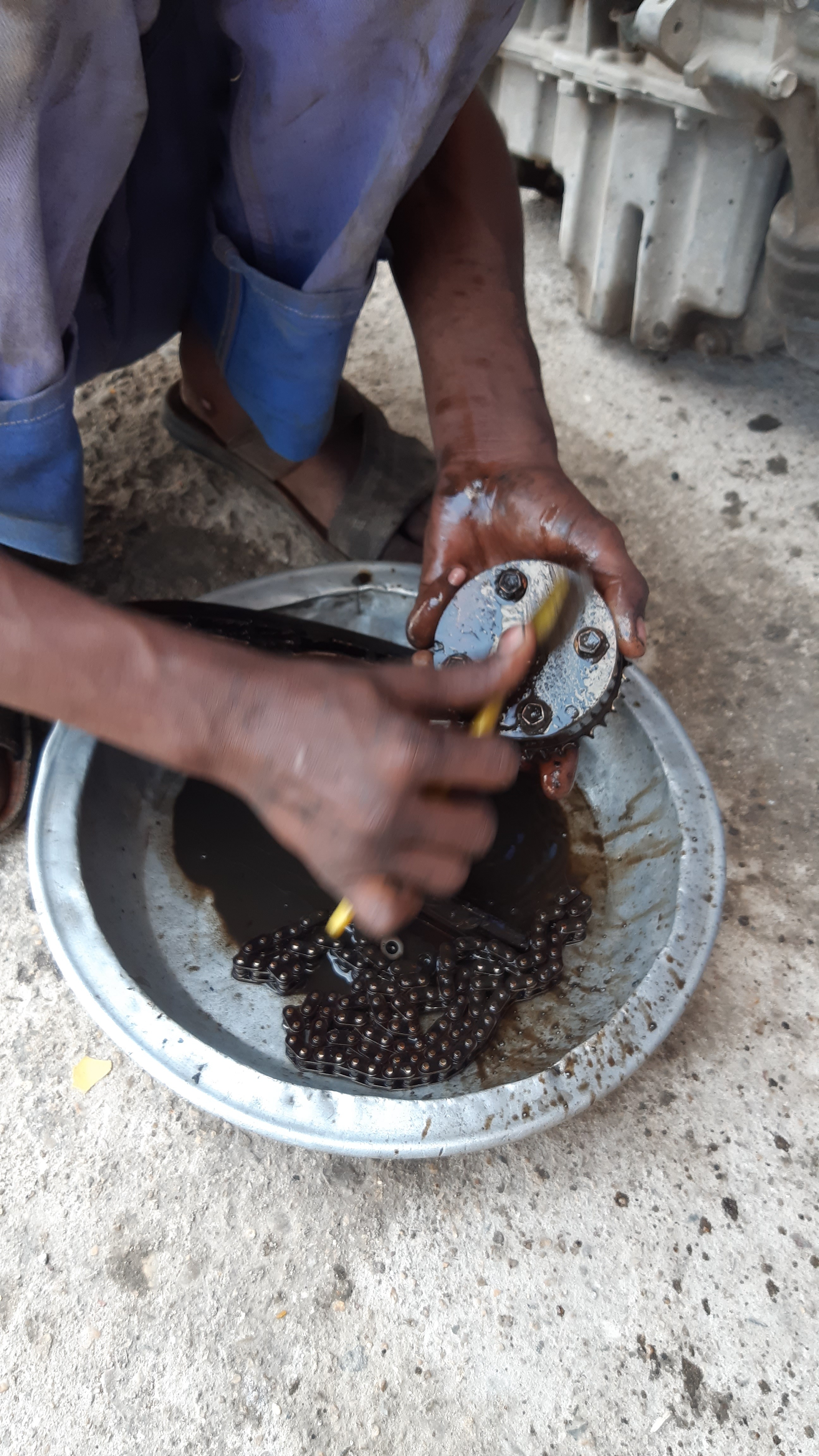

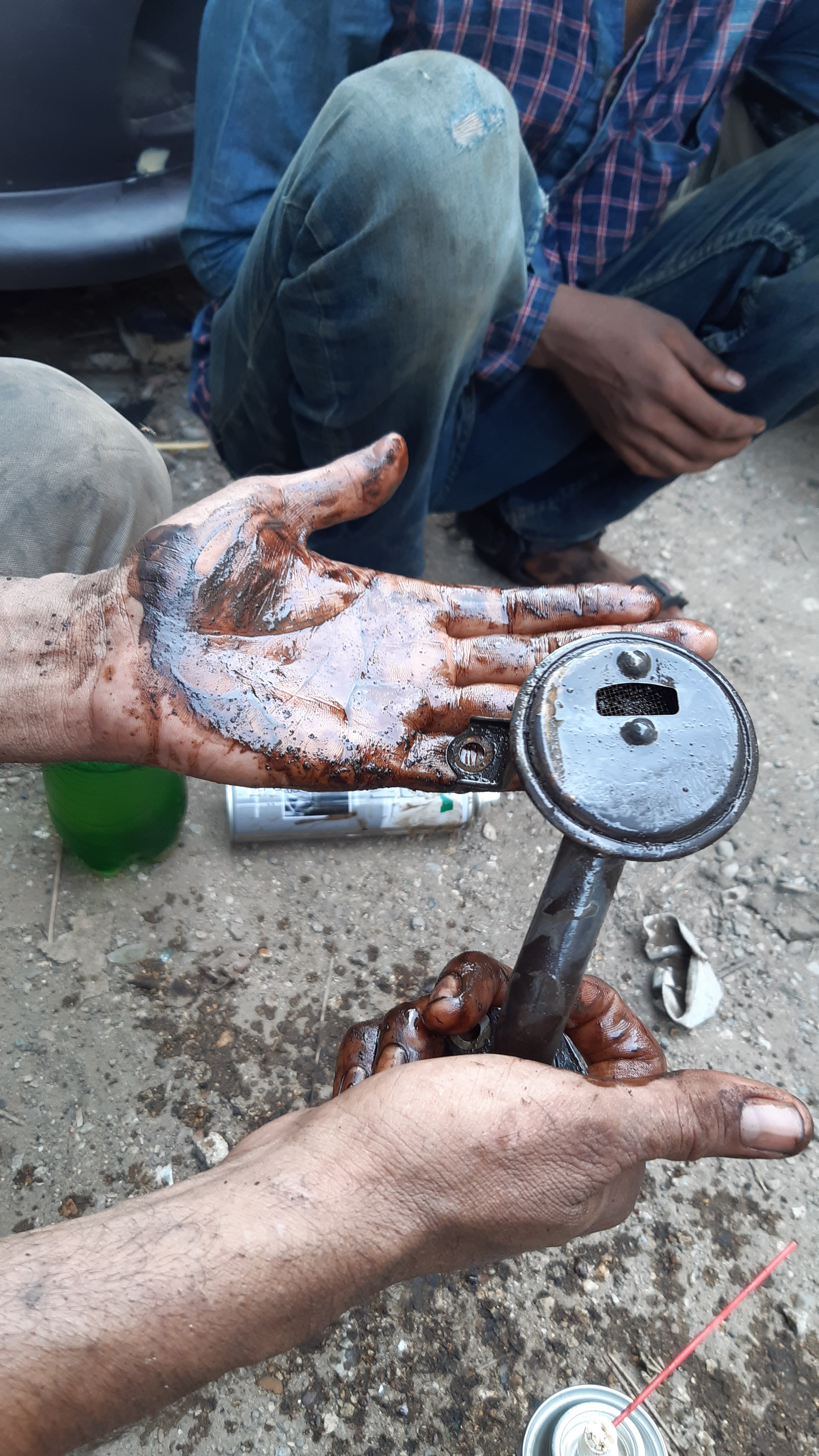

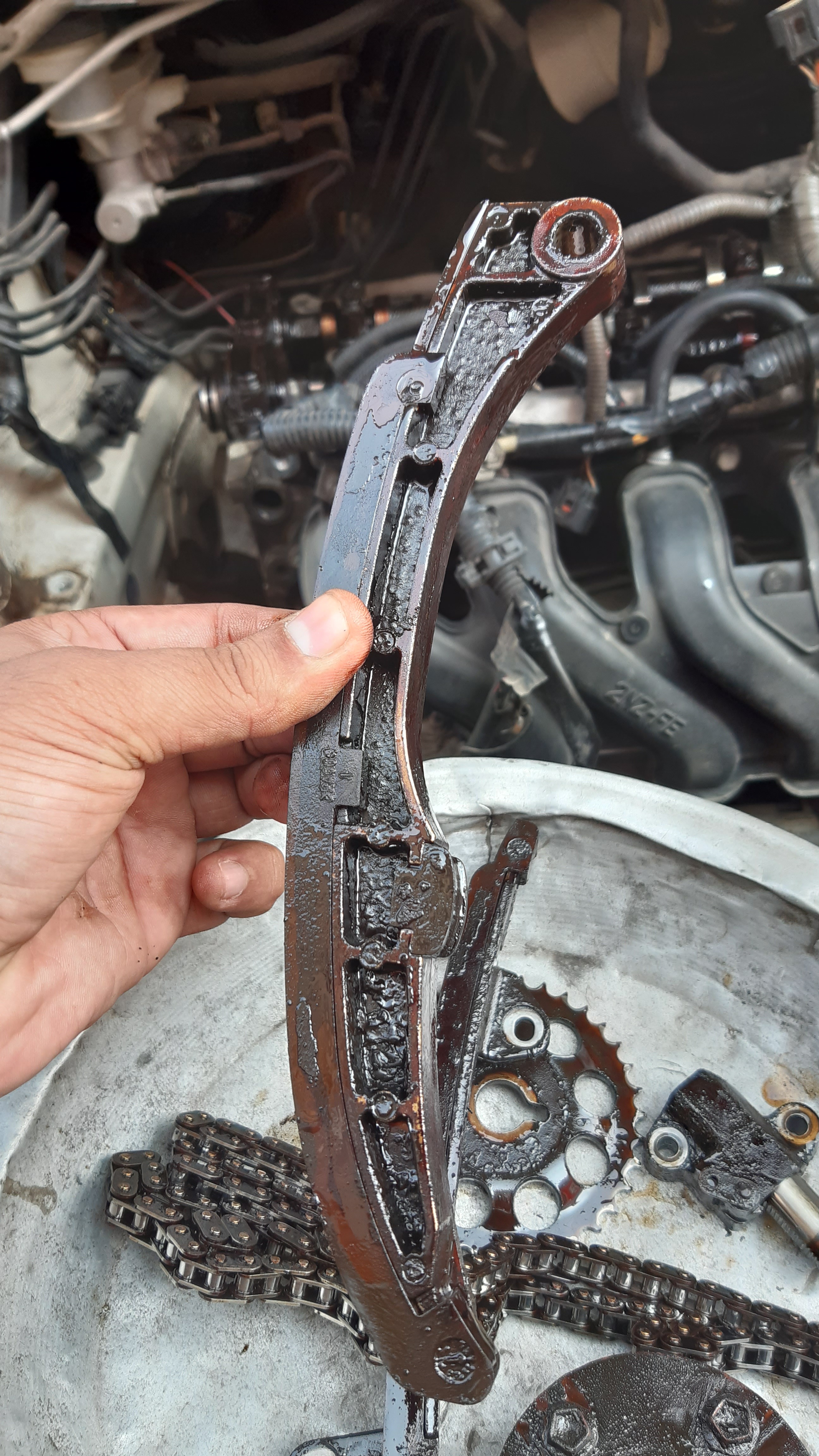

i have 2nzfe Corolla, 90k Driven, When i start car i hear kar kar kar kar kar sound for 1 second and then it vanished.
I have another car with same engine but its 70k Driven, it dont have any such sound like this.
now i showed to one mechanic today, he said k iska neechay c camber khol k oil pump jaha c suck karta hai wo saaf karenge then Wapisi oil Fill karenge q k he said oil slow uth rha hai wahan kachra jama hone ki wajah se or crank pe slow jata hai ! What he said this to me .
He told me it will cost 2000 rs for this service excluding oil and oil filter
Now suggest k porana Oil hi Daldun wapisi ya new Dalun, Porana oil 200 KM chala hai bus its 10w40.
