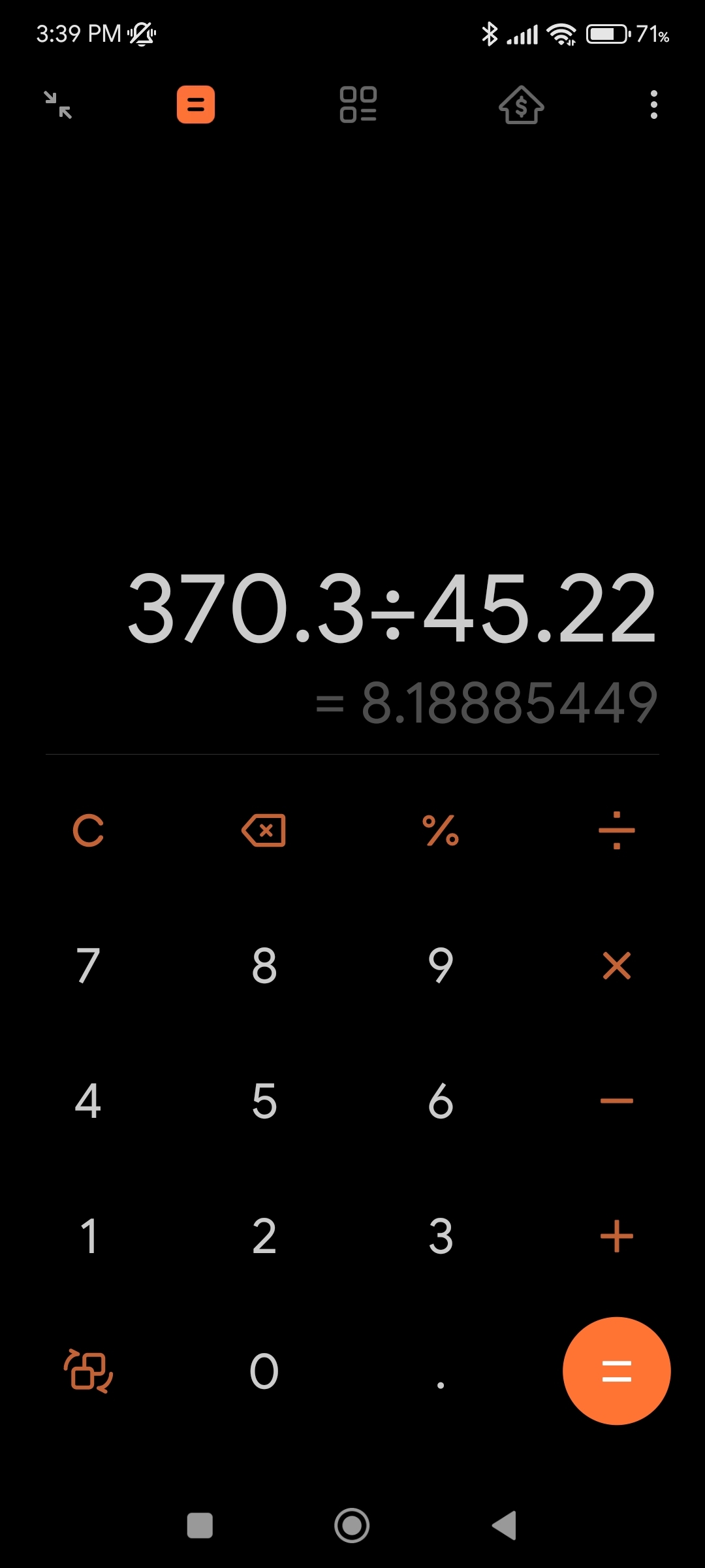

Why? Its not the average this engine should return
This time average is less. Also the liters shown in image is more because auto cut wasn't working at this PSO pump besides Serena Mobile Market at Sakhi Hasan, Karachi. So I deducted 1 liter and get 8.18 Km/l which is very bad for this engine.

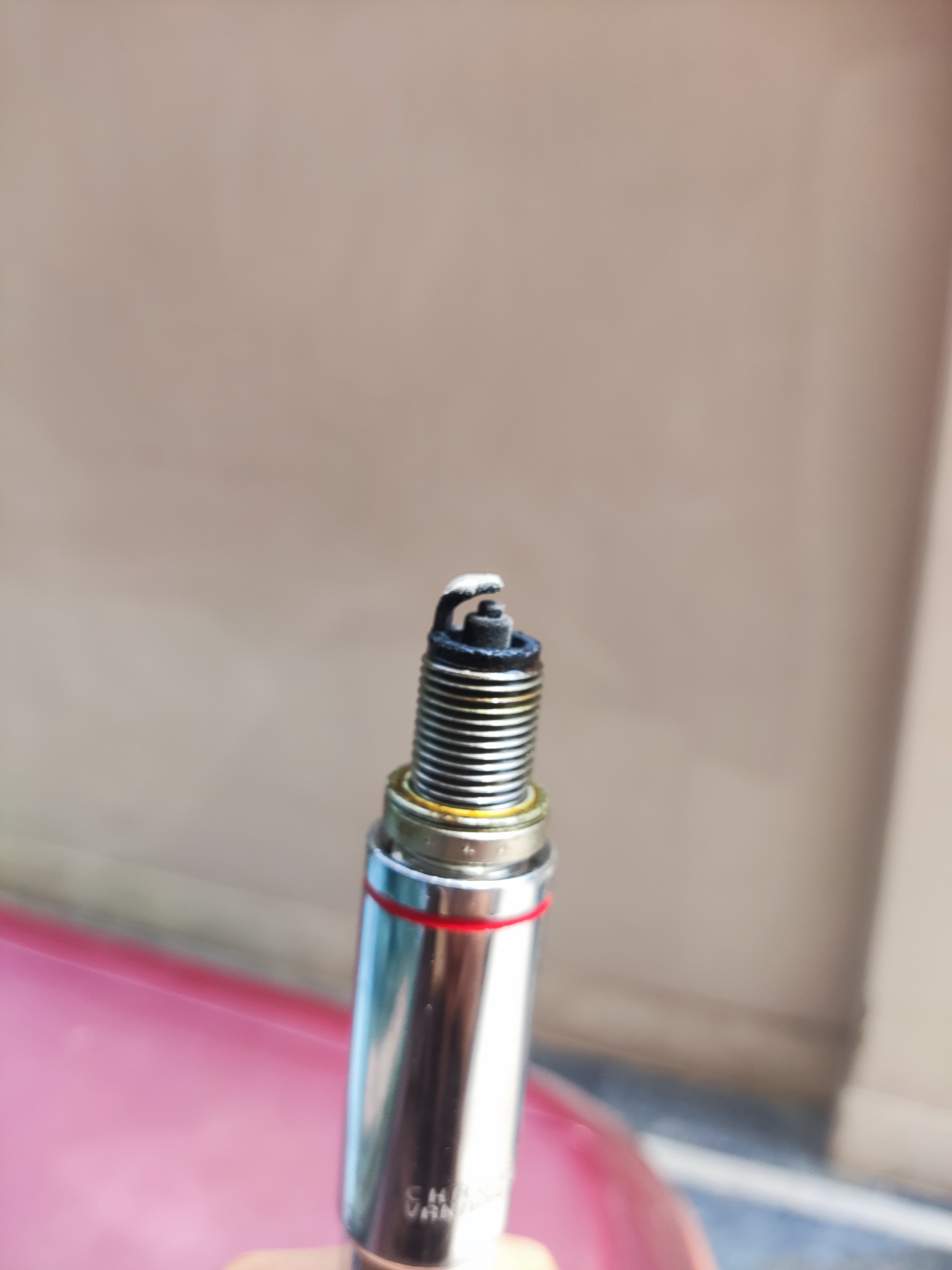

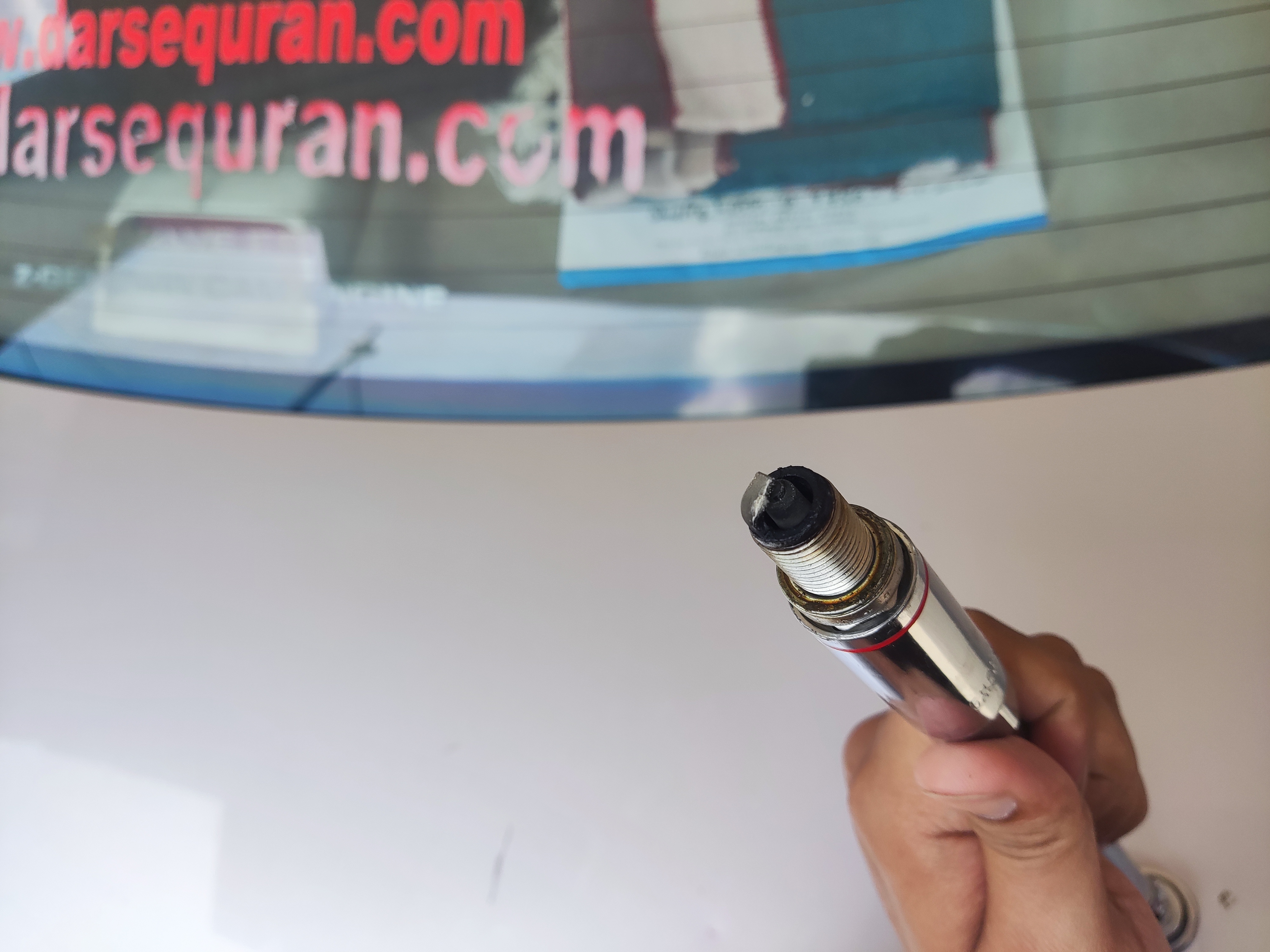

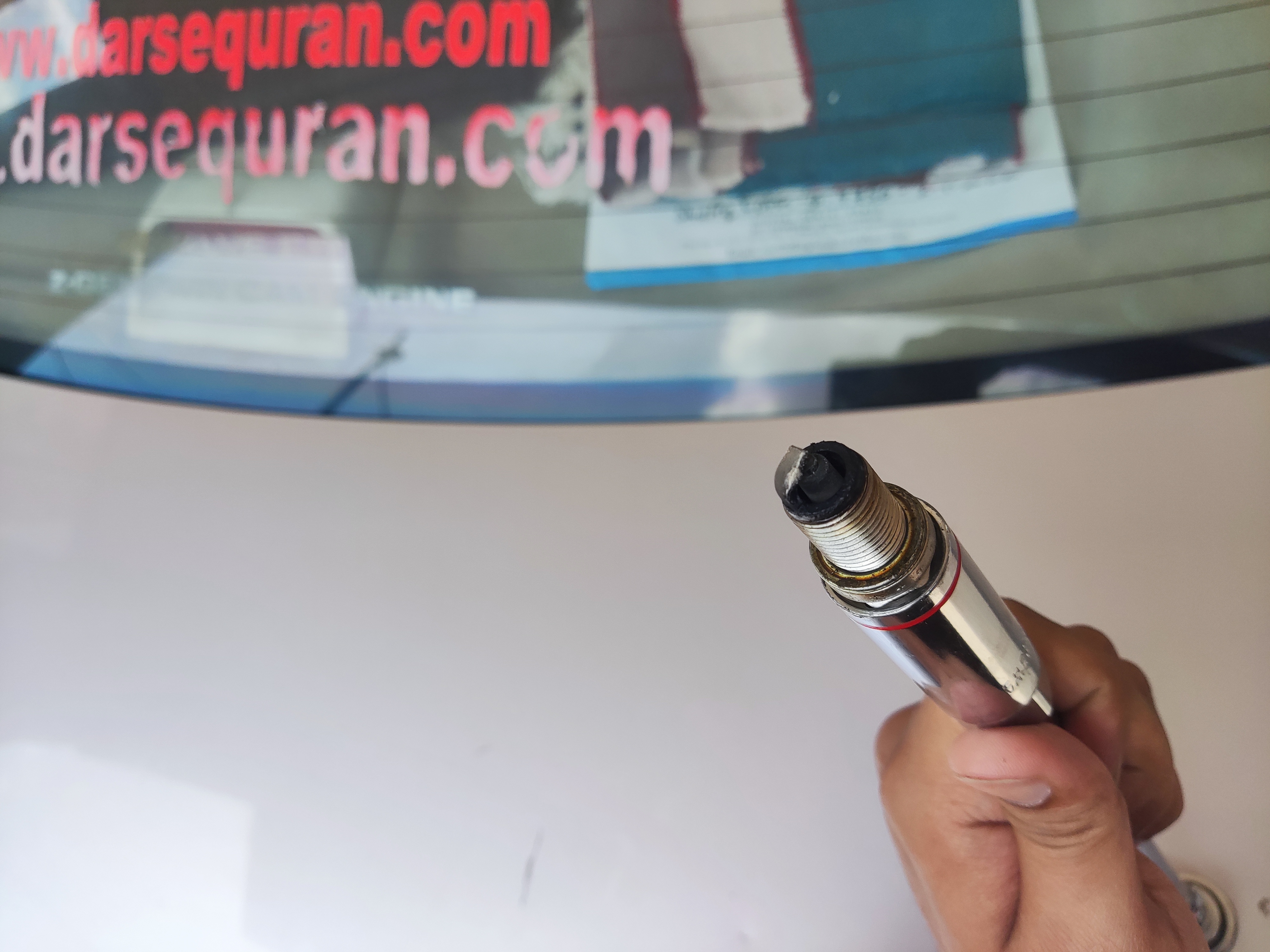

Replaced spark plug with iridium VK-16 (Best available in market)

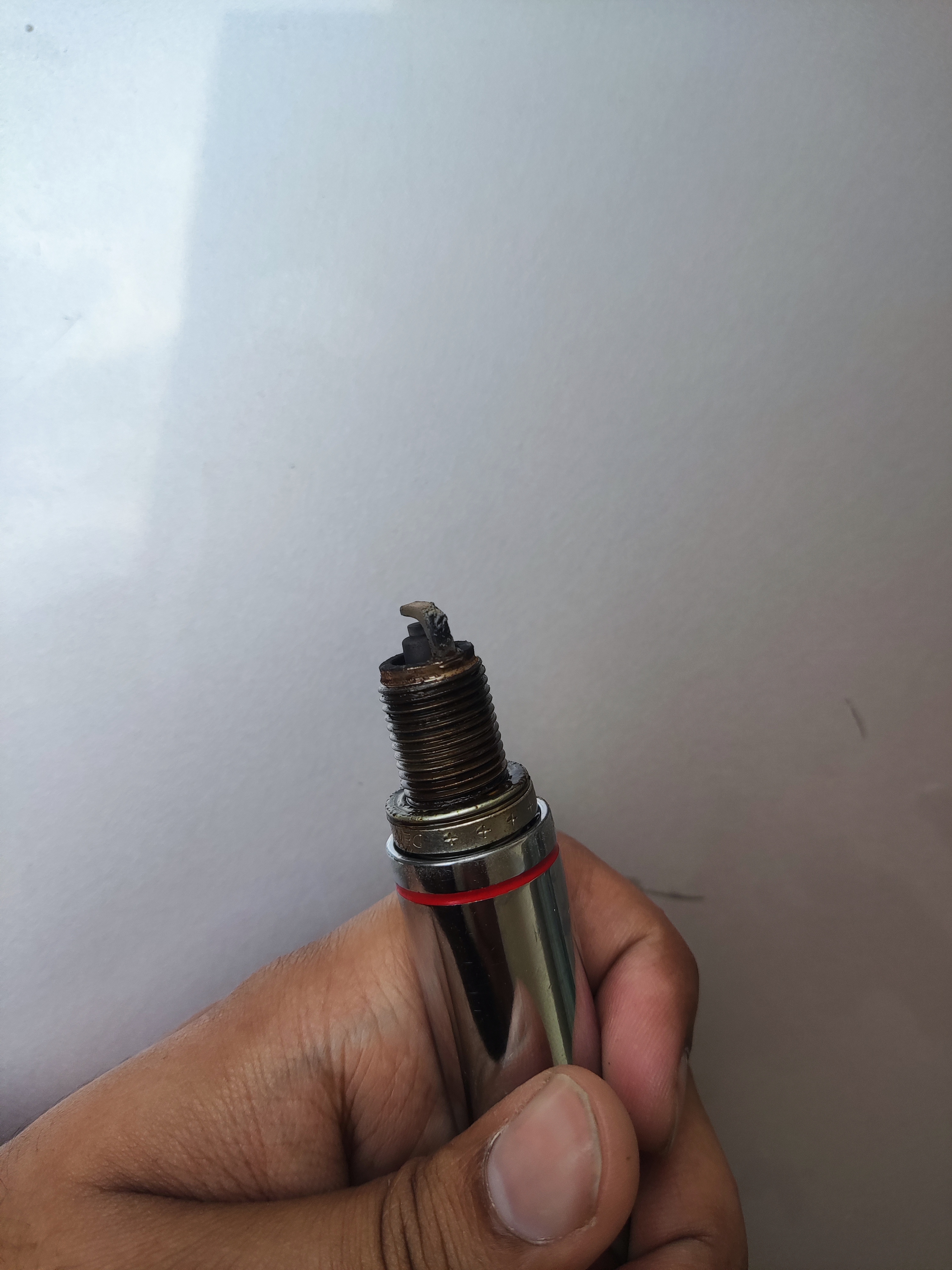

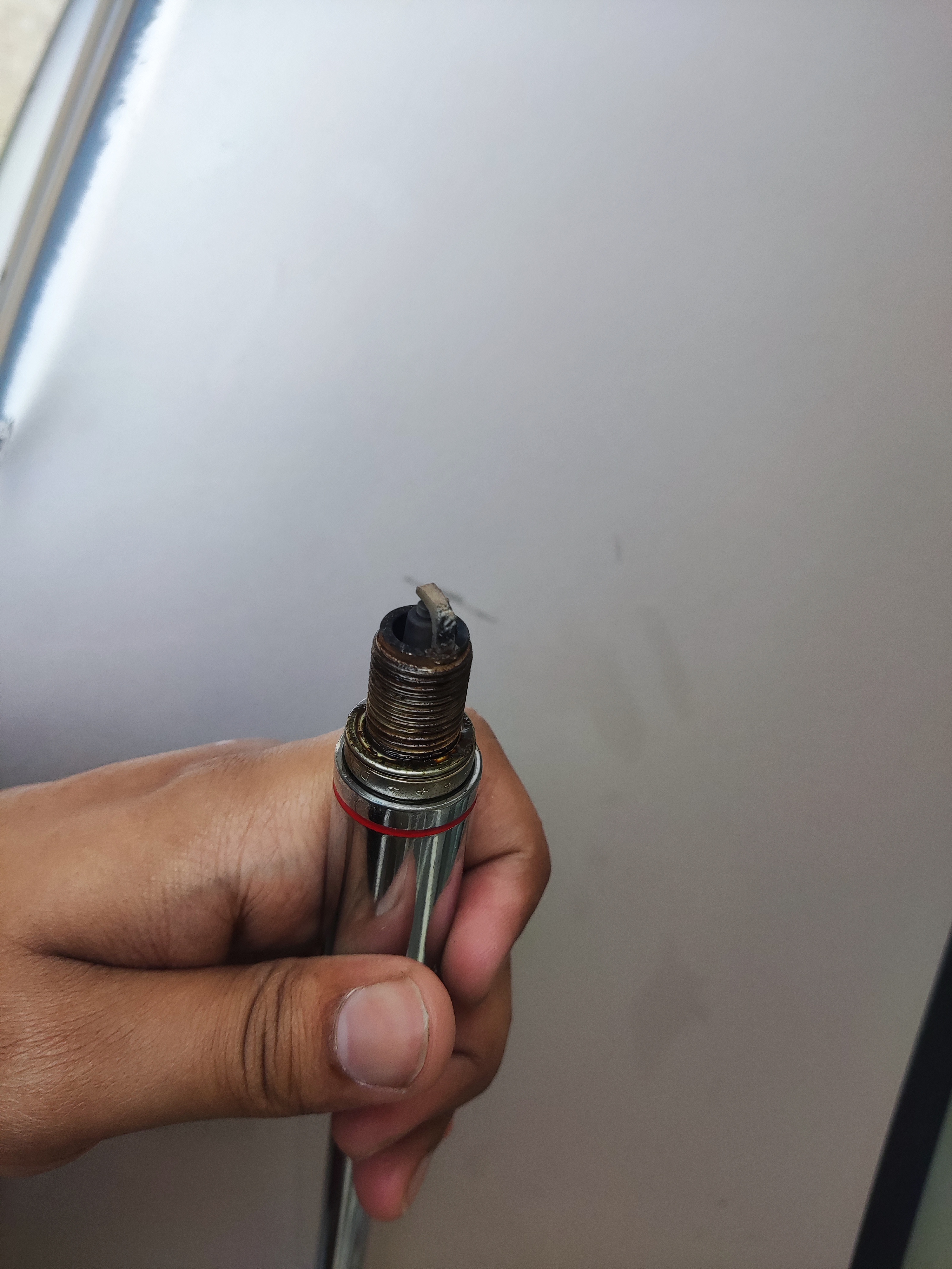

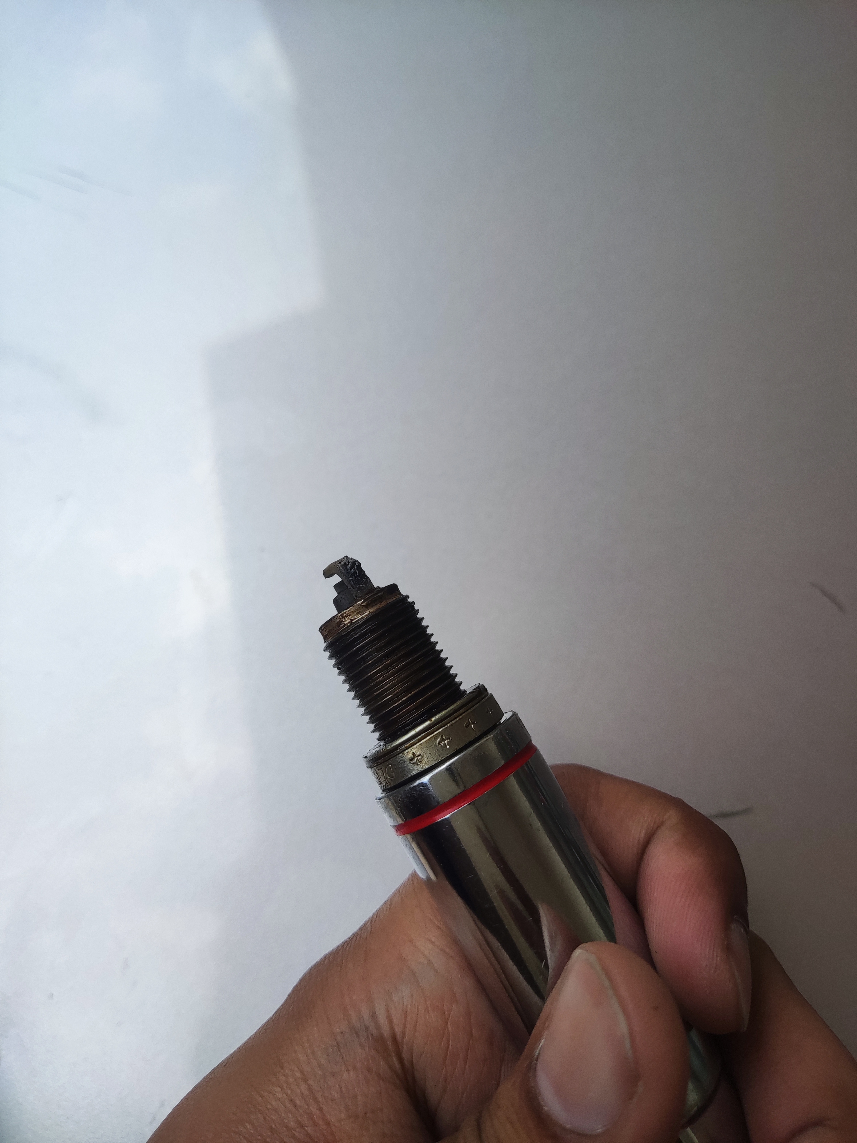

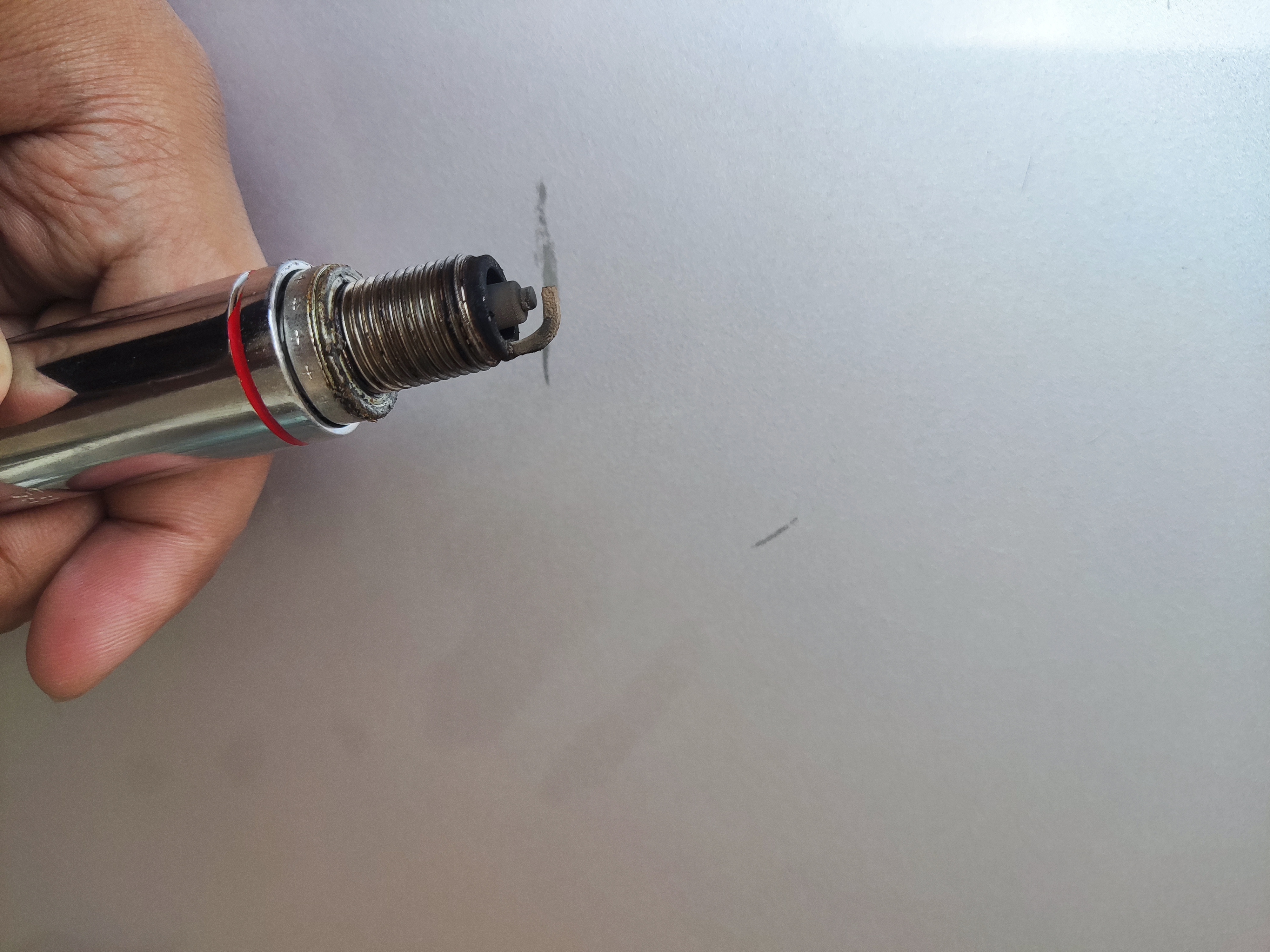

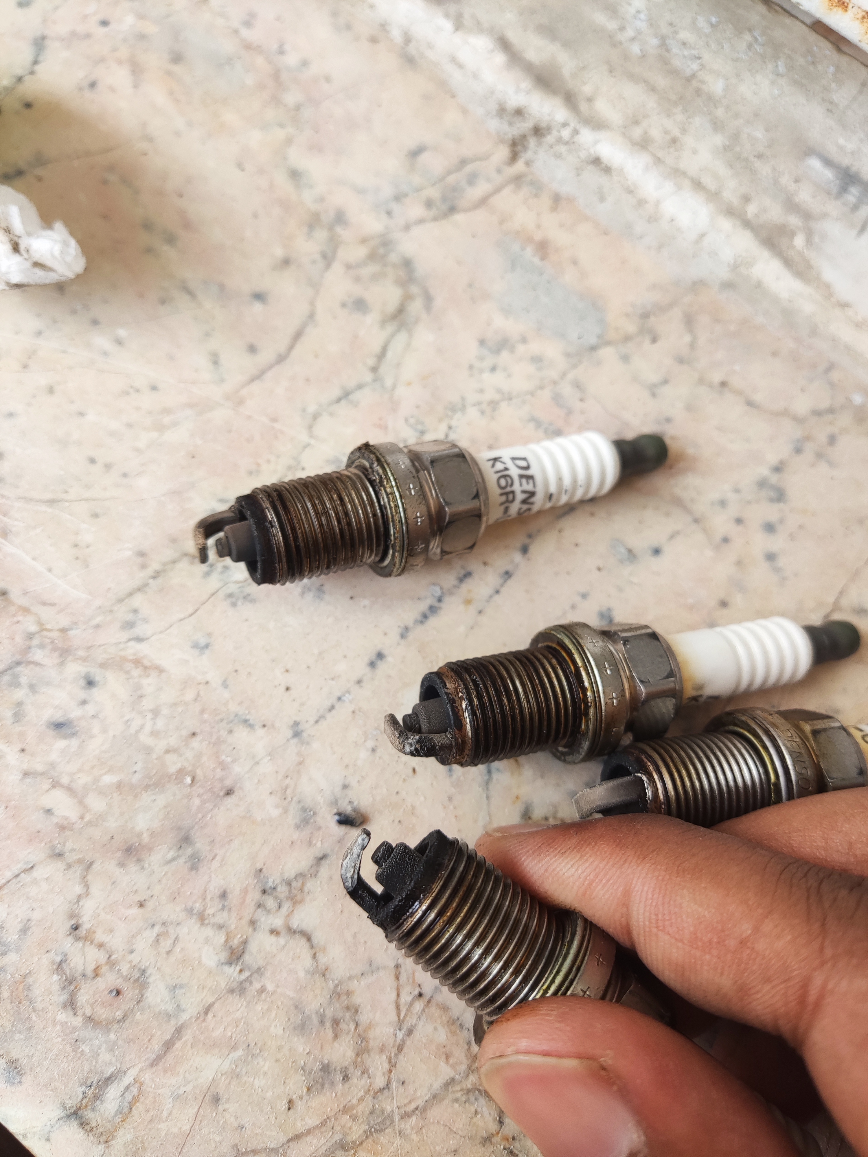

What does these spark plugs shows? Also the ground electrode seems to be deteriorated like it is melting.
@Xulfiqar @Hassan1991 @capsat @dayrider @engnr.mubashir @dani_kk
@hasankhurshid29 After looking at plugs they gave gone through 2 scenarios. 1) Car was running too rich for quite long time. 2) Later the car running too lean because that white residue on top electrode indicates running hot and that too leaning of mixture.
Problem could be too less fuel to the system that cause lean conditions and there are less chances of getting lean codes until you have some serious vacuum leaks.
So is this new pump not providing enough fuel pressure?
Looks like uneven atomisation.
for ideal air fuel mixture the plugs should be brownish in color. check your cars fuel and air intake and figure out systematically what is wrong. In this way you can solve the high fuel consumption issue as well.
Already checking both systems.Will get AFR reading again from Torque Garage
