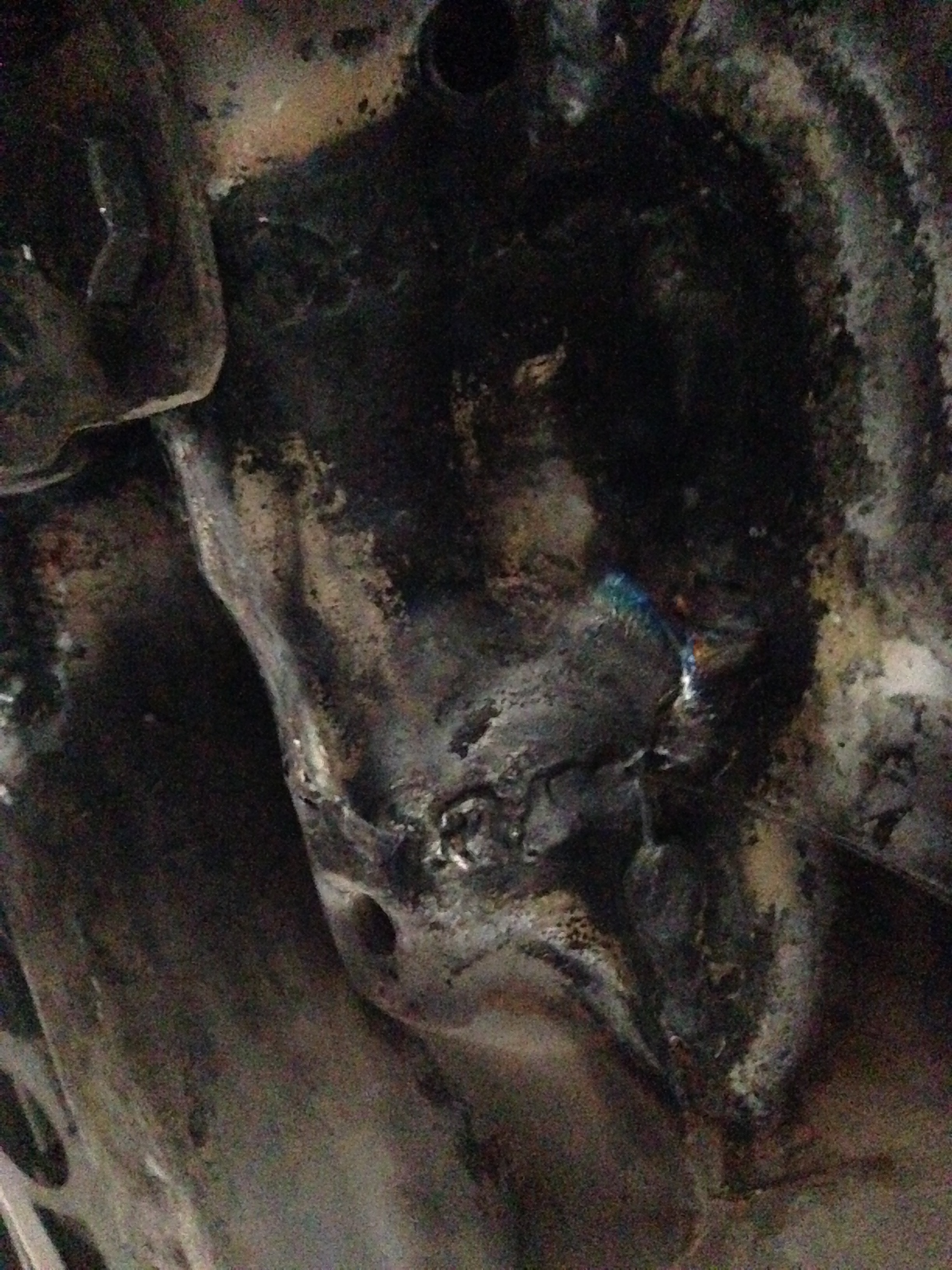

I have got problem in my recently purchased cultus model 2009 EFI, 104000kms driven. Problem is that when i accelerate my car it moves to right a bit and when i release accelerator it moves to left. It also happens on gear shifting from 3rd gear to 4rth n 4rth to fifth. Now i have found the reason of this problem. There is crack in frame beneath the car where Chimta is attached with frame. Welding of frame is done but after 3 days it starts to crack again. Now please tell me permanent solution of this.

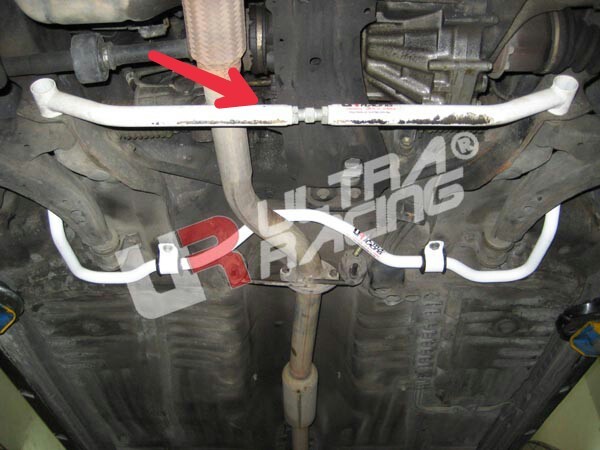

Alignment guy told me to weld a rod (Chikh) beneath the car , is this a good idea ???
Tyres are new.Tyre Pressure is 30Psi in all. Wheel alignment done. Steering assembly serviced. Replaced chimtey & ends with new, Goda work done but still issue remains. Alignment guy told me that this is due to frame crack as frame doesn't remains in one position
I am worried Please Help
