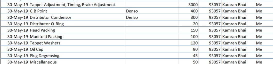

The car is in operational condition at the moment and can be taken anywhere. It's just that I am bogged down after observing the oil in radiator and I think my mechanic used gasket sealer instead of new gasket to save 400 rupees this time. I know that if there is a minor gasket leak, it can turn into a major expense really soon it I dont take action.
I asked him multiple times, including telling him my father is quite angry (20 year old customer), but he keeps on giving lame excuses. He sent the carburetor to get the slow line unchoked although the real problem was gasket leak after all. So he started on the gasket without asking us. The next day I found my car's engine all opened up. If it was another mechanic, I would not have tolerated, but he really came through for my grandfather and then my father on some tough situations which is why I am giving him a little respect. So, as for the reason why gasket leak happened again, I can find no other reason other than the fact that it was a lousy job.

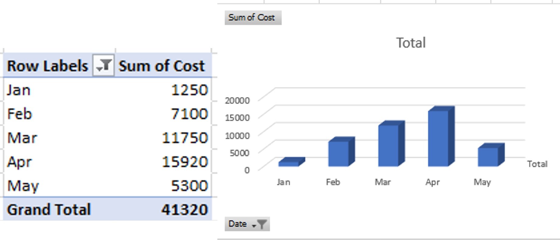

As for the 40,000 rupees, the majority was spent on brake restoration, radiator and cooling system restoration, tyres, and fluids. Honestly speaking, I can feel the difference in driving, which is making me more attached to the car. The car hasnt skidded once after proper brake replacement job.
