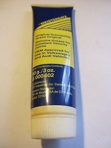

all were super - if you can find the VW tubes of meisersatz branded axle grease - its also got lead in it - LOL - forever reliable axle - its considered a biohazard now globally. - its so tenacious that once a cloth gets dirty from it, you cannot ever clean it.
There are shops in plaza that just deal in axles, they can sell you the little accordion tubes of grease which comes with NTN joints, its also acceptable.
