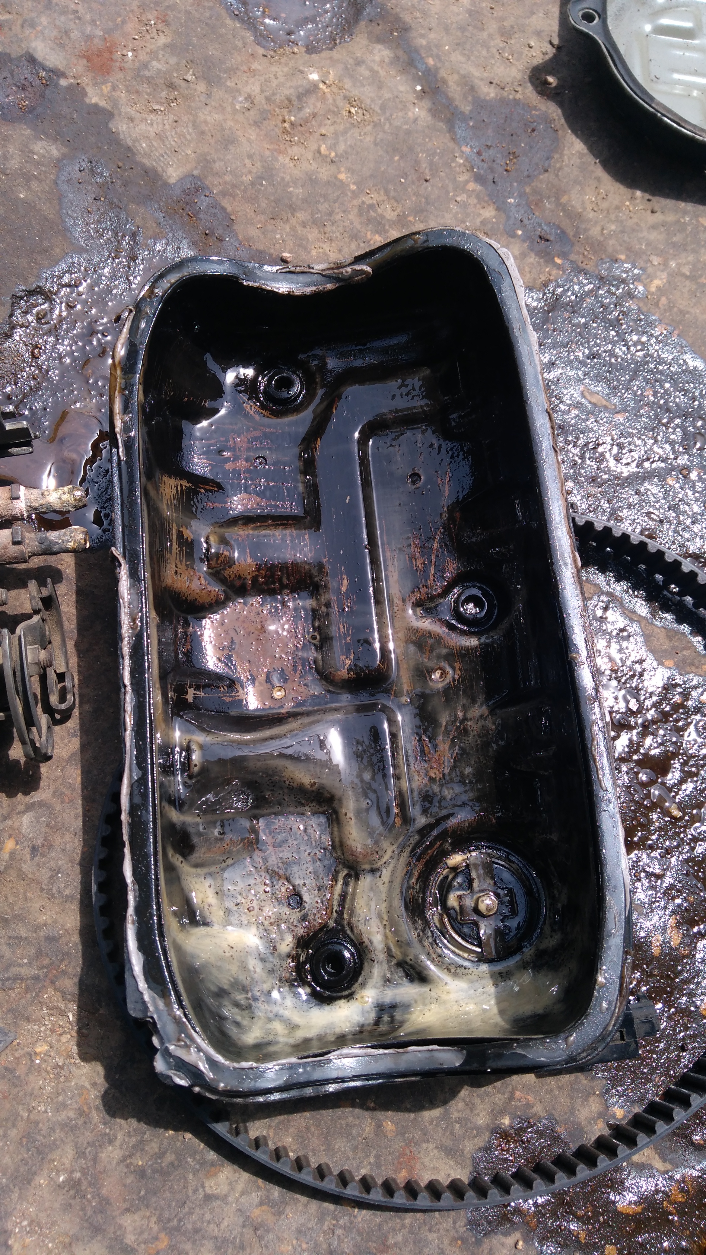

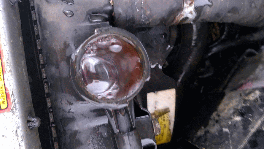

This picture is when the gasket had a leak (2nd time) this time it's fully blown with white smoke and what not
