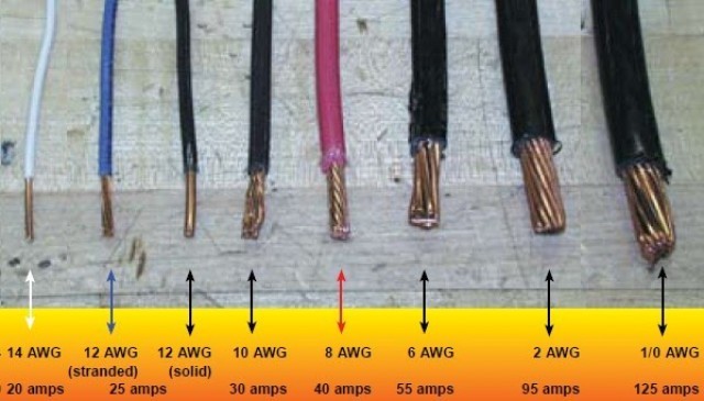

Here is Pakistan you will find wire strength calculated in "mm" (millimeter) where as in America they use AWG (american wiring guage).
Usual connection here are done with 4mm-6mm thick wire, with thicker wires for ground, battery and generator connection, starter motor etc and 10-12mm (0 AWG). but the "Electirician" should better understand. there should not be any short cuts and breakages and joints in between connection and every damn thing must have a fuse from the fuse box no direct setup and with experience i am saying a "Battery Cutoff Switch". Installed it in my Lancer after restoration and installed it in my Khyber too.
