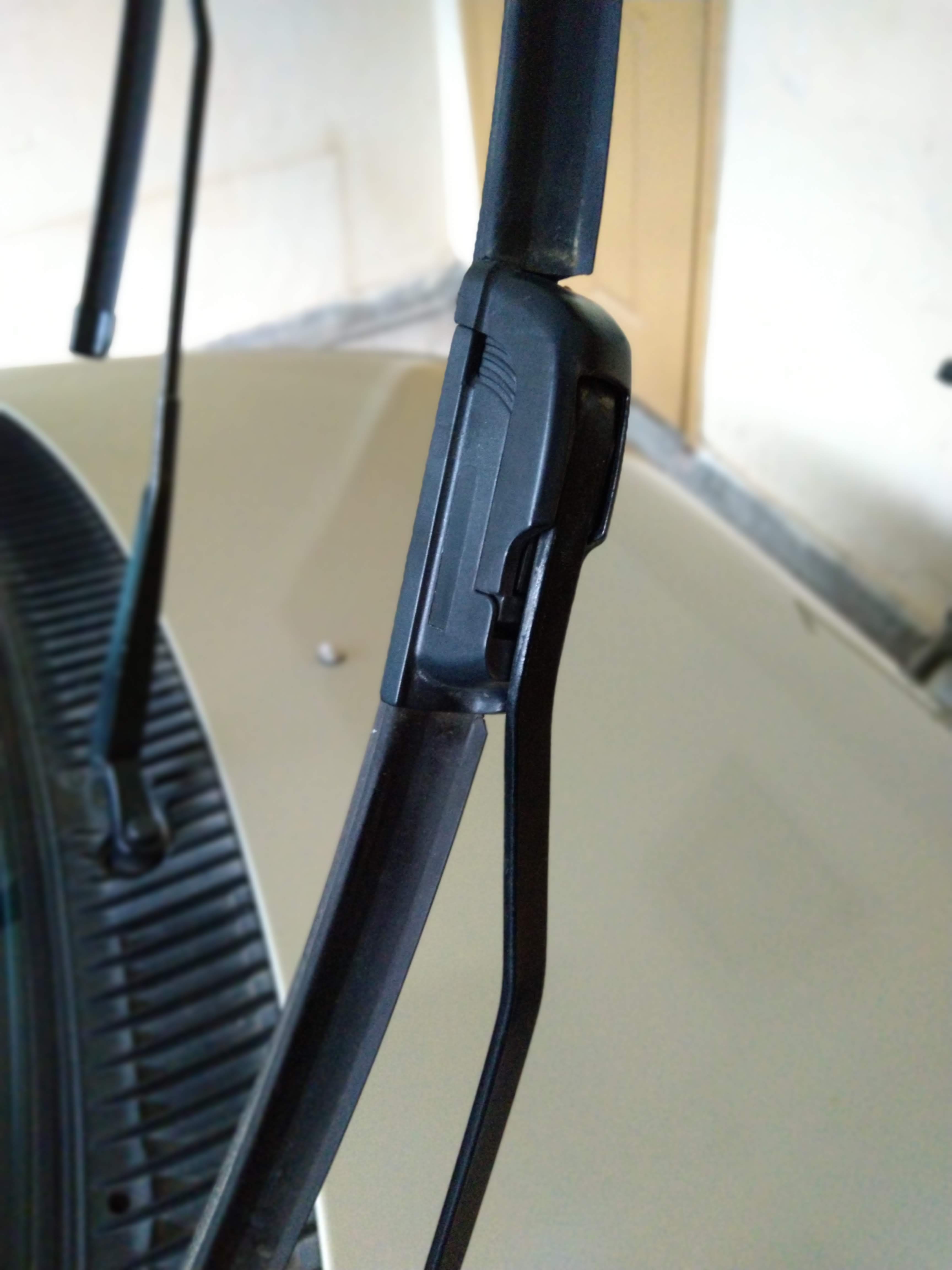

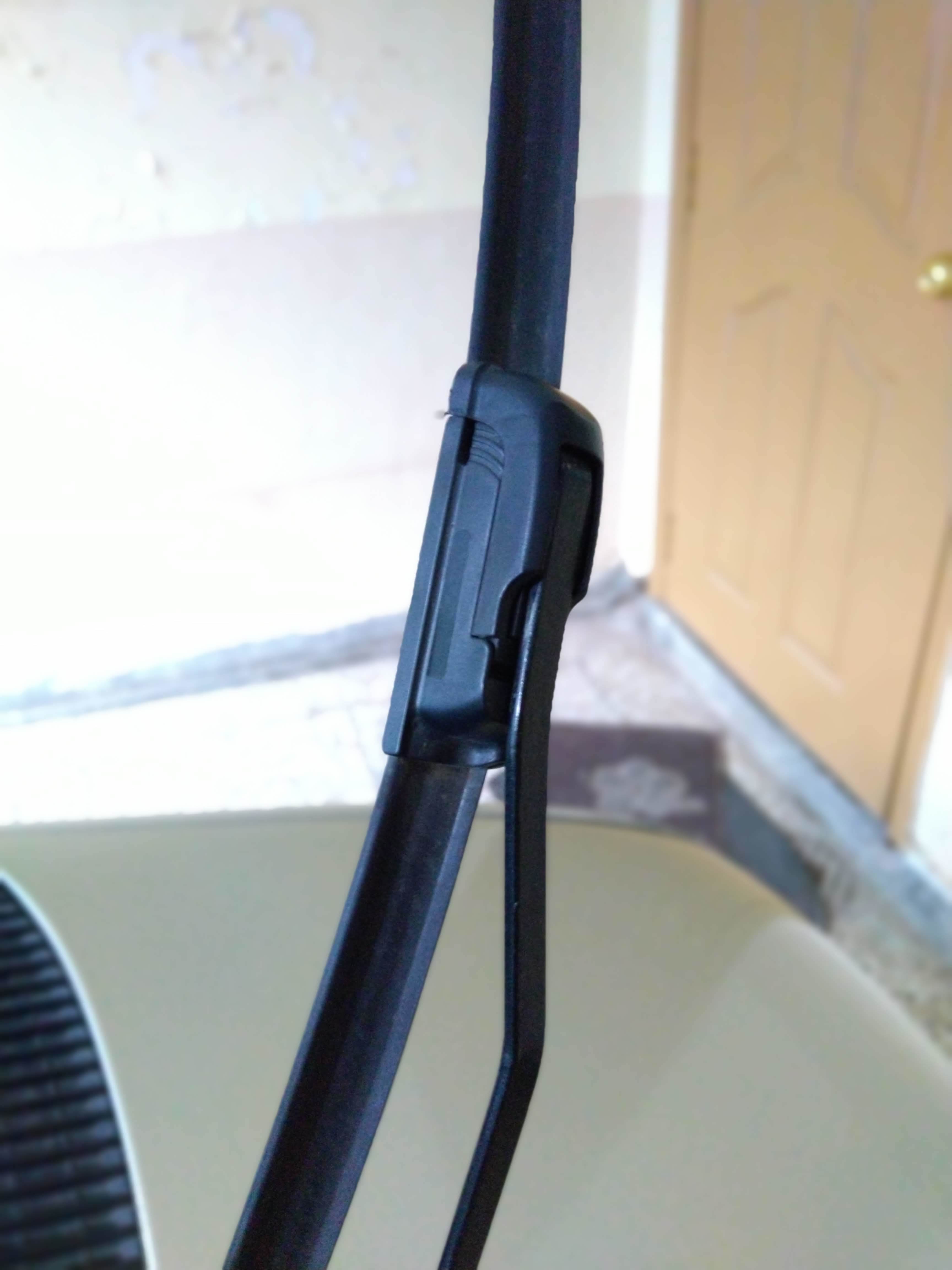

The blades should be able to flex, if they are the metal cage type, make sure the assembly can flex, if not then fix that too, usually a drop of oil helps on the hinges of the blade skeleton. The last piece is that the blade mounting ear should not be floppy and loose. The blade should be able to rotate in one plane only on the mounting, otherwise the blade will chatter.
