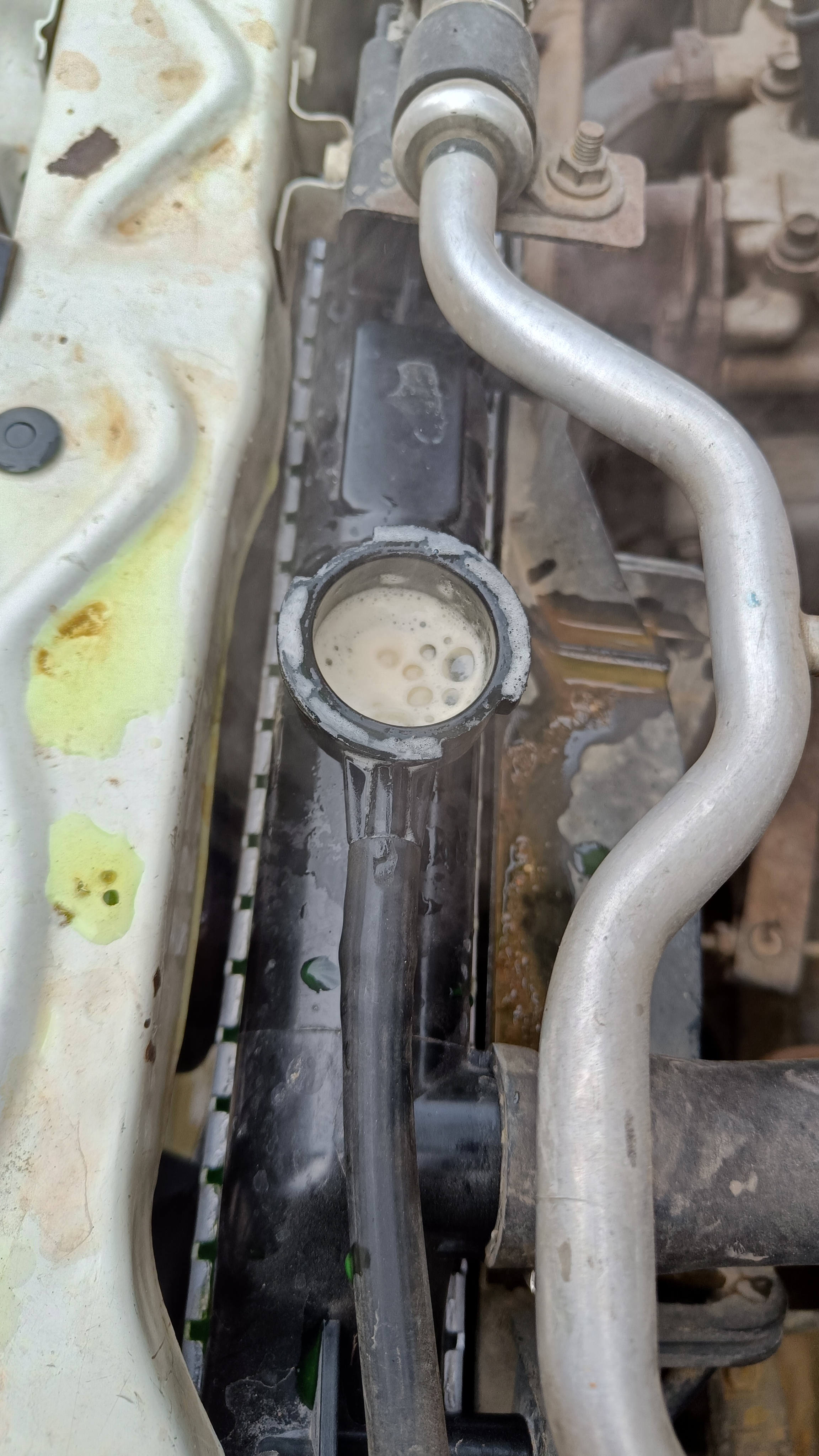

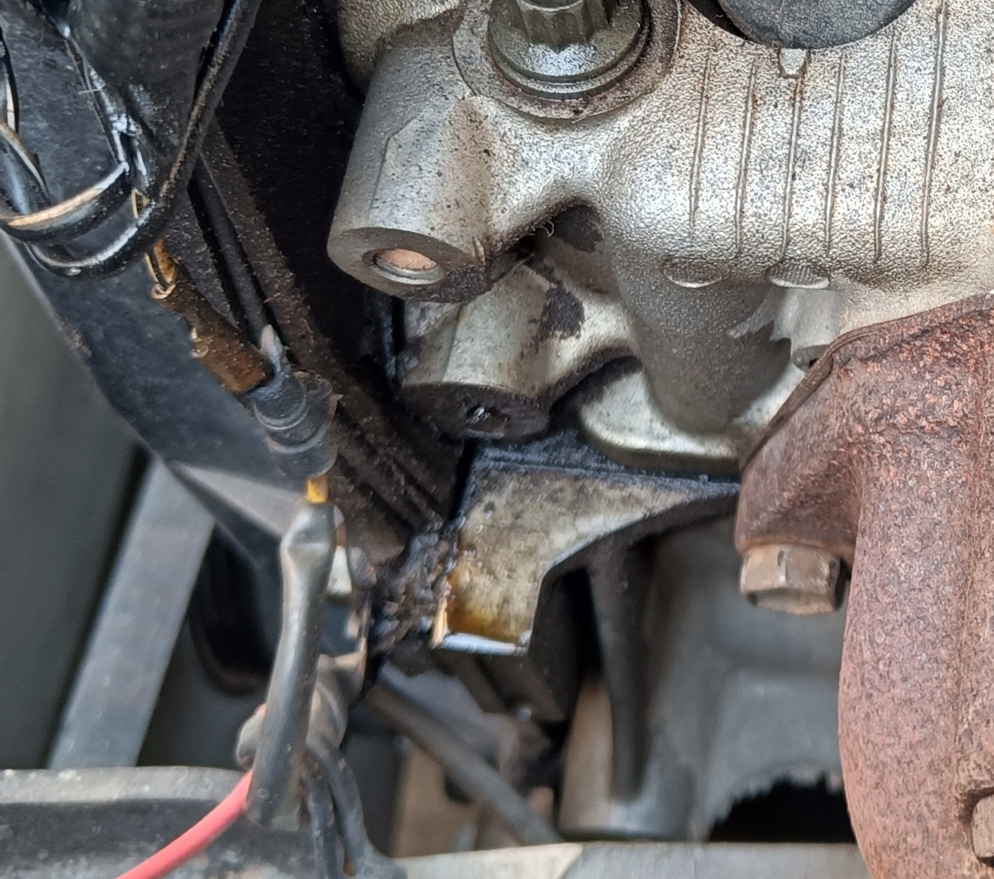

I put a guard coolant to spot any leak planned changing to proper coolant in the coming weekend. But on Monday while going to office in morning, I noticed the heat guage at around 75% and steam from left side of bonnet. I stopped it right away. I thought fan didn't turn on so I called electrician and he checked the connection was working. So we poured water and the top hose started to leak where it connects with the rad. Evening tightening the clip fixed it a little
I topped the water and slowly went to the radiator guy. He said rad is weak so I got it changed.

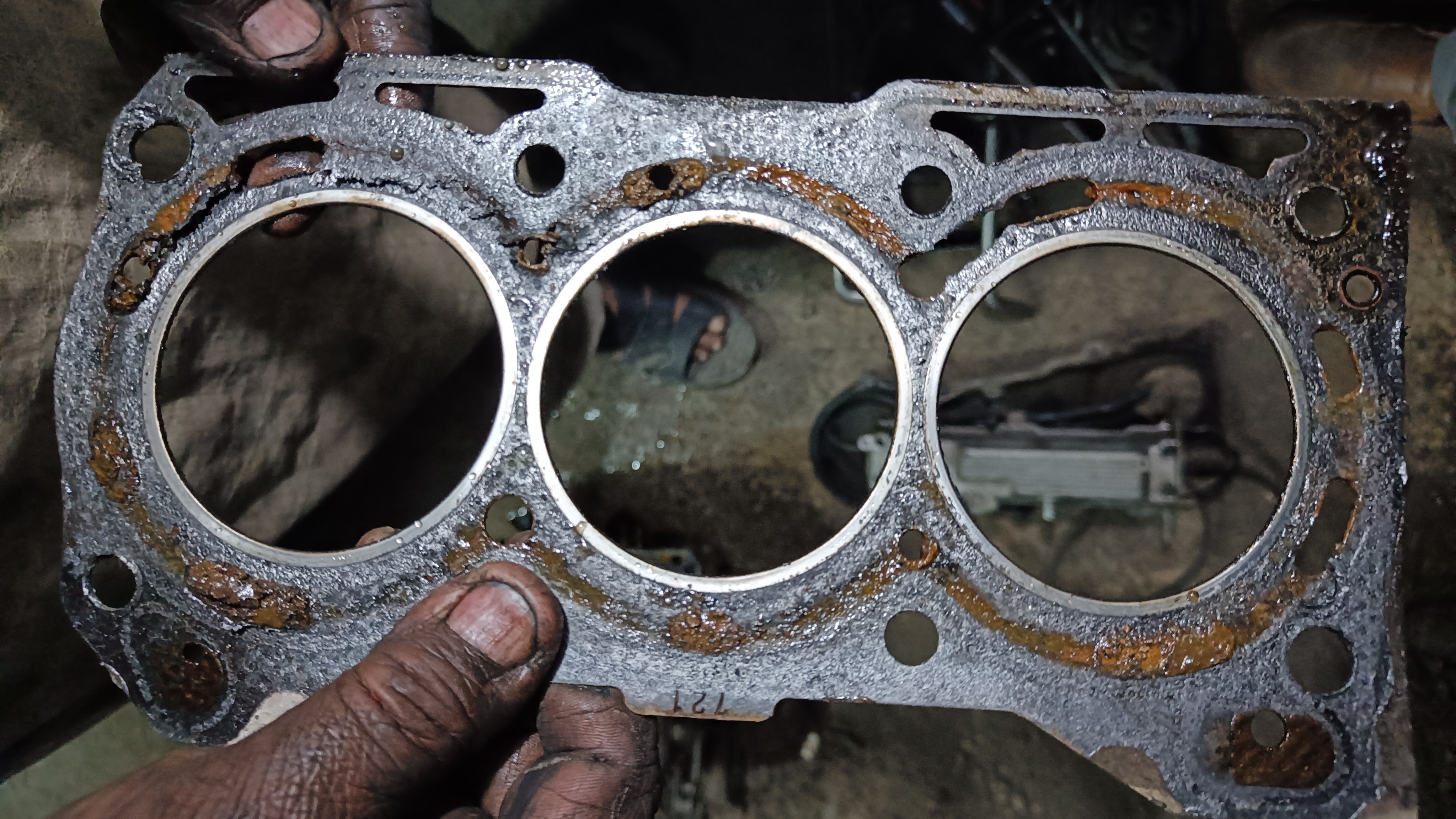

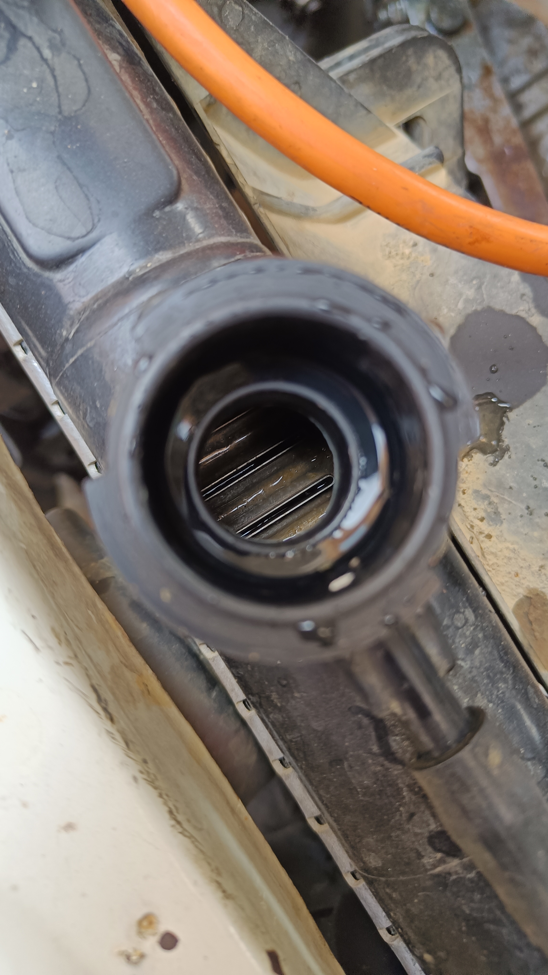

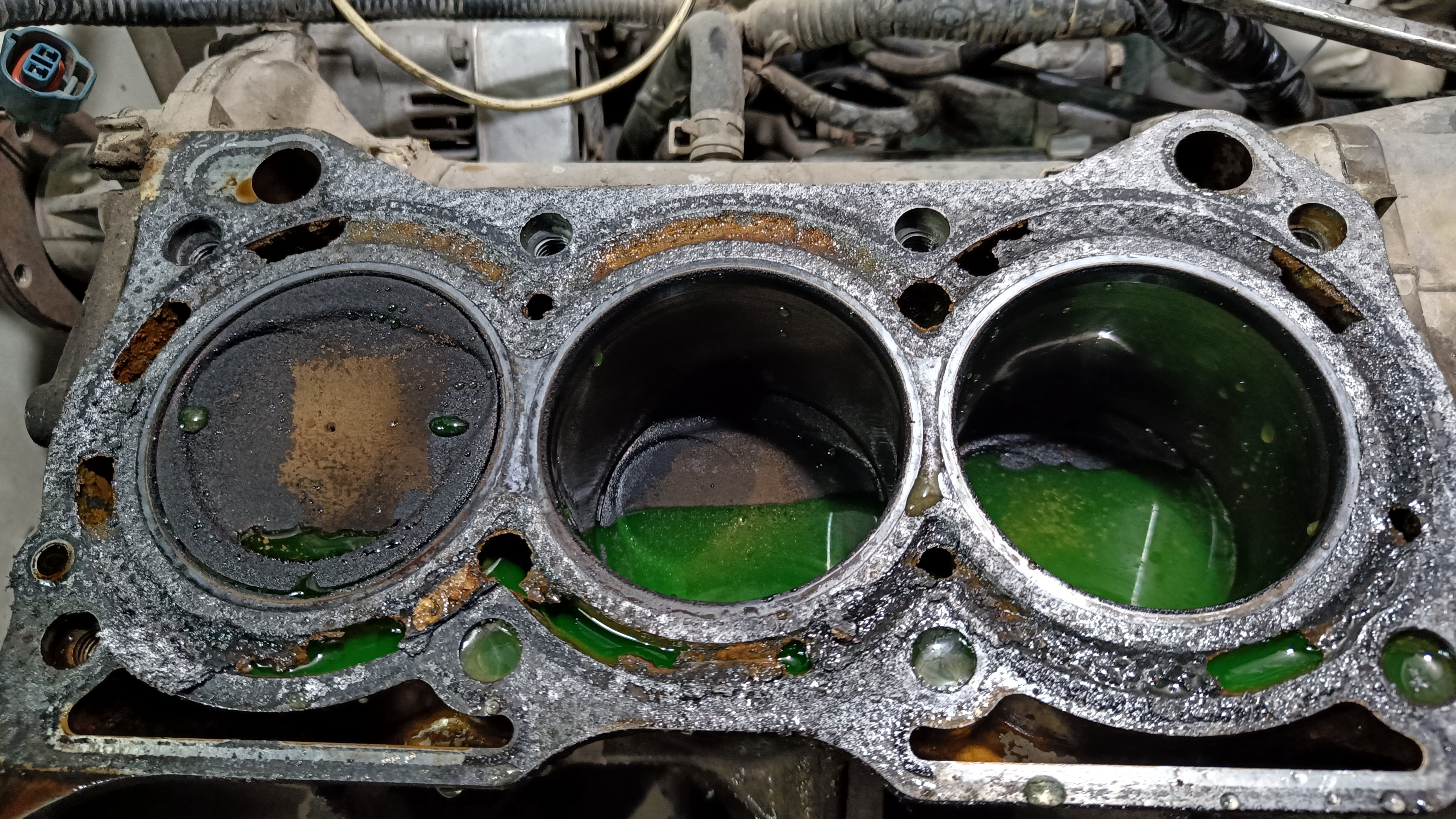

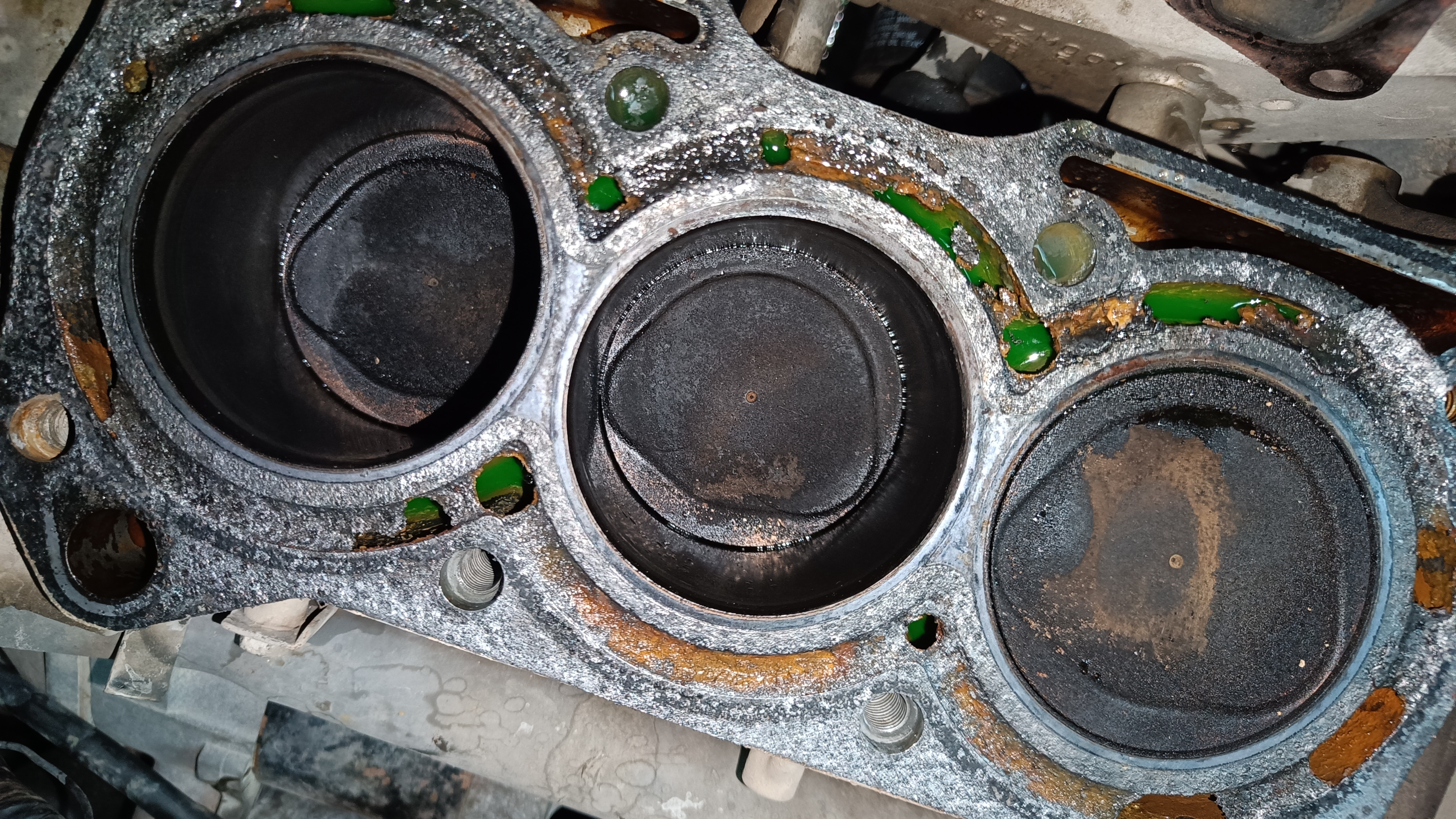

I have doubt that head gasket might got slightly leaked. As next morning without rad cap I cracked the engine and it threw water with pressure. Also reserve bottle was slightly above full level. Today I opened the radiator cap and found few bubbles too.
Maybe I'm overthinking but I want to pour good coolant and install Thermostat so I want to make sure no head gasket or cooling system leak.
Any workshop which can do compression test for gasket and pressure test for the cooling system, and fix whatever is required, without jugaars
