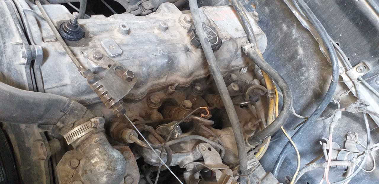

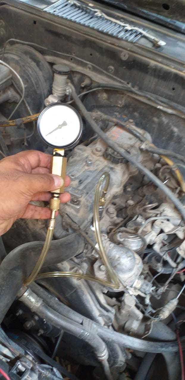

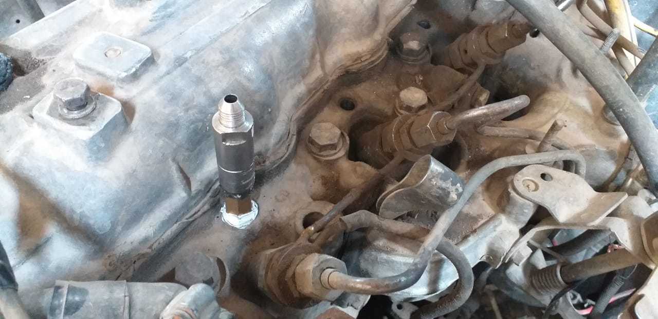

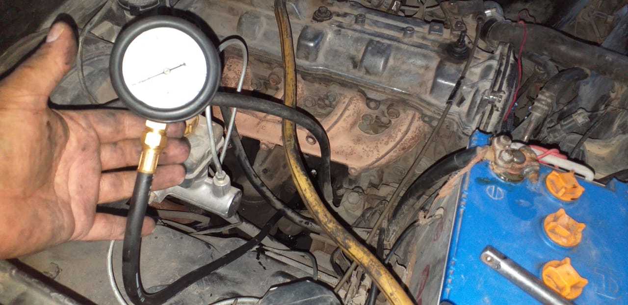

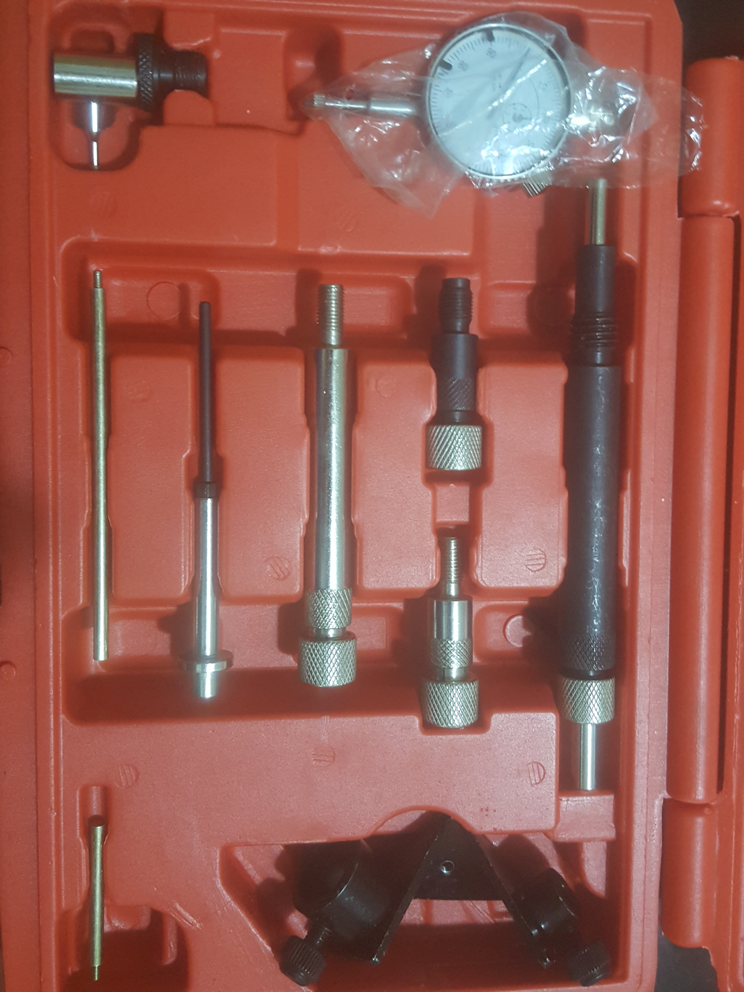

Hello PW, suggestion needed for Toyota 2l engine , either overhaul or swap it with another used engine, I have just checked the compression and oil pressure of engine and at present compression is 295 290, 280 and 340 psi , at warm engine and without adding oil in cylinders, cold oil pressure at idle is 42 psi and at 65 psi at 3000 RPM , hot oil pressure at idle is 18psi and 57psi at 3000 RPM , engine starts well when it is warm but does take lot of cranks couple of glowplug sessions when it is cold , I did check the glow plugs and they are all ok , also checked the valve clearance and injection timing , all with in specs , no issue of oil/coolant mixing , engine stands perfect at idle ,
Suggestion needed for either overhaul or swap , I personally feel engine is solid and it is possible to restore back , thanks ,
