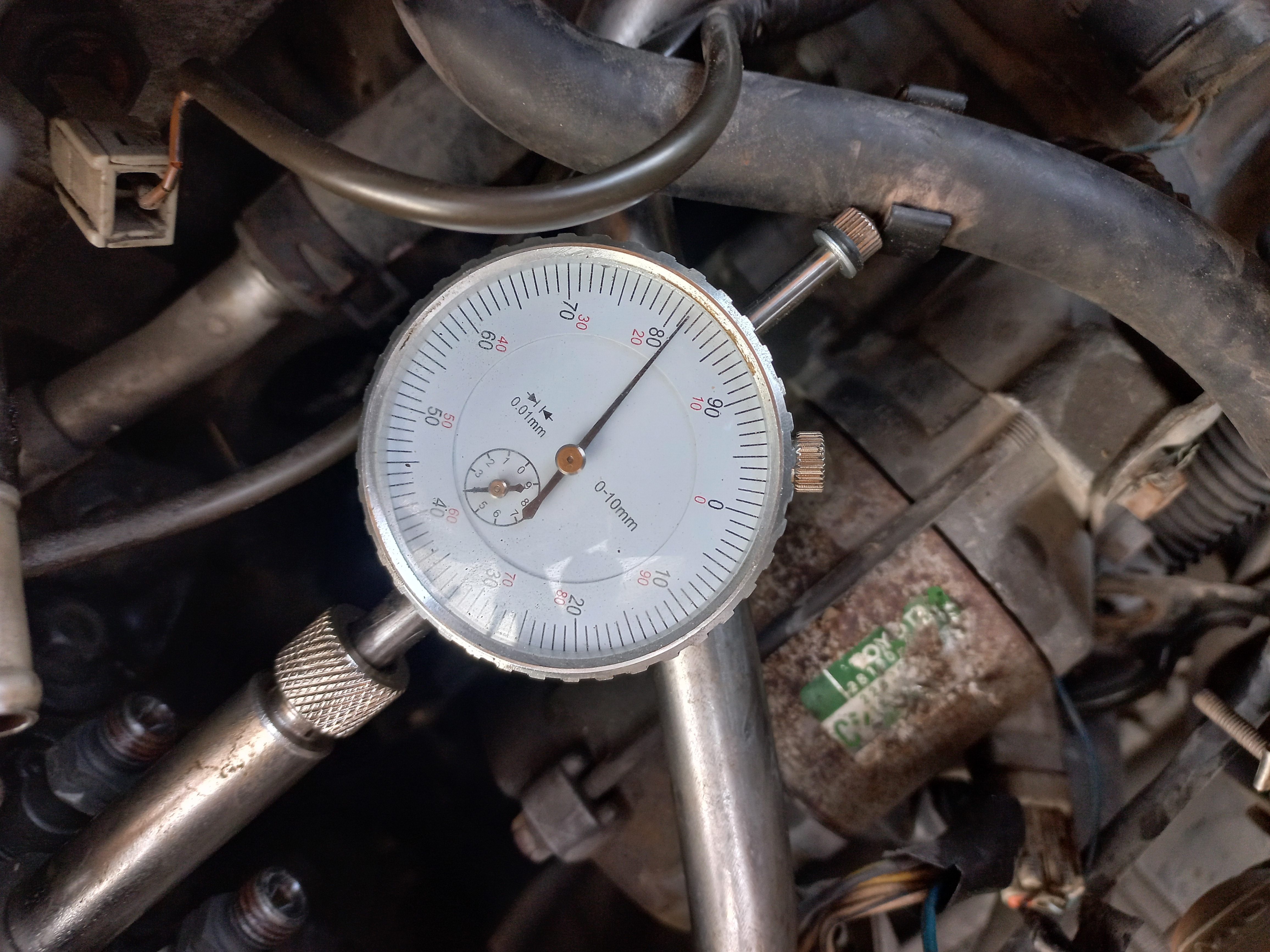

Dear @Xulfiqar my car (toyota 2c engine) is having excessive blowby when open engine oil cap---since i will receive dial guage next month purchased in Gulf...
While doing timming belt job i also changed tapper cover seal and timming seal and oil pump O ring--it was leaking...now it stopped leaking from there no leak under the engine but tapper cover is leaking like anything
Will attach pic for reference,
Since it has excessive blowby, rings seem to be worn out...
Your two cents on this
What should i do? Shall i wait for dial guage to time pump according to specs or do its ring job as tappet cover is leaking engine oil too much
Tapper cover was fitted cautiously with silicon and its seal
Confused now because of excessive blowby and tappet cover leaking
According to mechanic rings are worn out so it will leak any weak spot...
