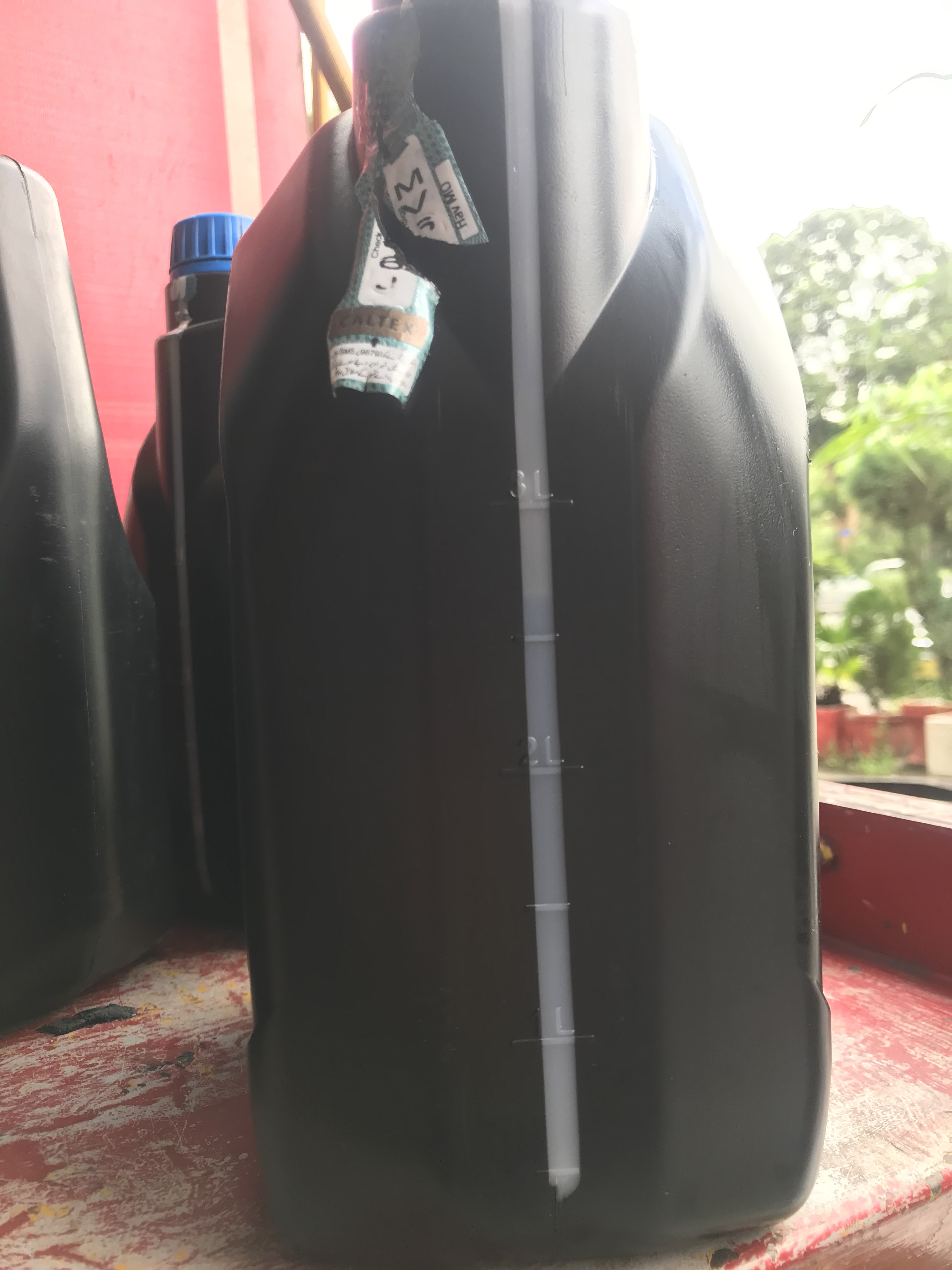

Need help. I have Honda City Aspire-1.5L 2014 model with mileage of more than 1 lakh km.I always used Total oil for my engine as recommended by Honda RWP. However, after long drive it started showing low level in dipstick. I then changed oil to Honda engine oil as recommended by Honda Rahimyar khan (which i never knew existed before). Problem stayed on. I then took it to Honda Peshawar n they say it can be some issue in engine. However it is NOT emitting any smoke or leakage so i should not worry. I took out the oil again n to my surprise it was shown nearly full in oil jar of 4 ltrs. Now again it is showing oil level nearly LOW level i.e touching to first dot after travelling 1200 kms.What can be the problem ? Honda folks r just guessing. Need urgent help
How much reduction ? And after how many ka do u notice this ?
I have attached pics...eats avg 1 litre of engine oil....noticed it after 1600 KM travel and its constantly happening
