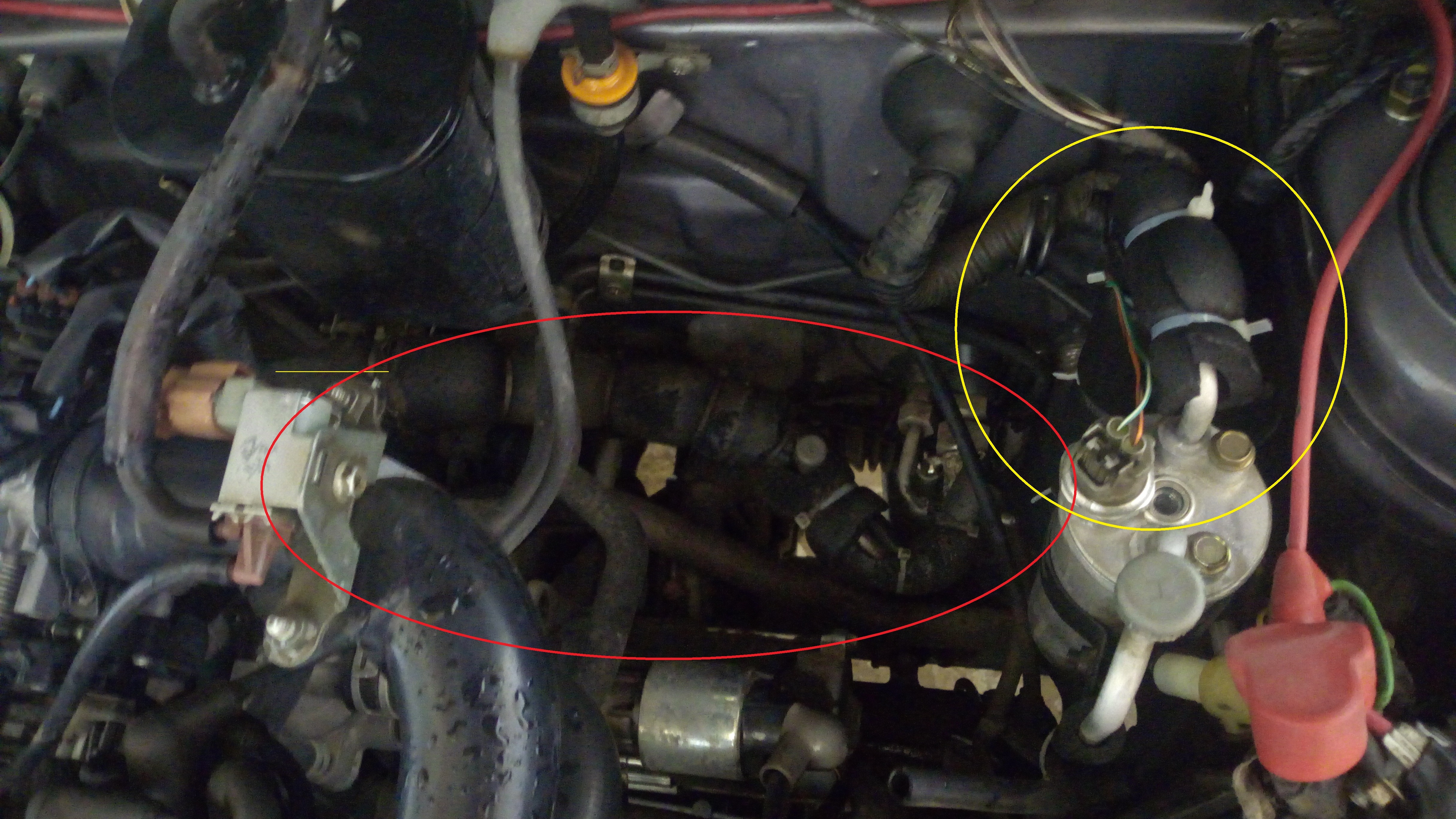

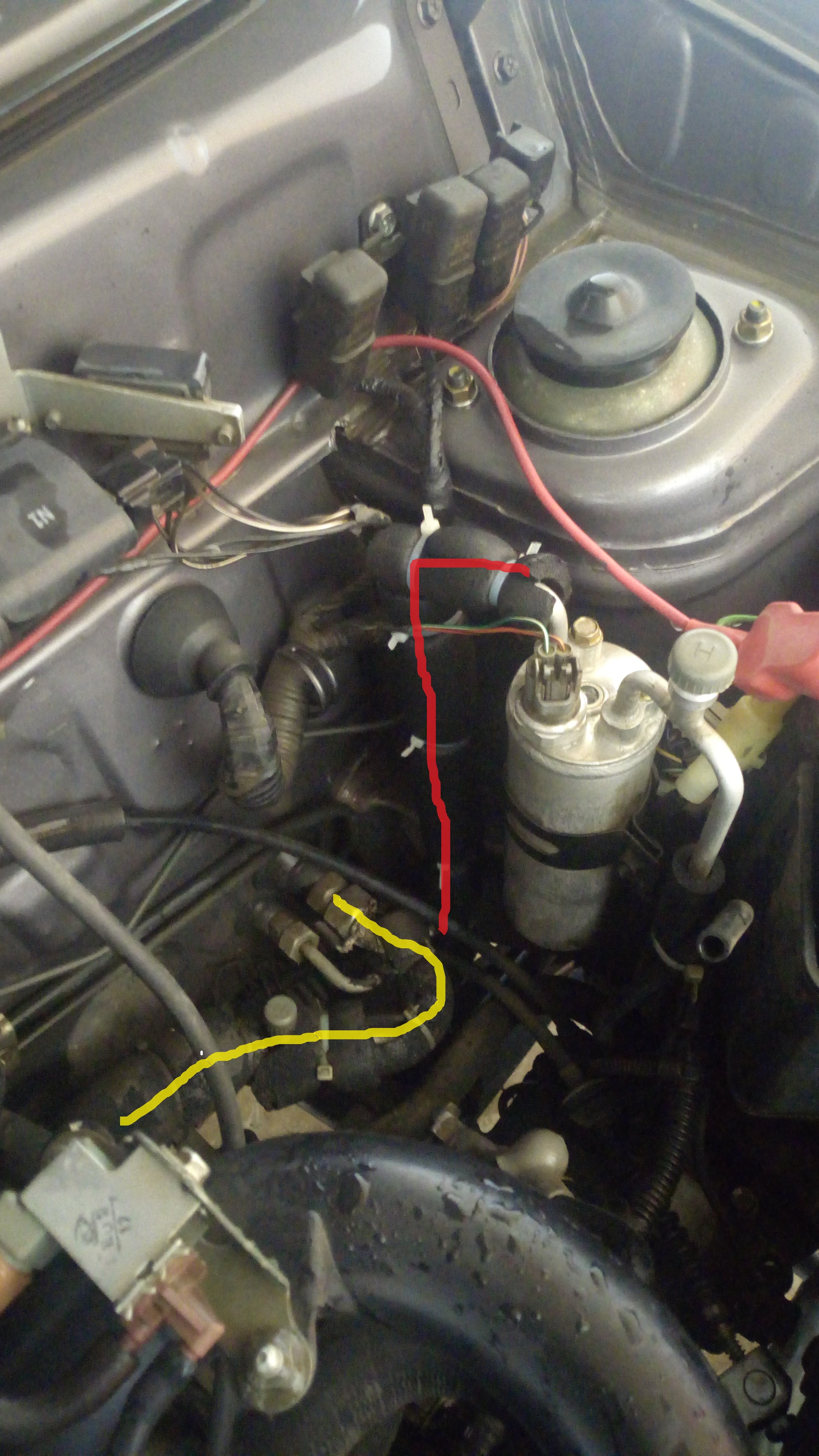

i think newer models have insulation from factory on ac pipes. i will check and confirm.

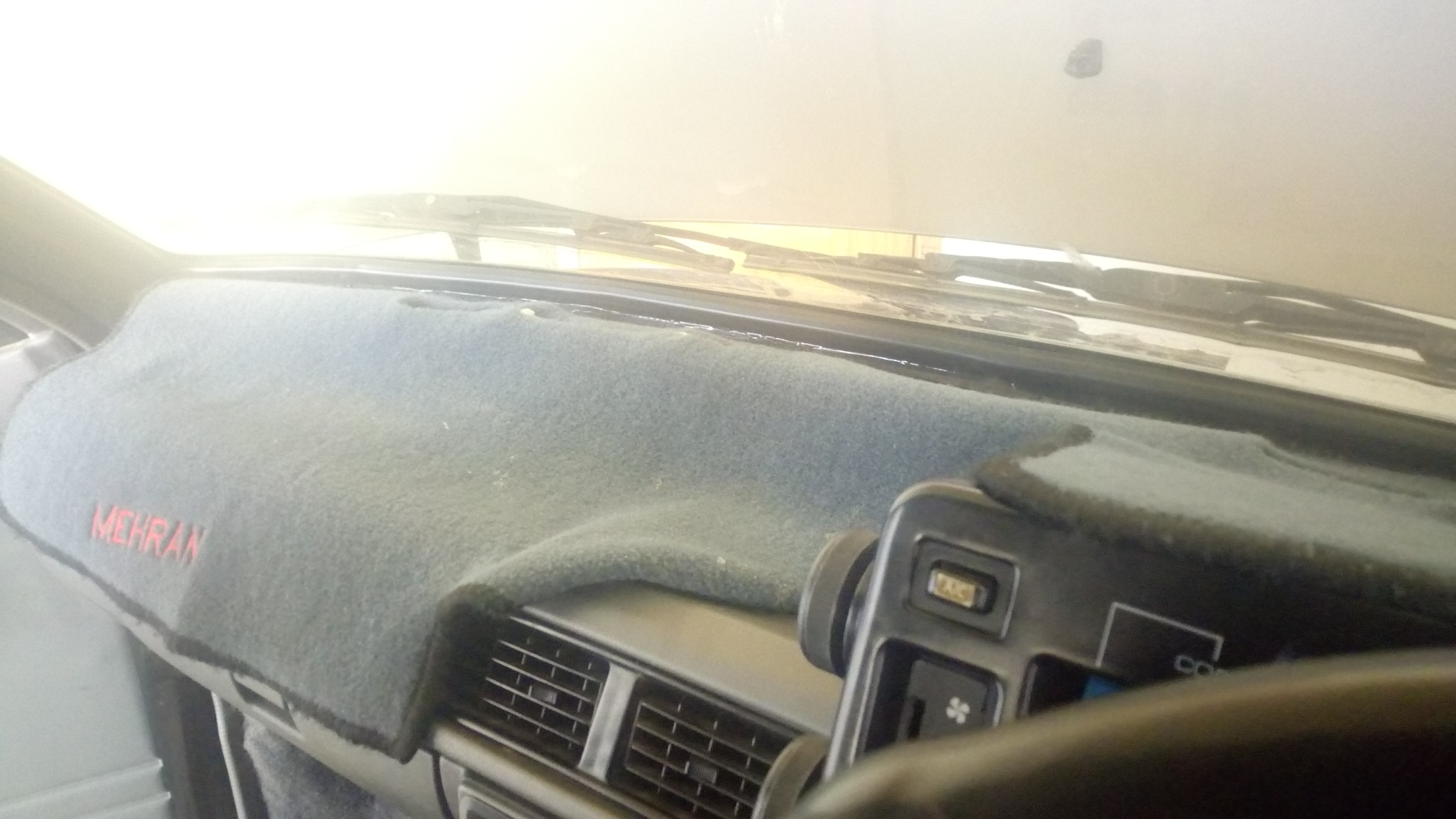

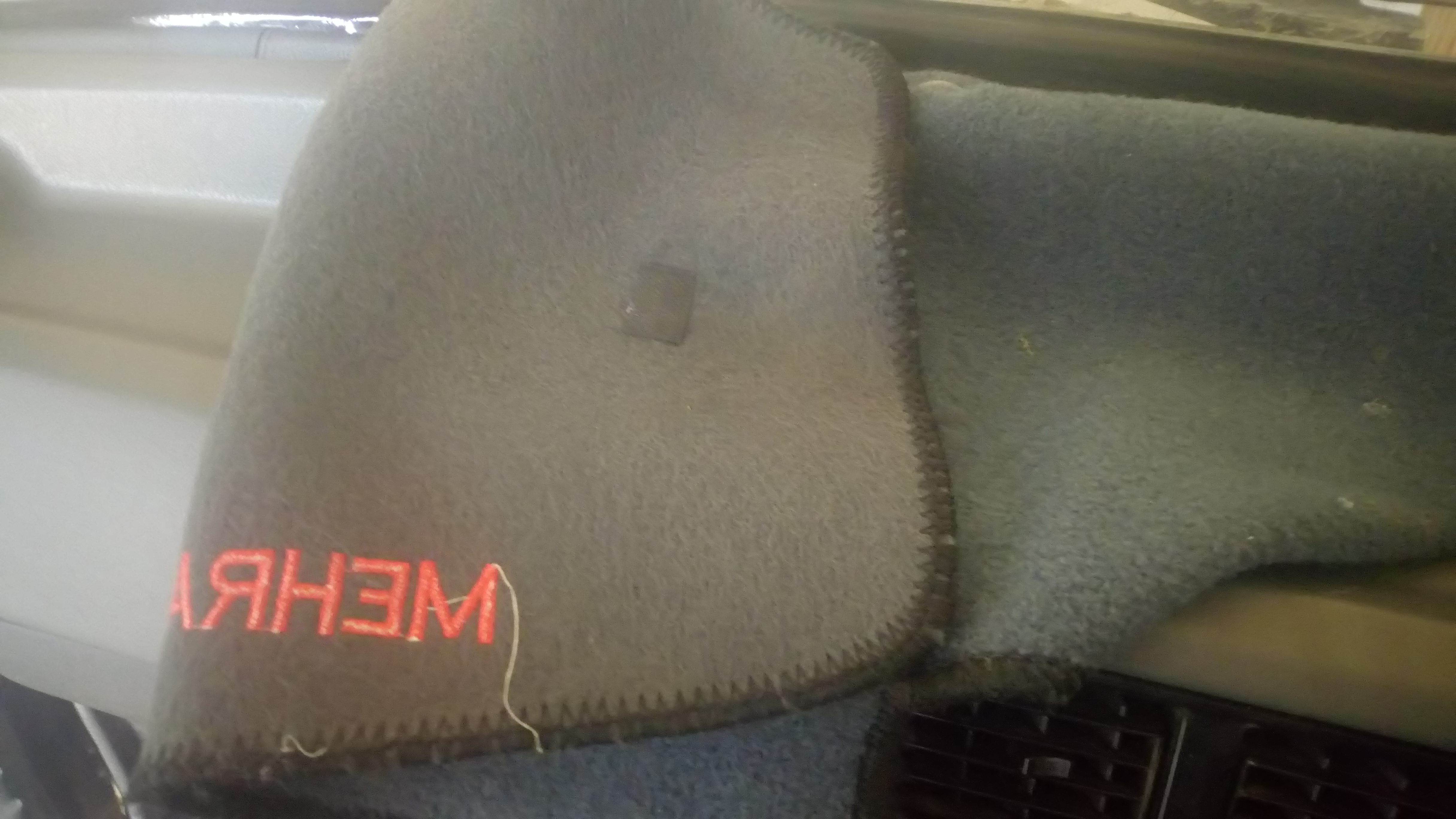

i have also got that mat on dashboard and i keep a tissue box right over the center vents so they dont get heat from sunlight.
