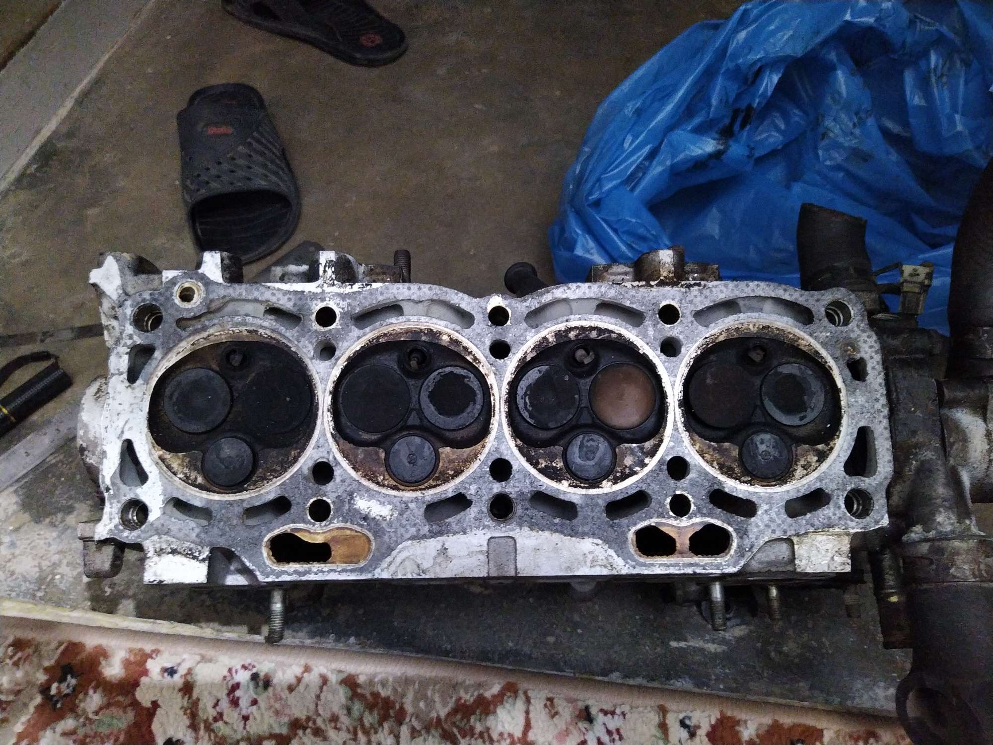

2- Knocking/pinging noise (carbon build up on the pistons)

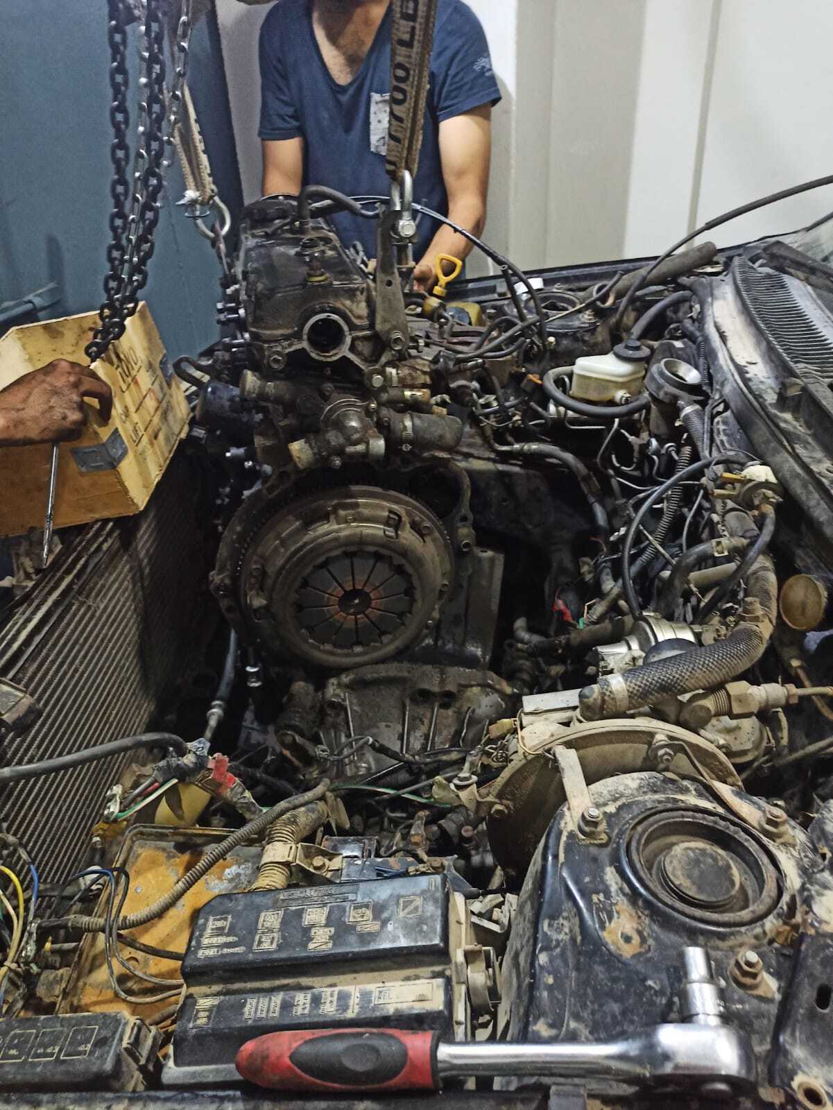

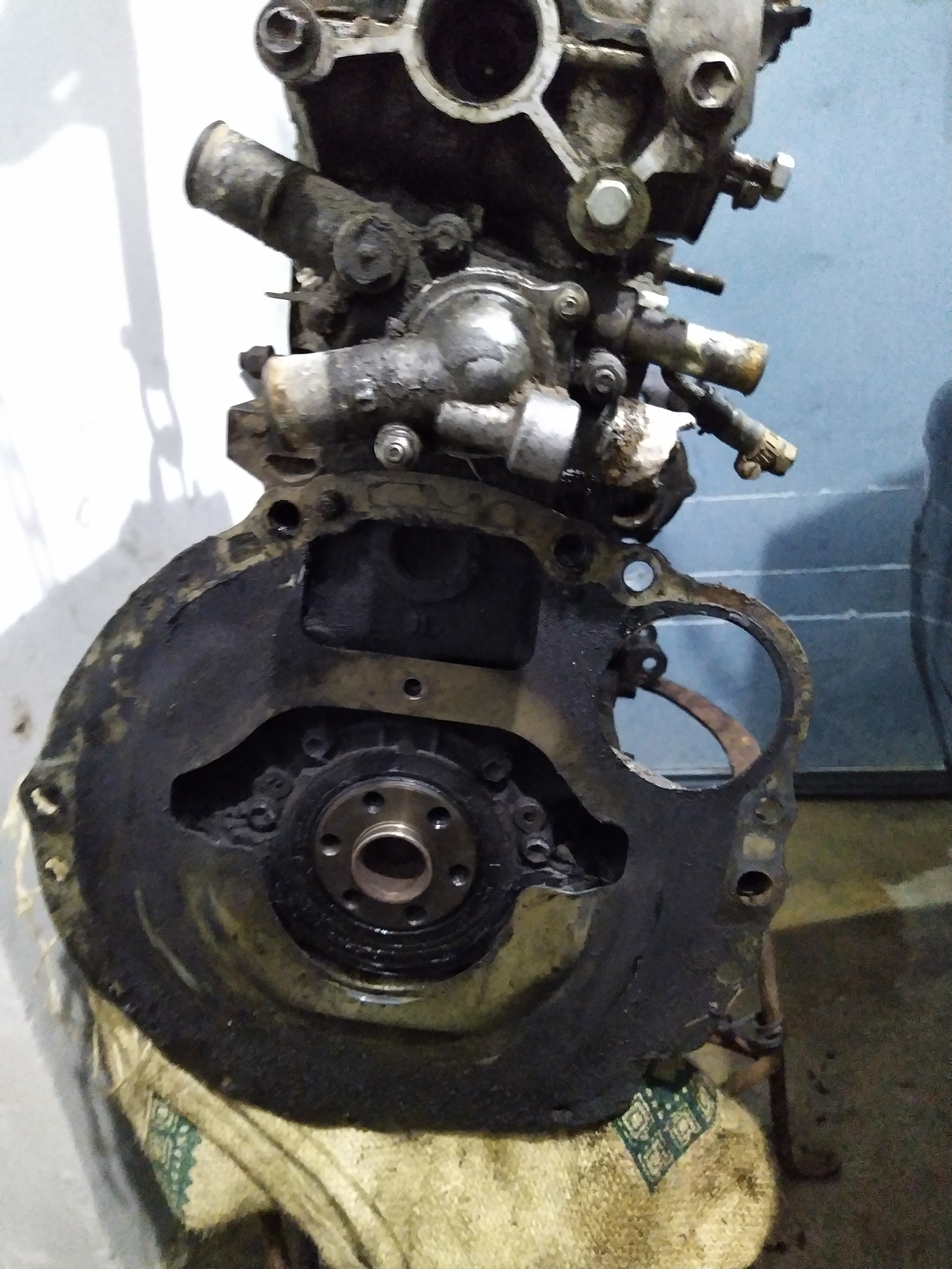

Hence the decision was made to rebuild the existing 2e engines. After which, list of parts was made and procured (toyota genuine parts were used when available). Machinist was decided, service manual was arranged and gone through, all bolt torque, clearance etc values were gathered.
I had to take leaves from the job to carry this out.

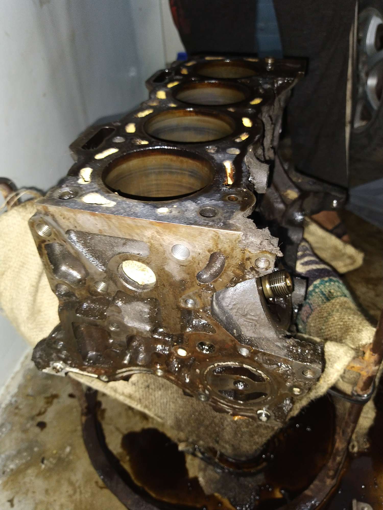

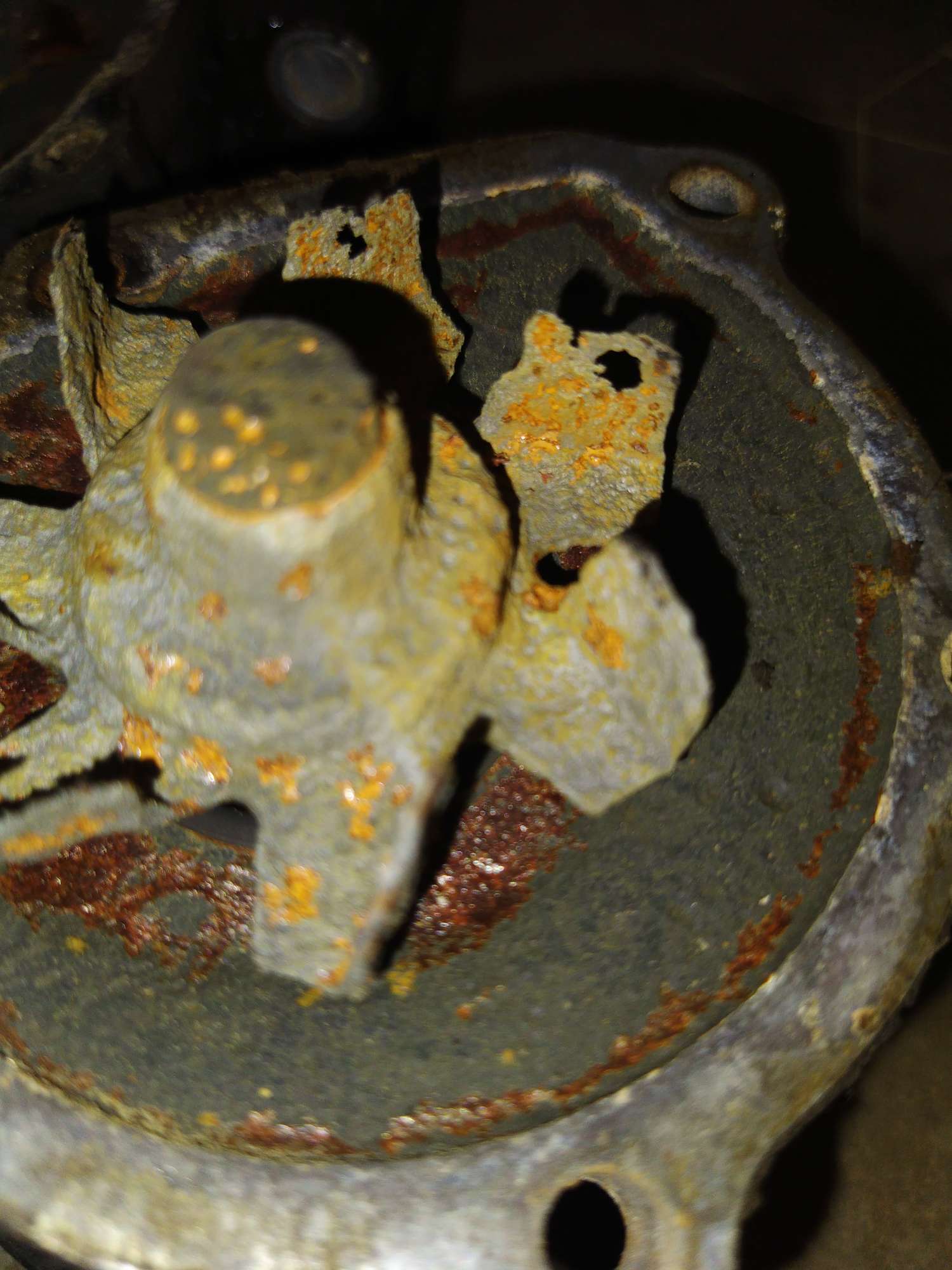

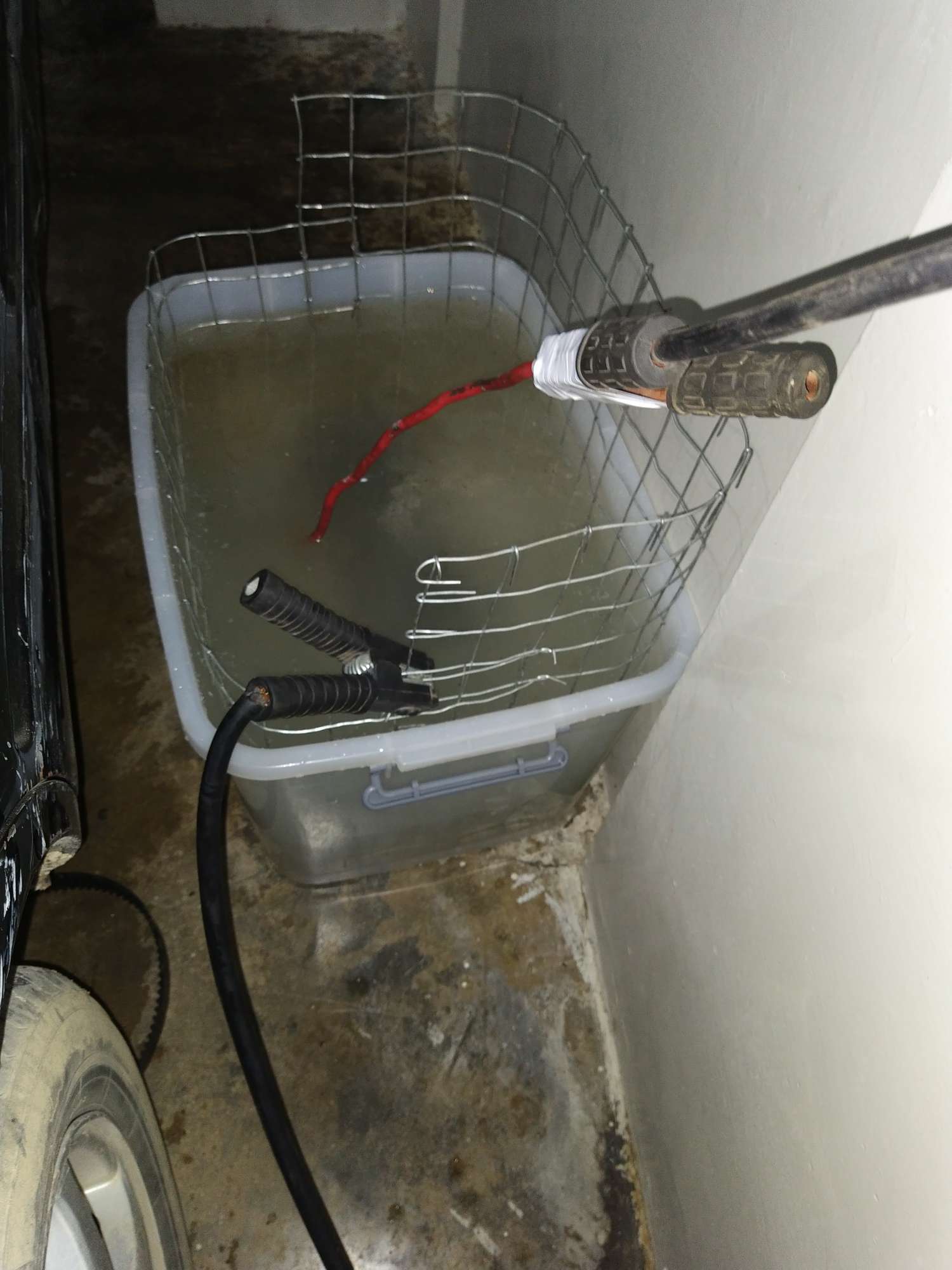

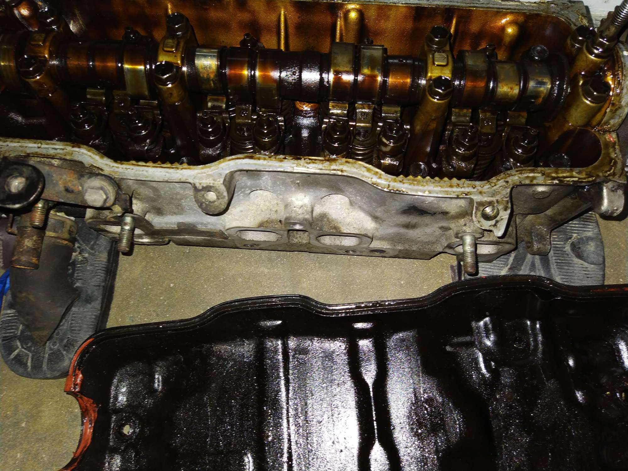

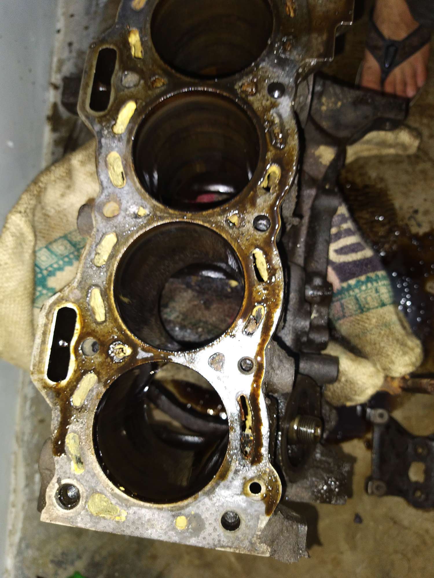

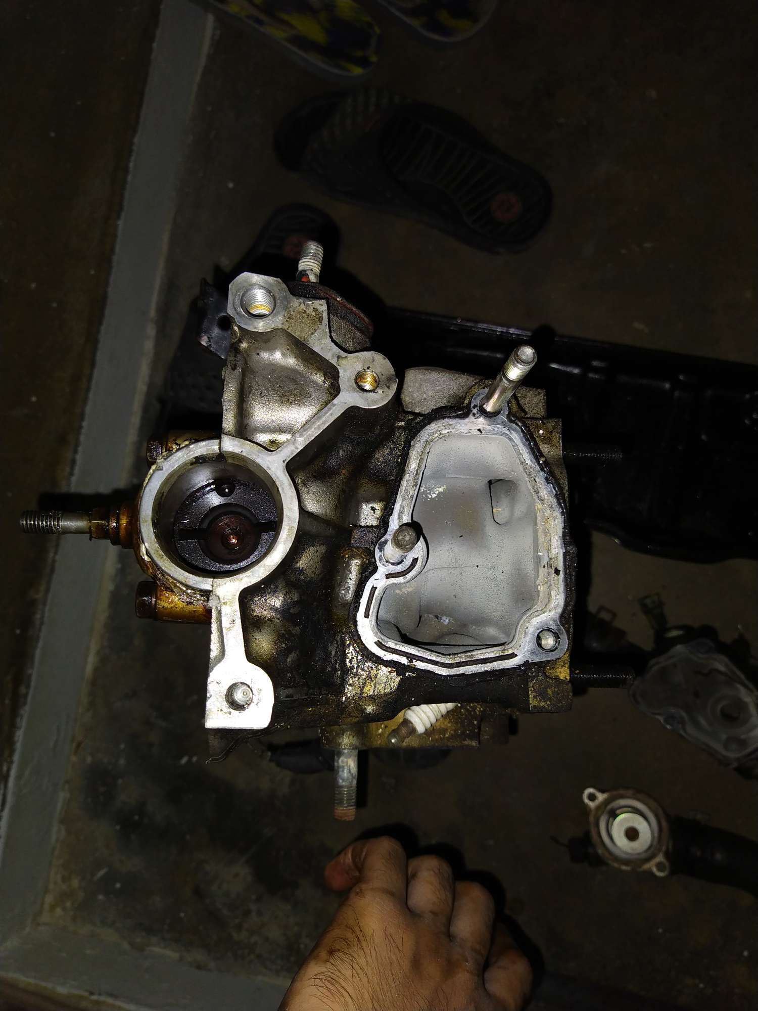

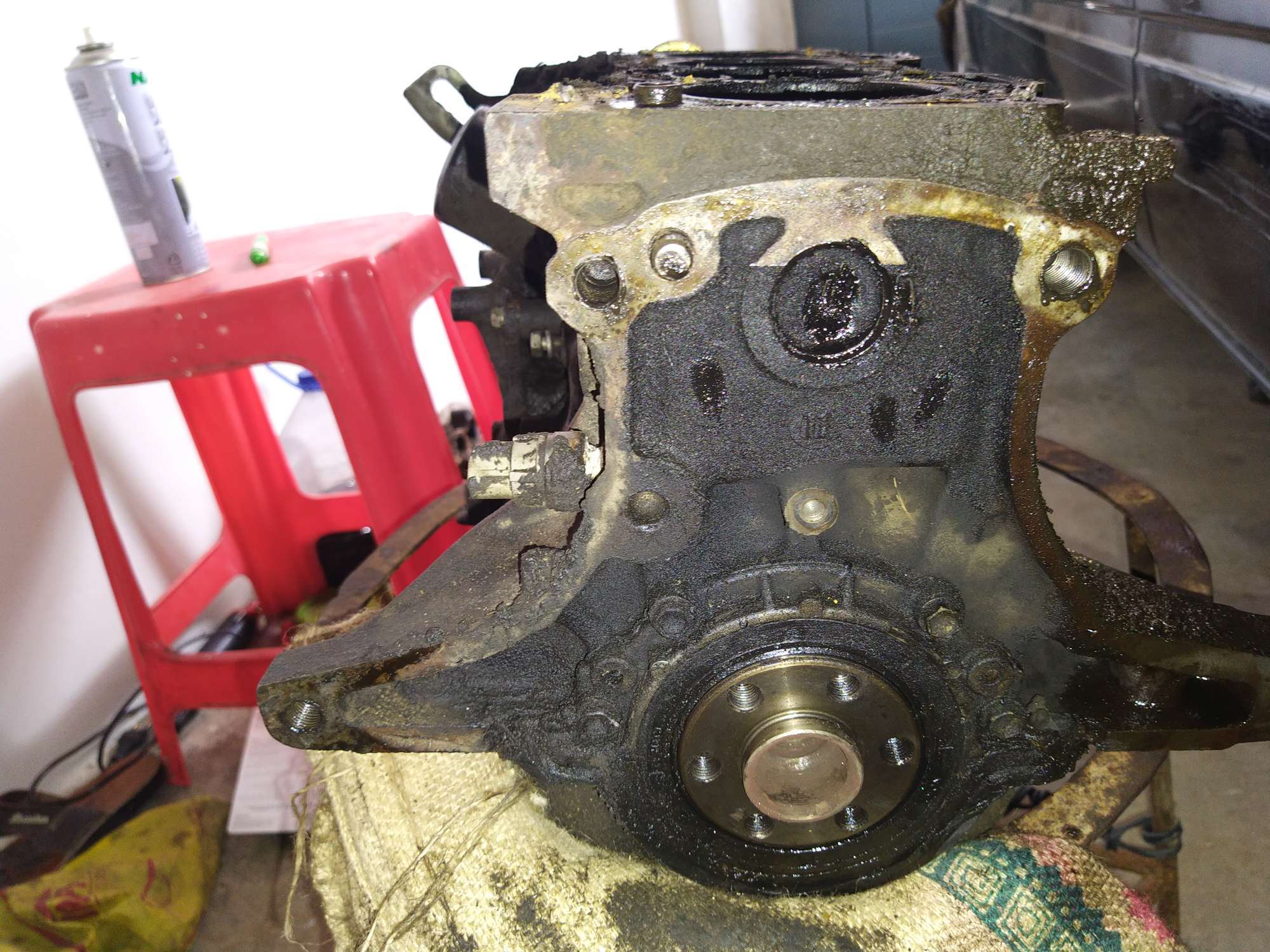

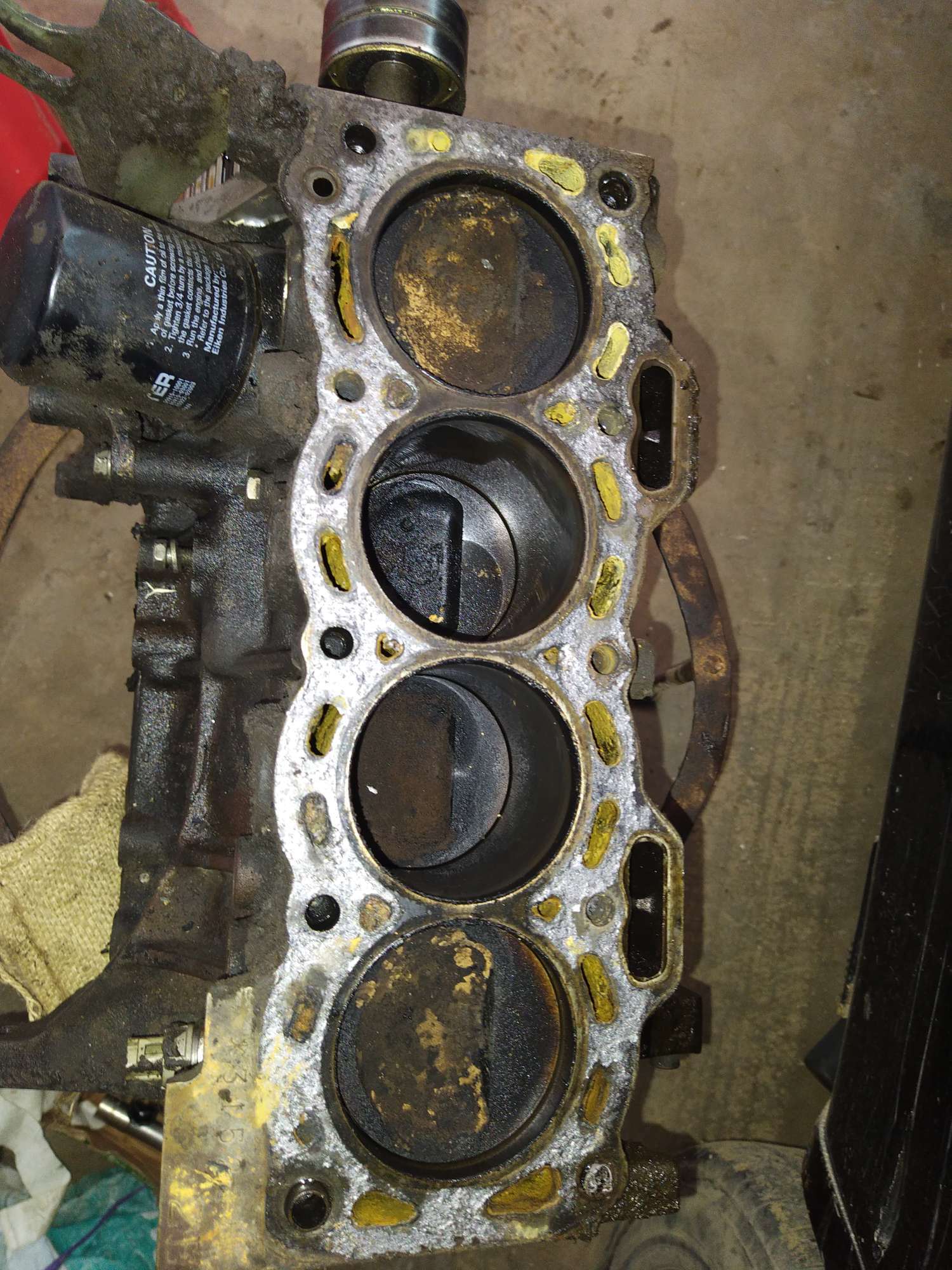

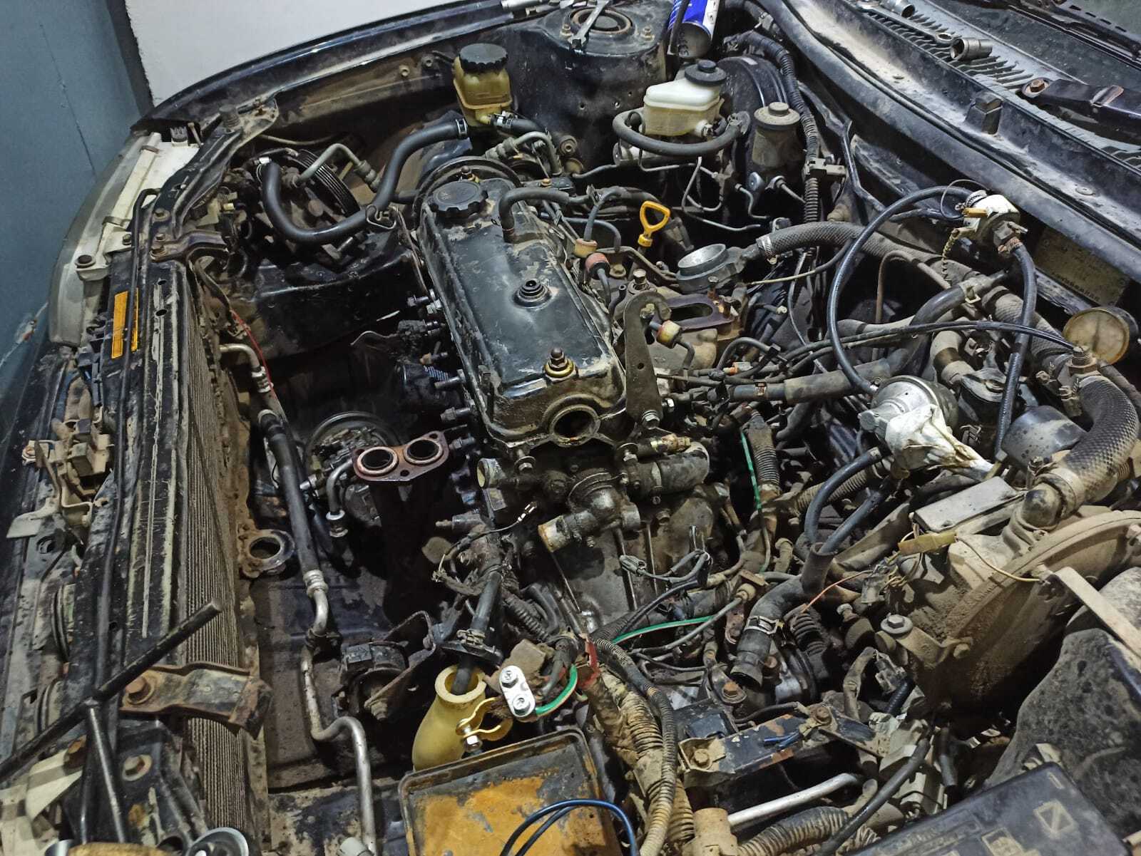

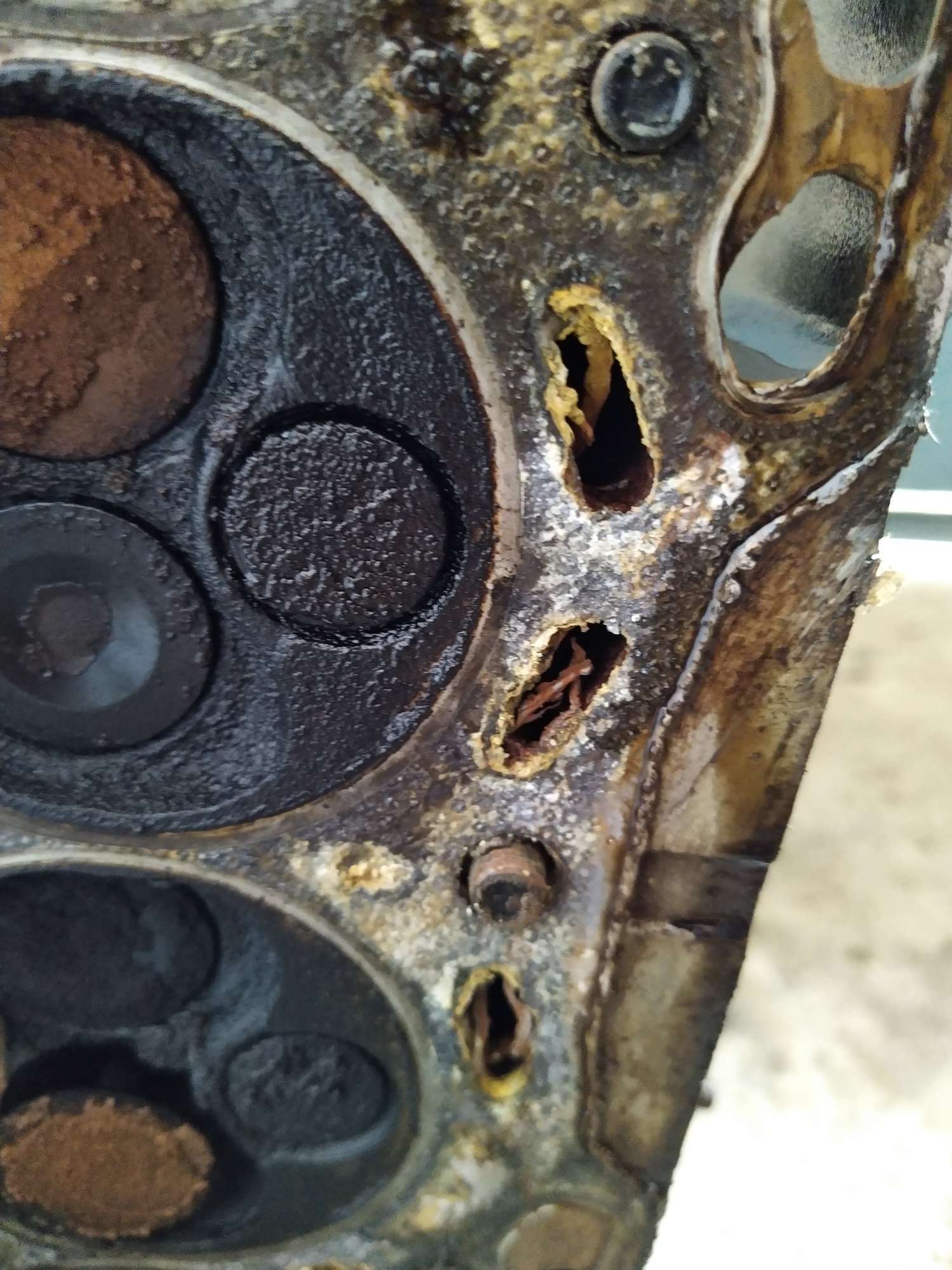

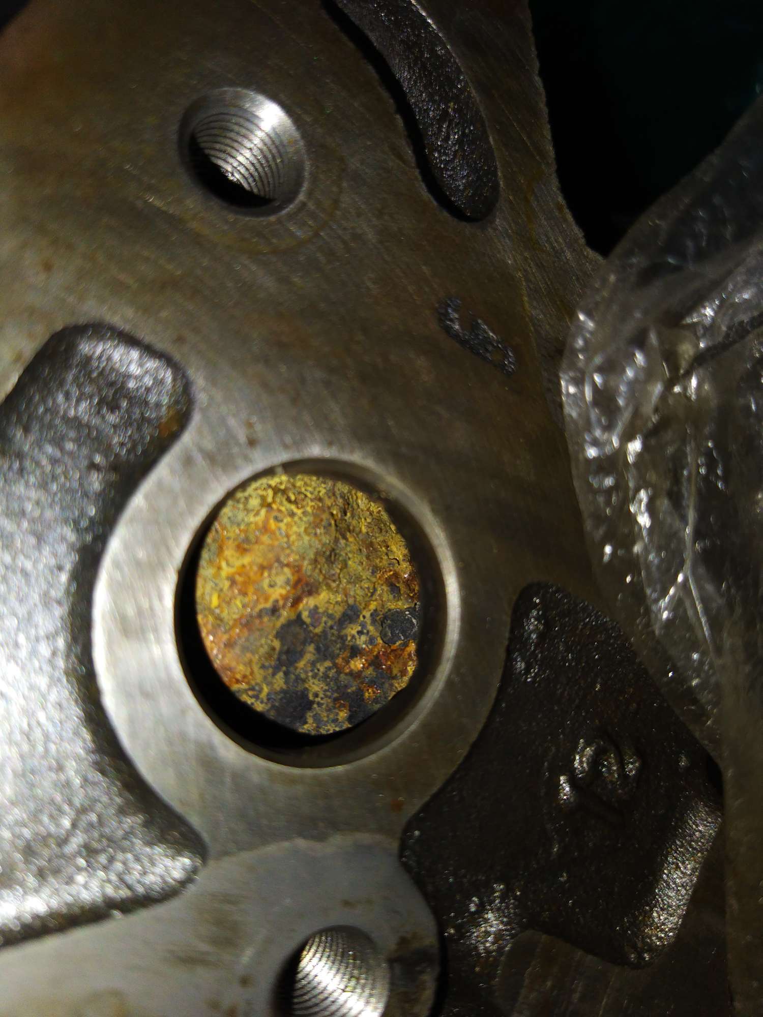

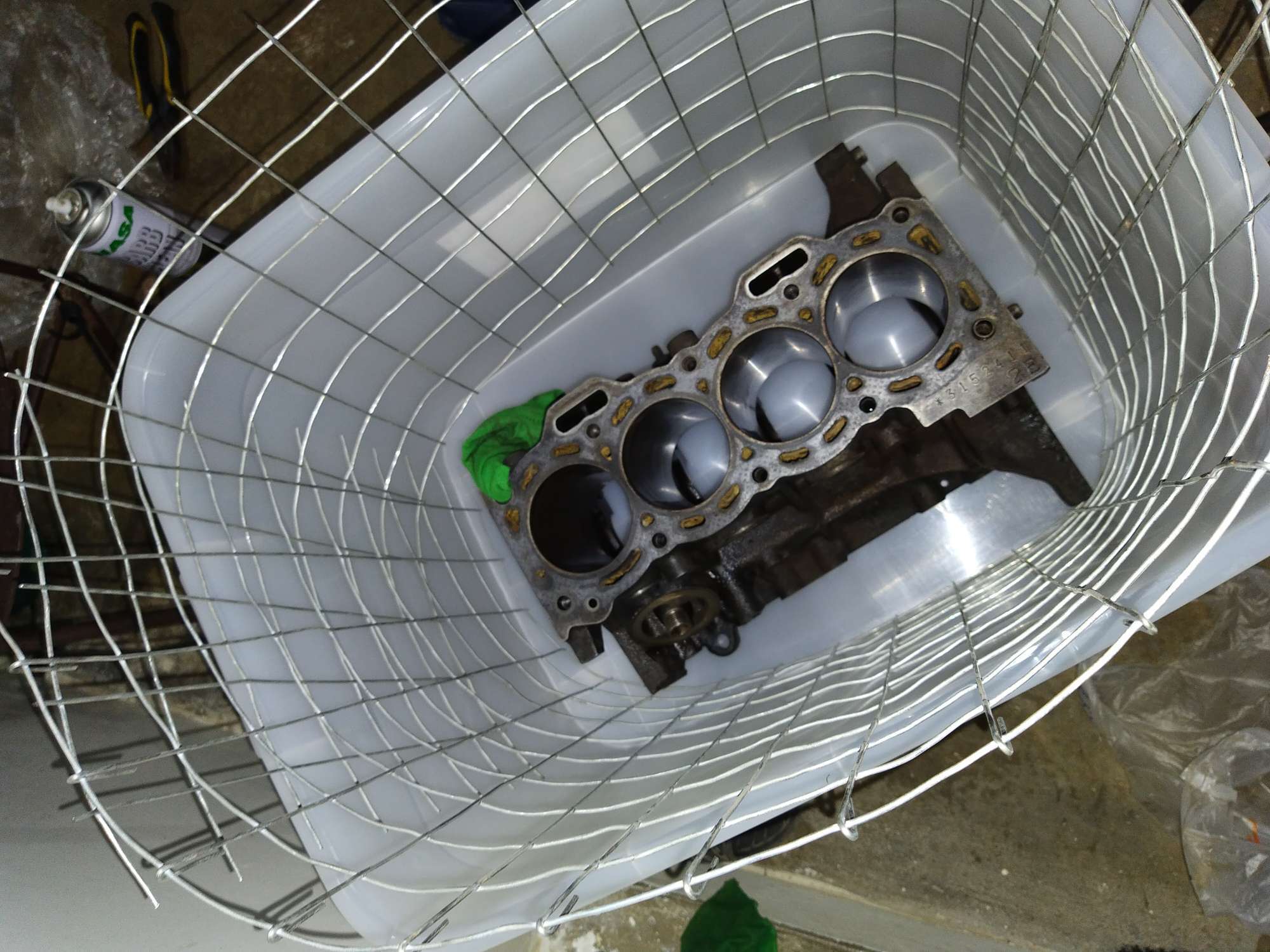

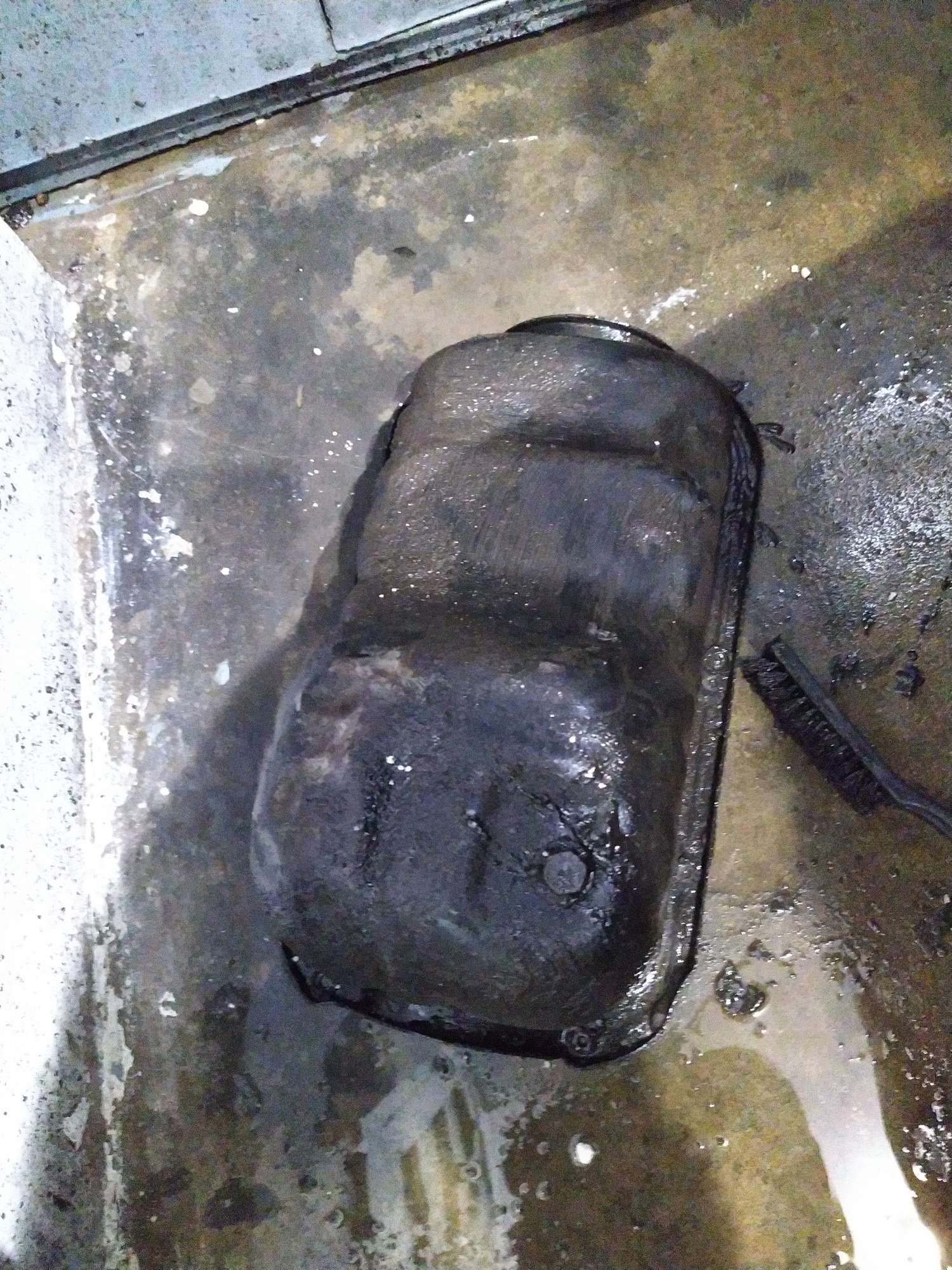

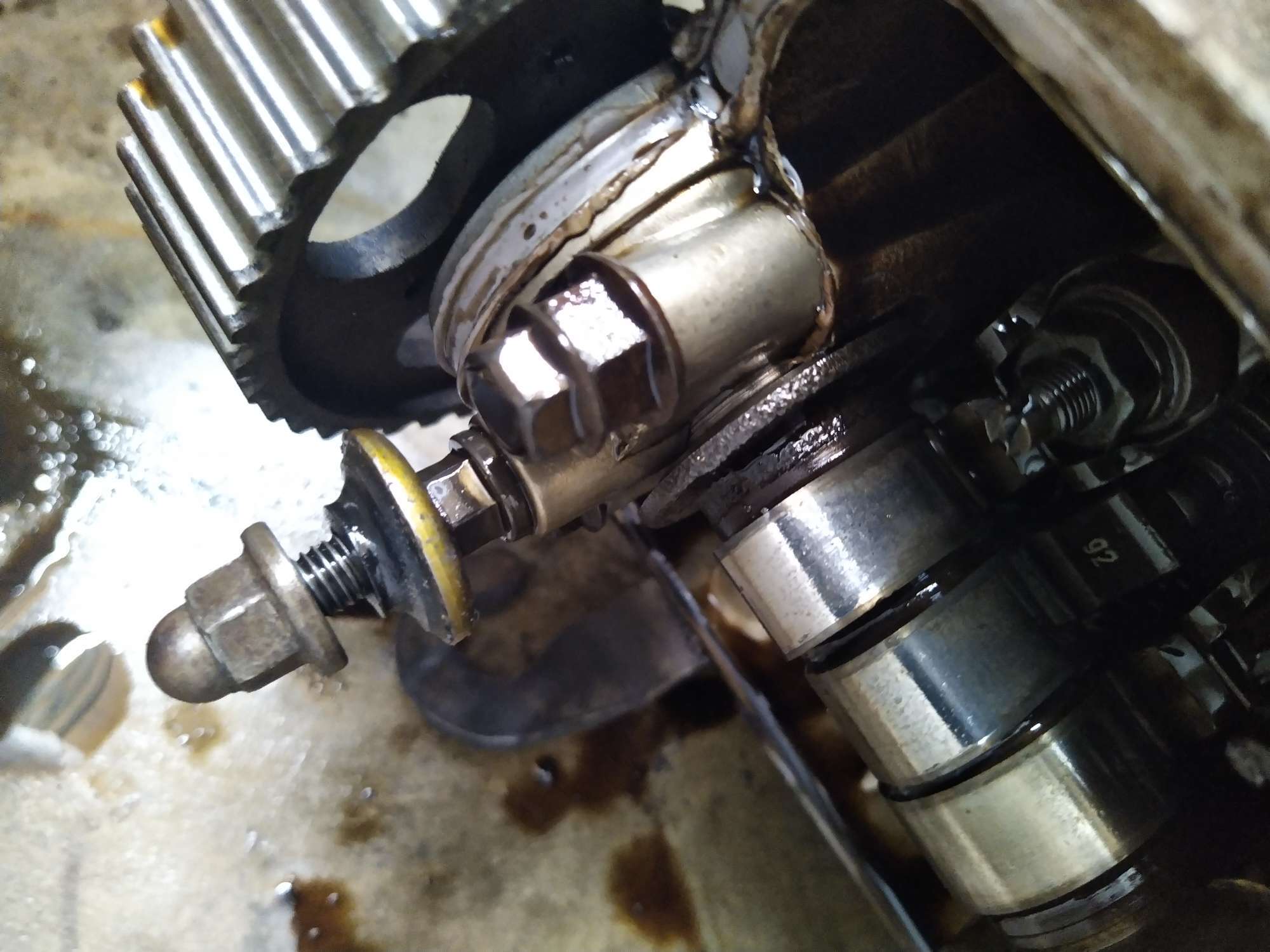

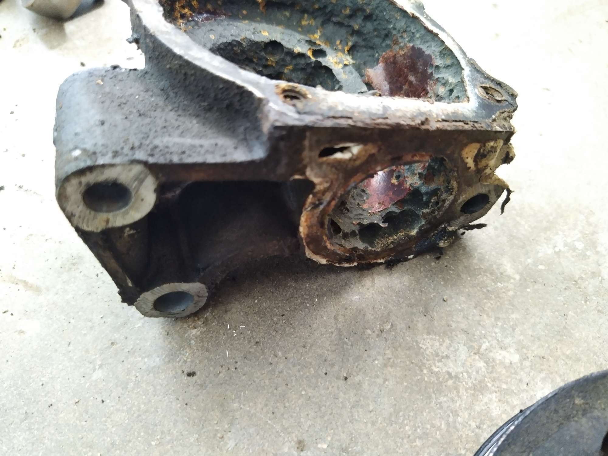

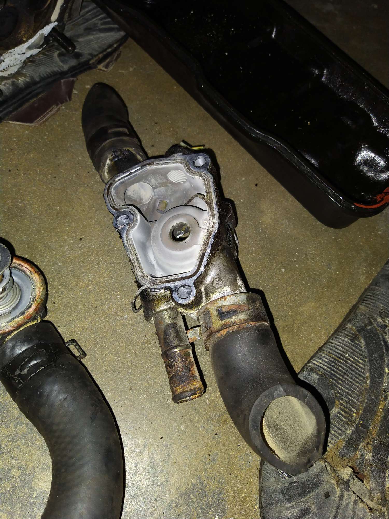

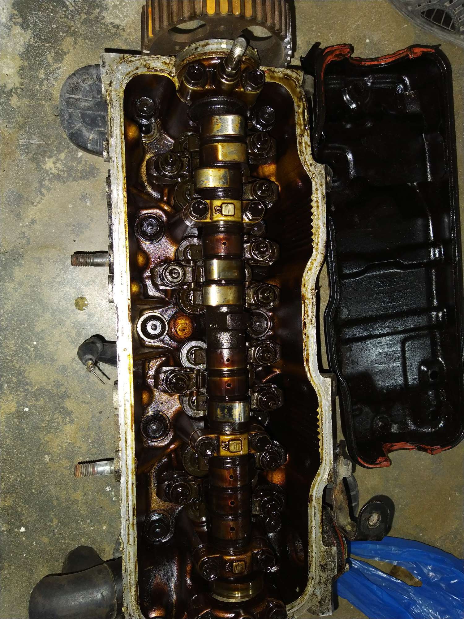

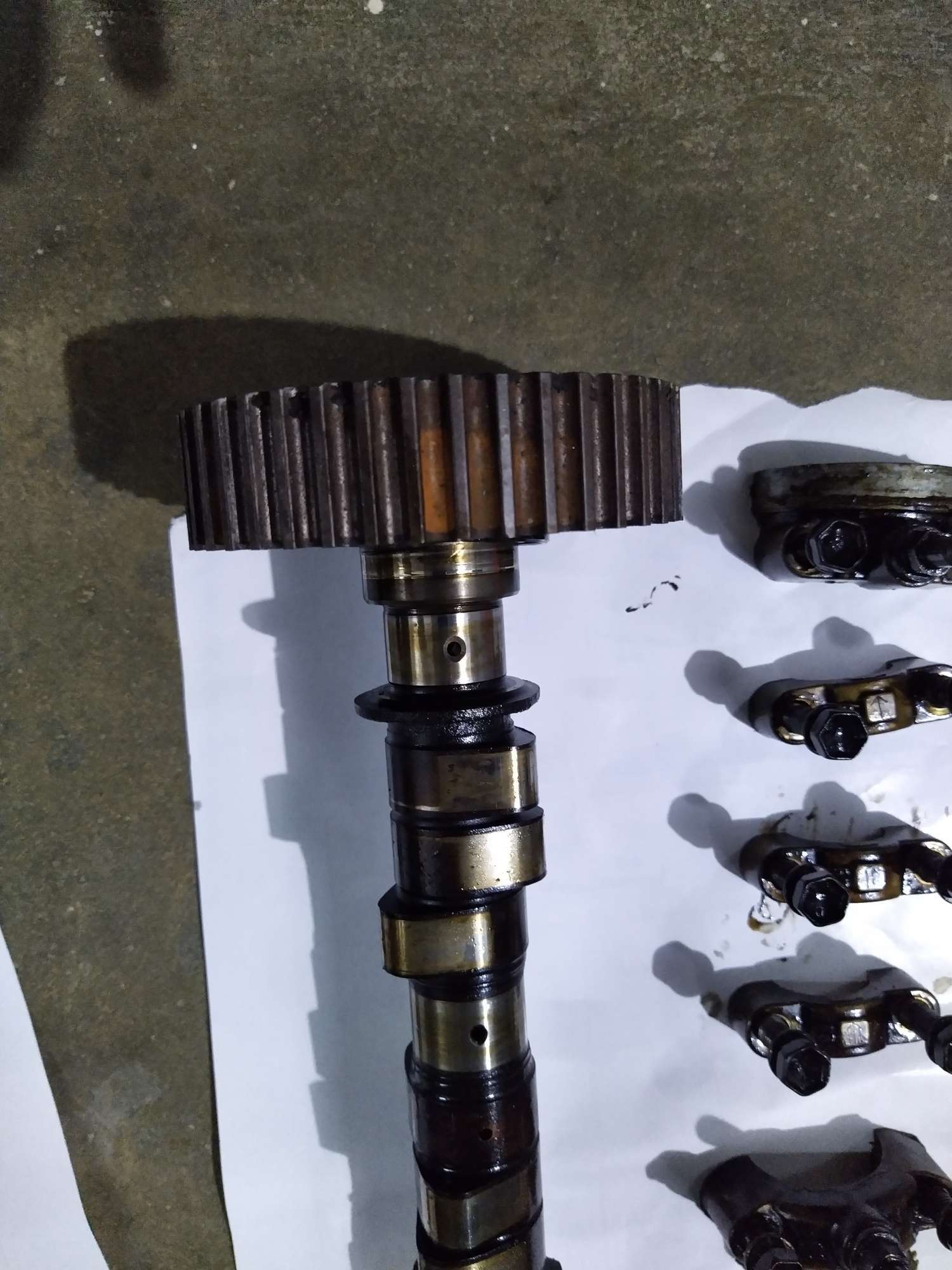

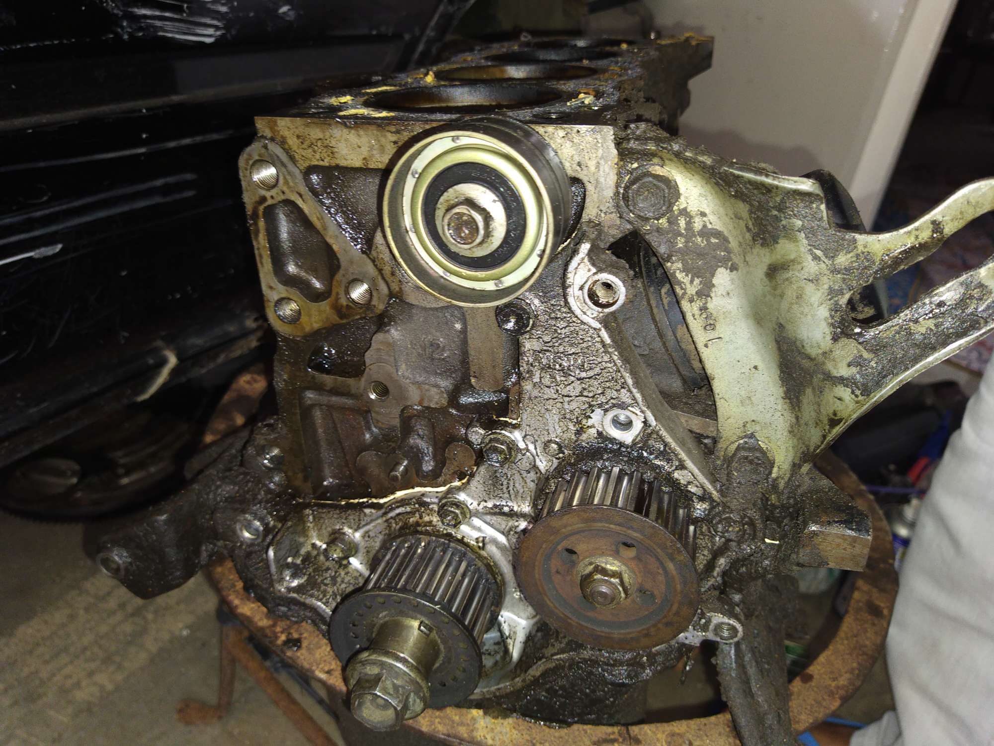

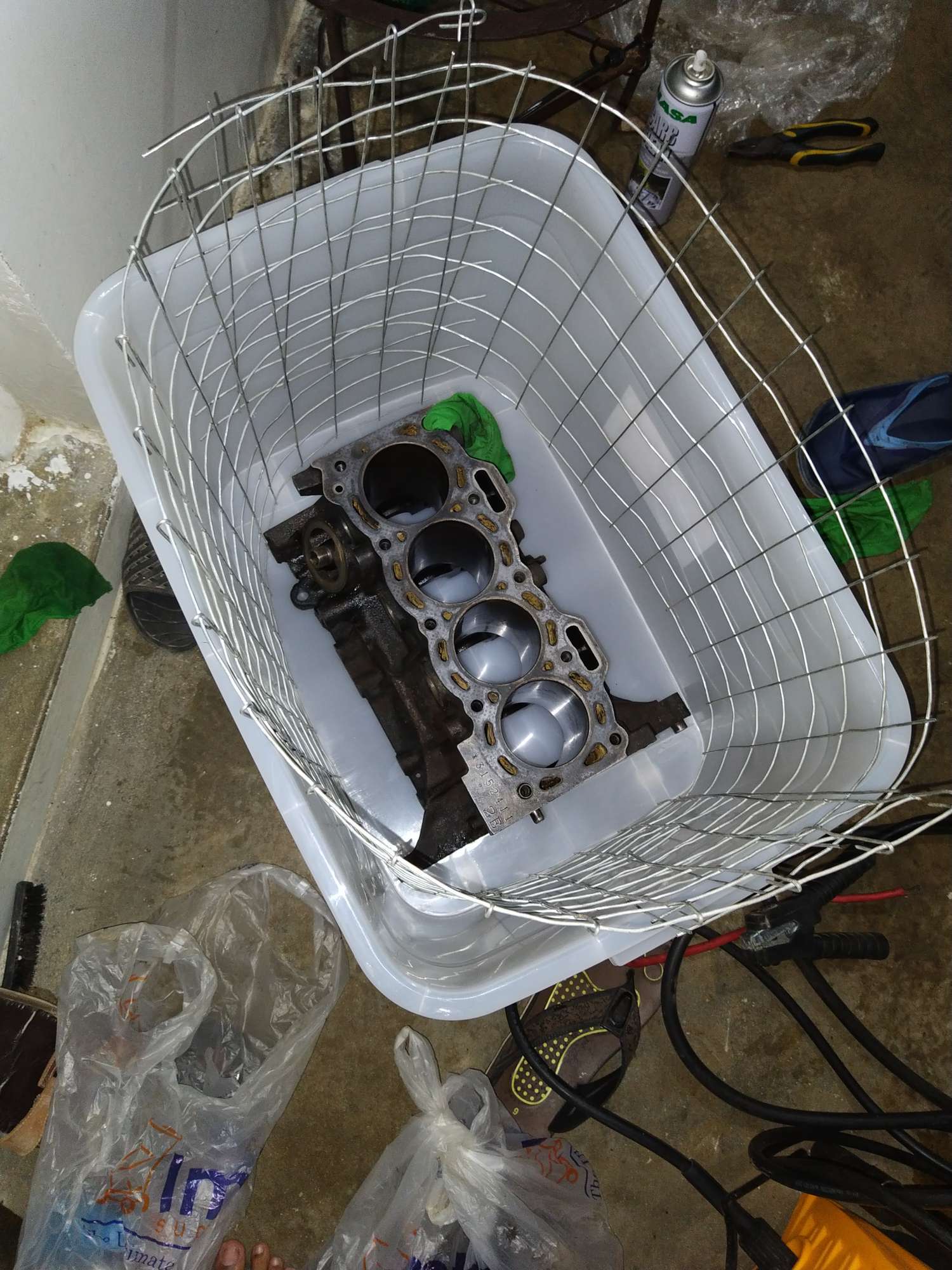

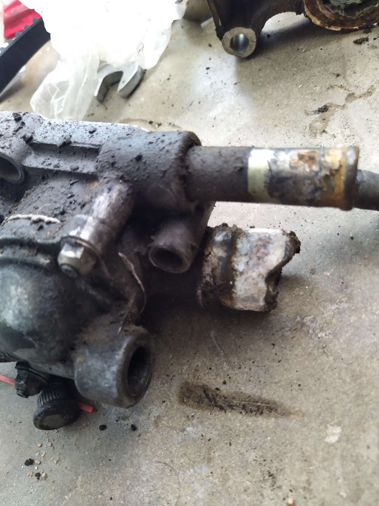

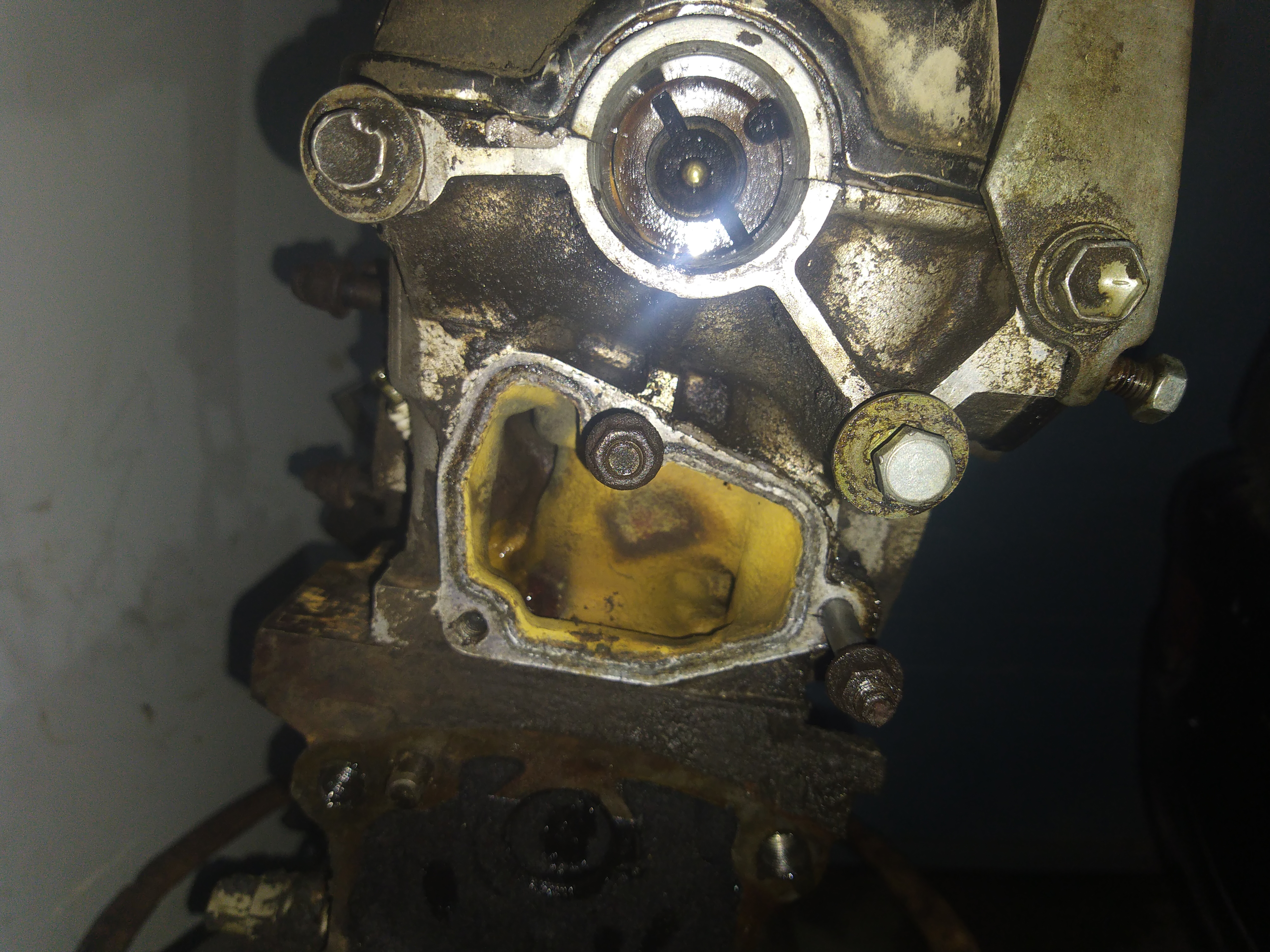

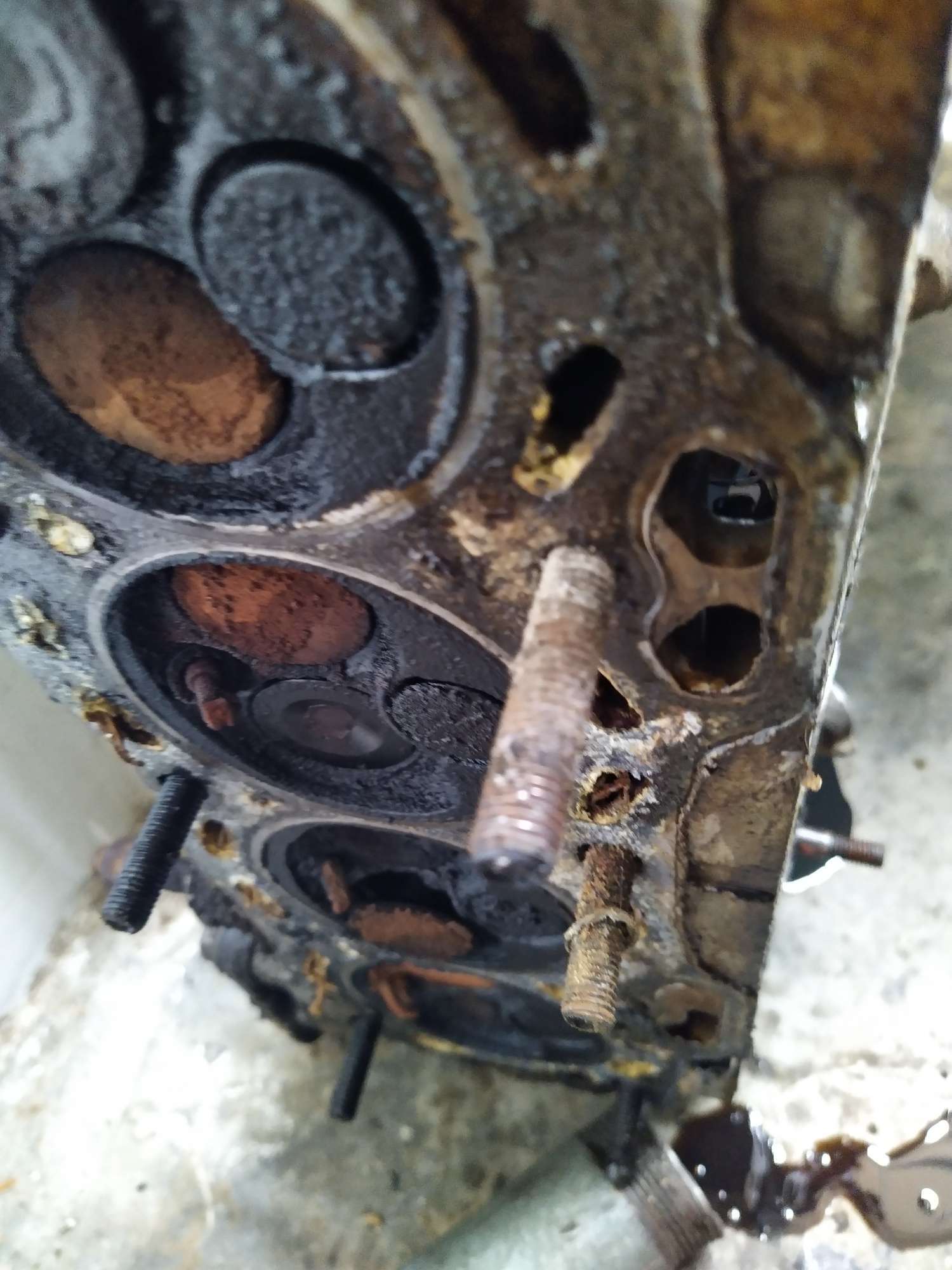

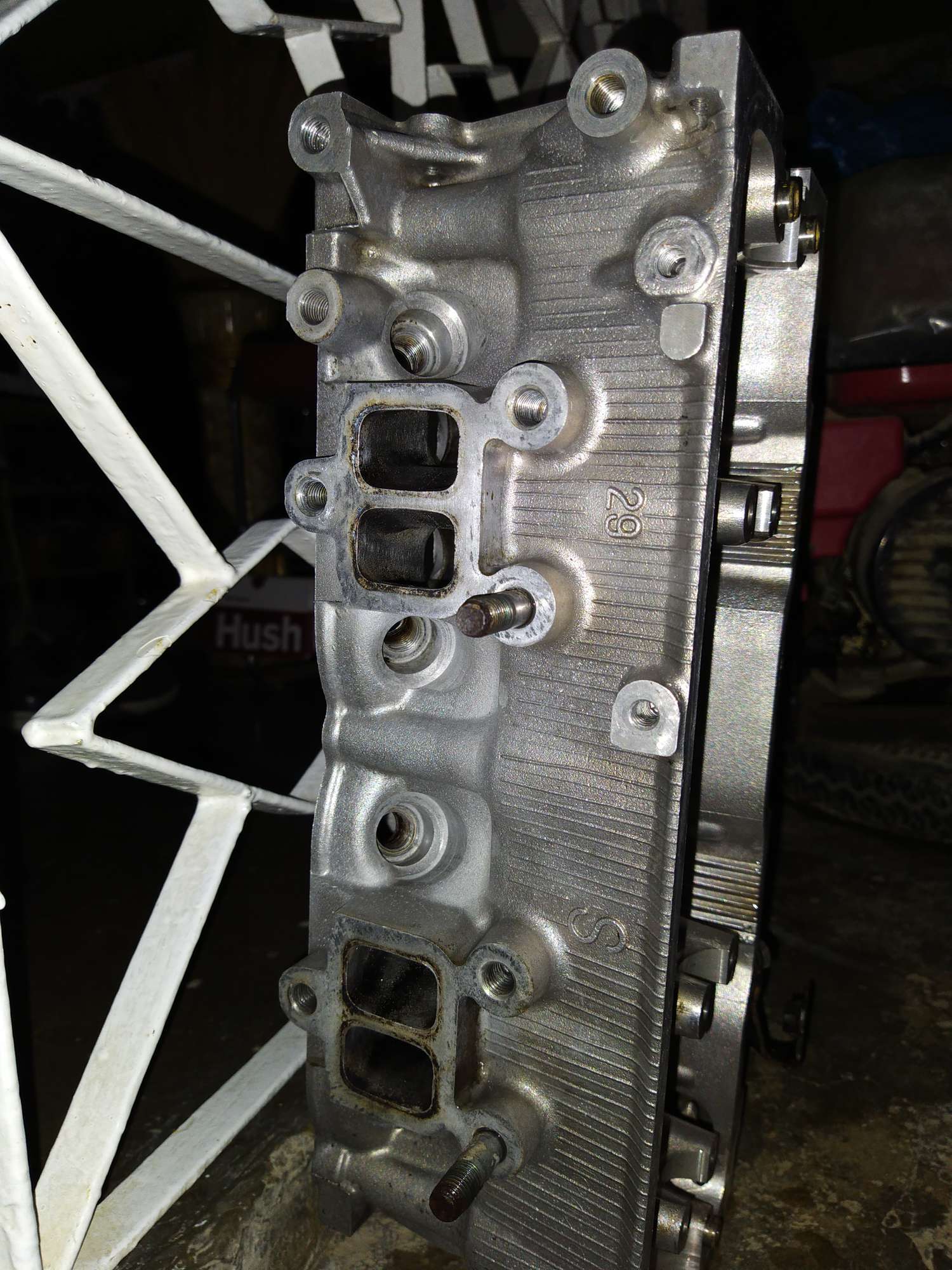

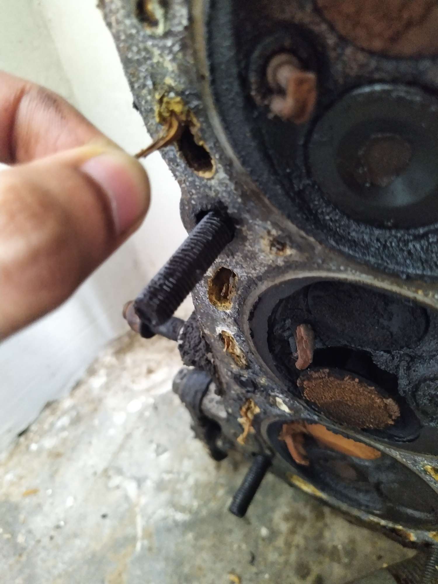

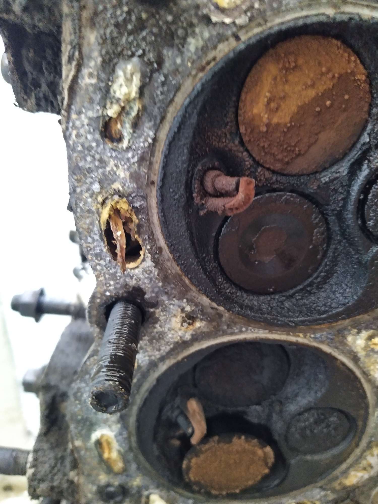

First step was multiple runs of real concentrated solution of citric acid in the cooling system (it ran on water and had rust deposits) and then the disassembly started. I will attach pictures and steps in following posts.
