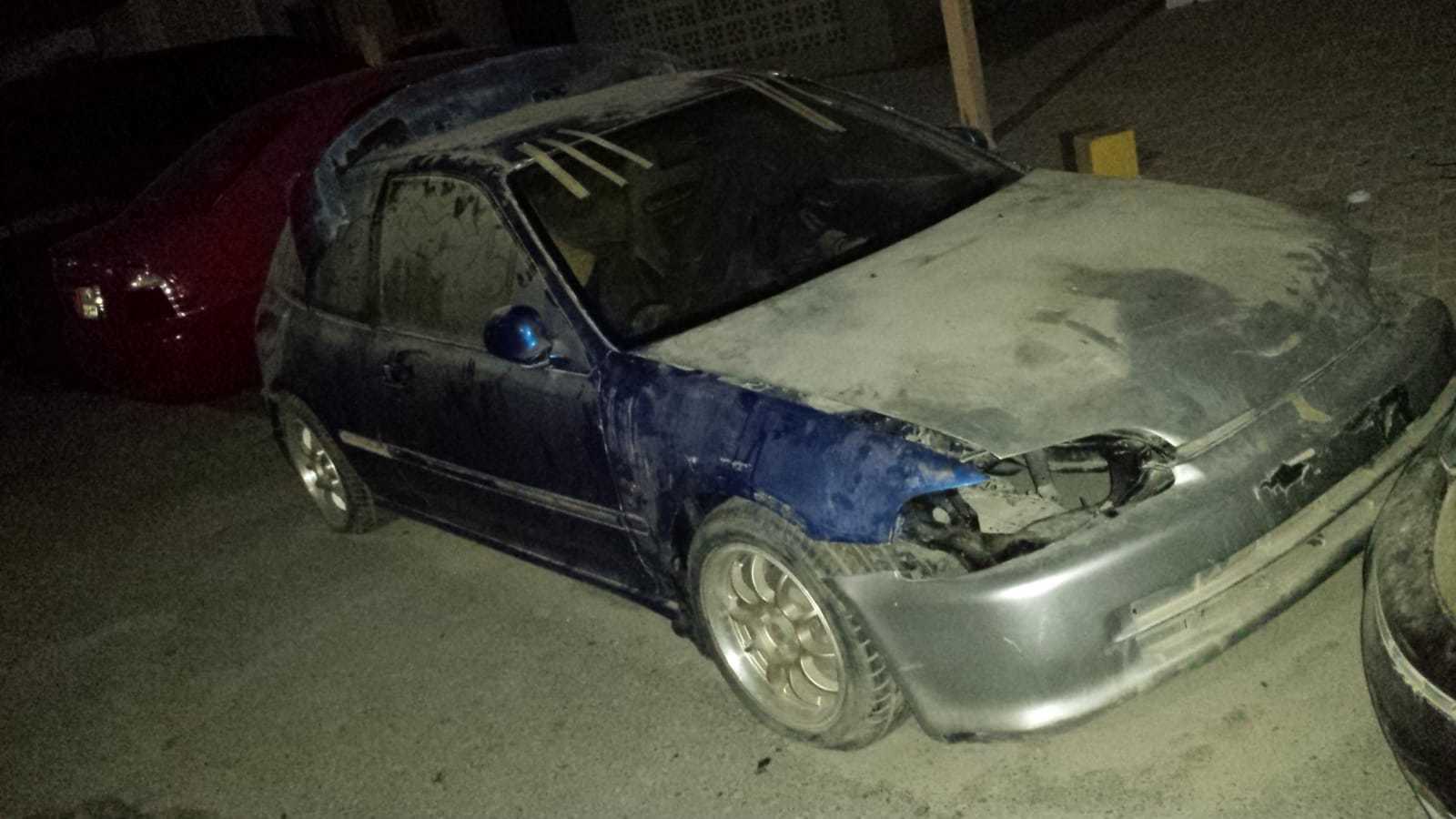

Here is the glimpse of the car i received for only 14k PKR lol in start condition.
