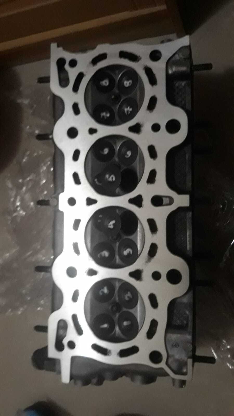

Intake and Exhaust valves set arrived ... good quality parts

Head cleaned and ready ... net to assemble it and remove the main 14 size L key flat bolt to remove any residues inside.
Top ring clearance was set at 0.009 and mine came all spot on.
2nd ring all 4 came out to be 0.014 and all 4 oil rings got 0.018
