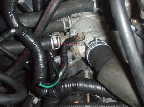

- Condenser fan's plug disconnected (so it may not start with the engine)
