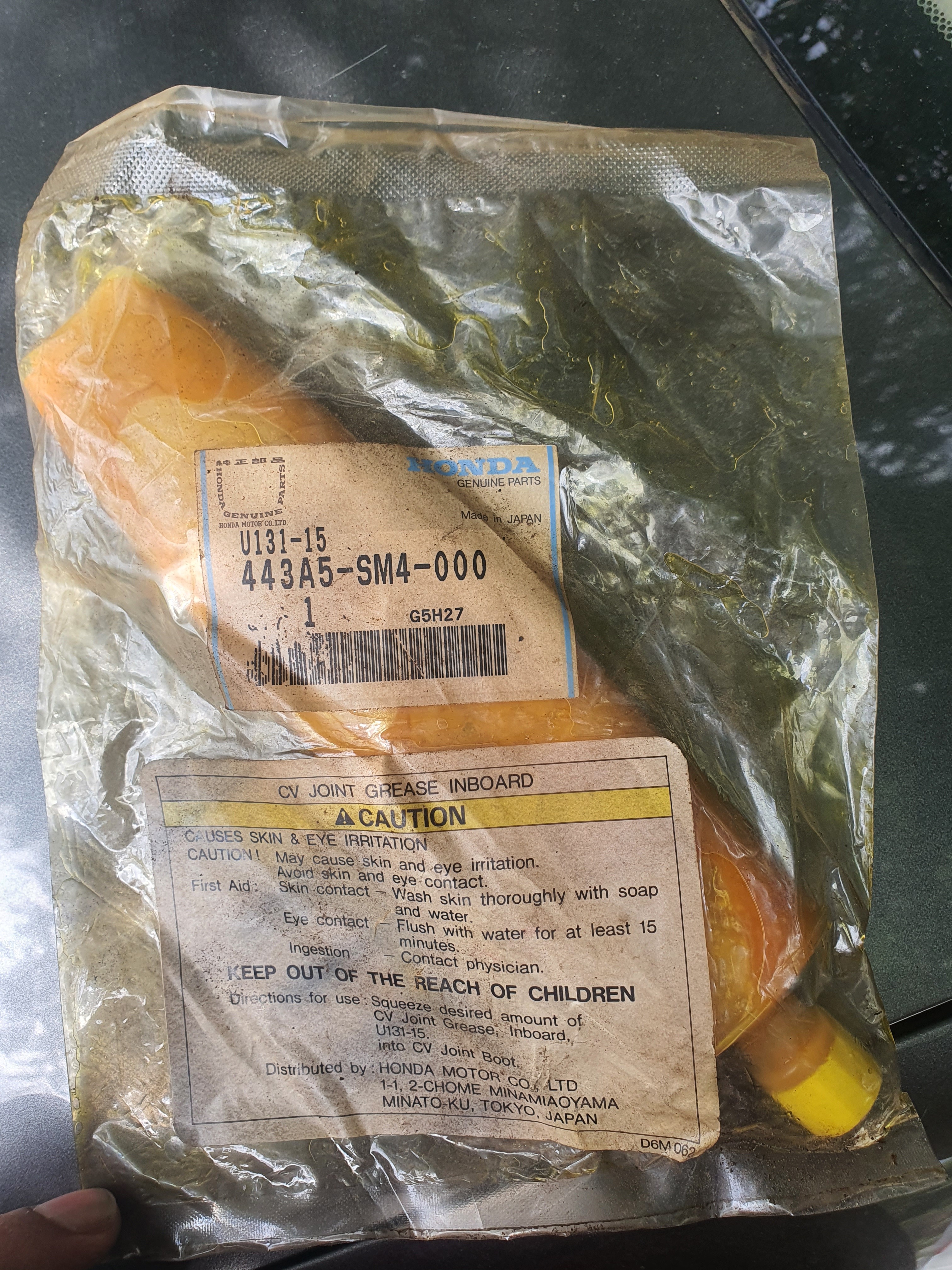

When you buy a cv boot repair kit from toyota, it comes with 5 clamps, 2 boots, and 3 or 4 packets of grease
The inner joint grease is yellow and slightly semi solid, the outer grease is black and a bit stiffer,
IMC also sell the repair kits for corolla but you wont like the price, they sell for equal to usd 70 for one axle
Honda also sell this yellow grease for inner tulip joint and black for rzeppa cv joint
