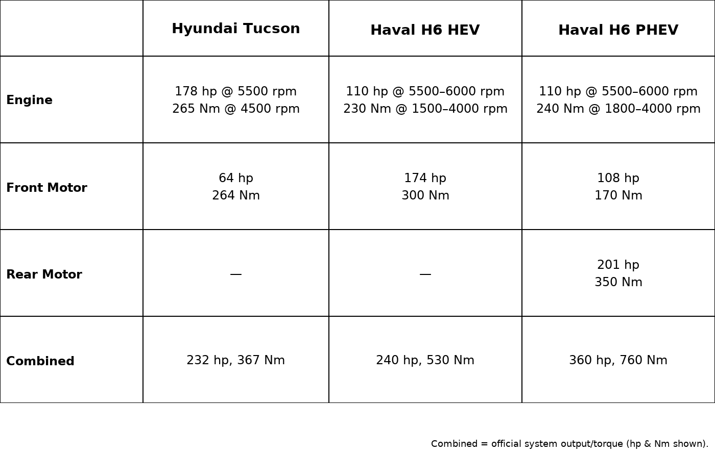

The H6 HEV already works this way with an even smaller battery pack
And I've never heard of (or experienced) any performance issues. So the H6 PHEV is more than capable of sustaining bursts of power even after it drops from EV mode because it still has about 25% larger reserve battery to work with that can power the front or rear motor when needed.
Edit: Btw I didn't have enough time to play with the vehicle settings at the dealership today but it seemed like you can set a limit for the minimum battery level after which it switches to HEV mode (unless I completely misunderstood that menu).
So in theory, if you really want to have lots of reserve battery, you can set it to like 50% and it would start behaving like an HEV after that point.
