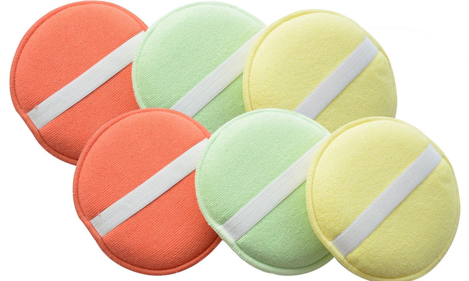

Find a good sponge/applicator
Buy an applicator for applying the wax. Usually, all the waxes available in the market have a sponge with them but if your wax doesn’t come with any sponge, buy a small sized foam. Polyfoam wax applicators are a good bet.
Apply wax on sponge
Apply a suitable amount neither so much nor little. A suitable amount is best because the sponge moves with a flow on the car surface. Sponge with more amount of wax applied will not move continuously on the surface.
