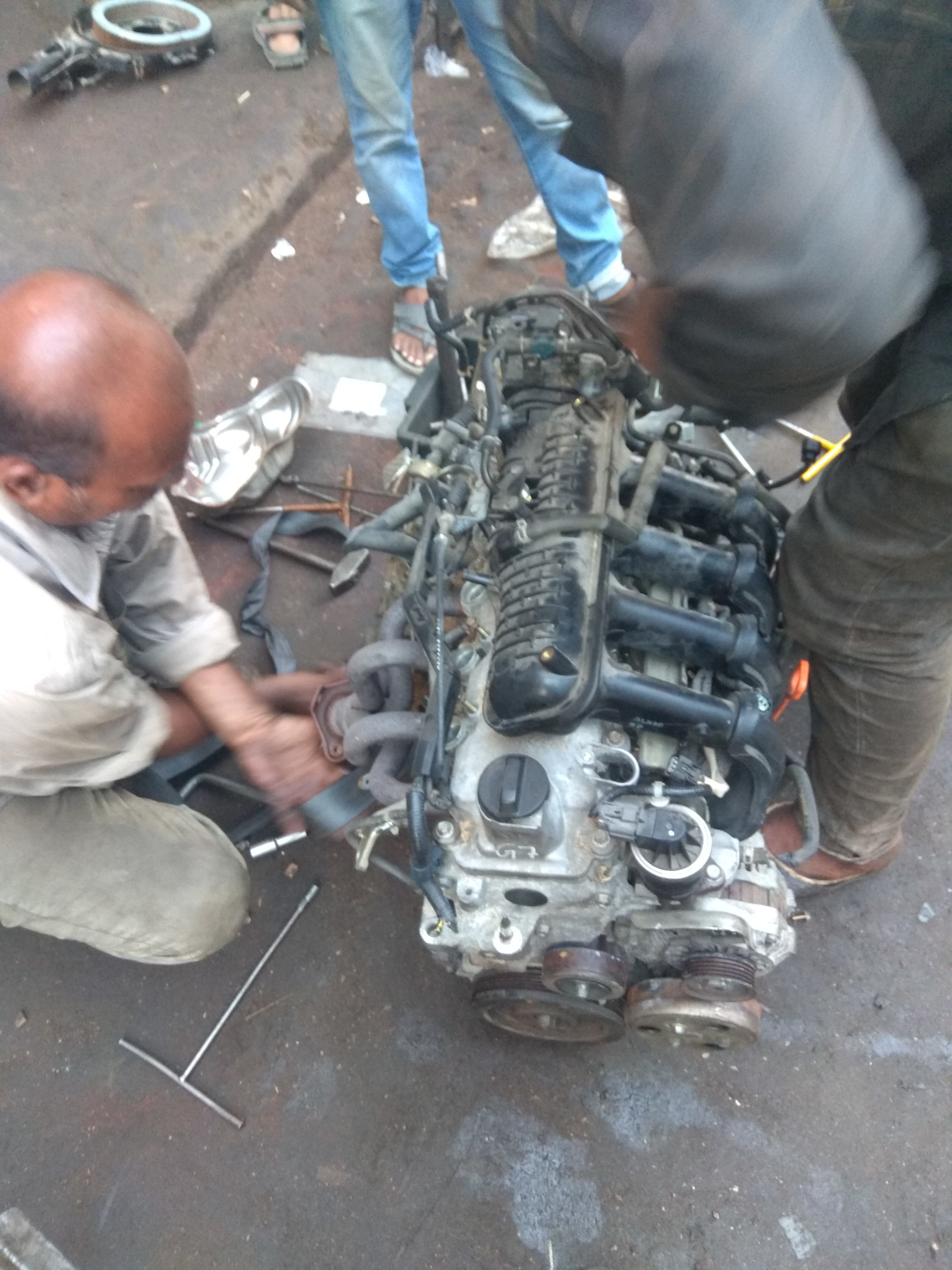

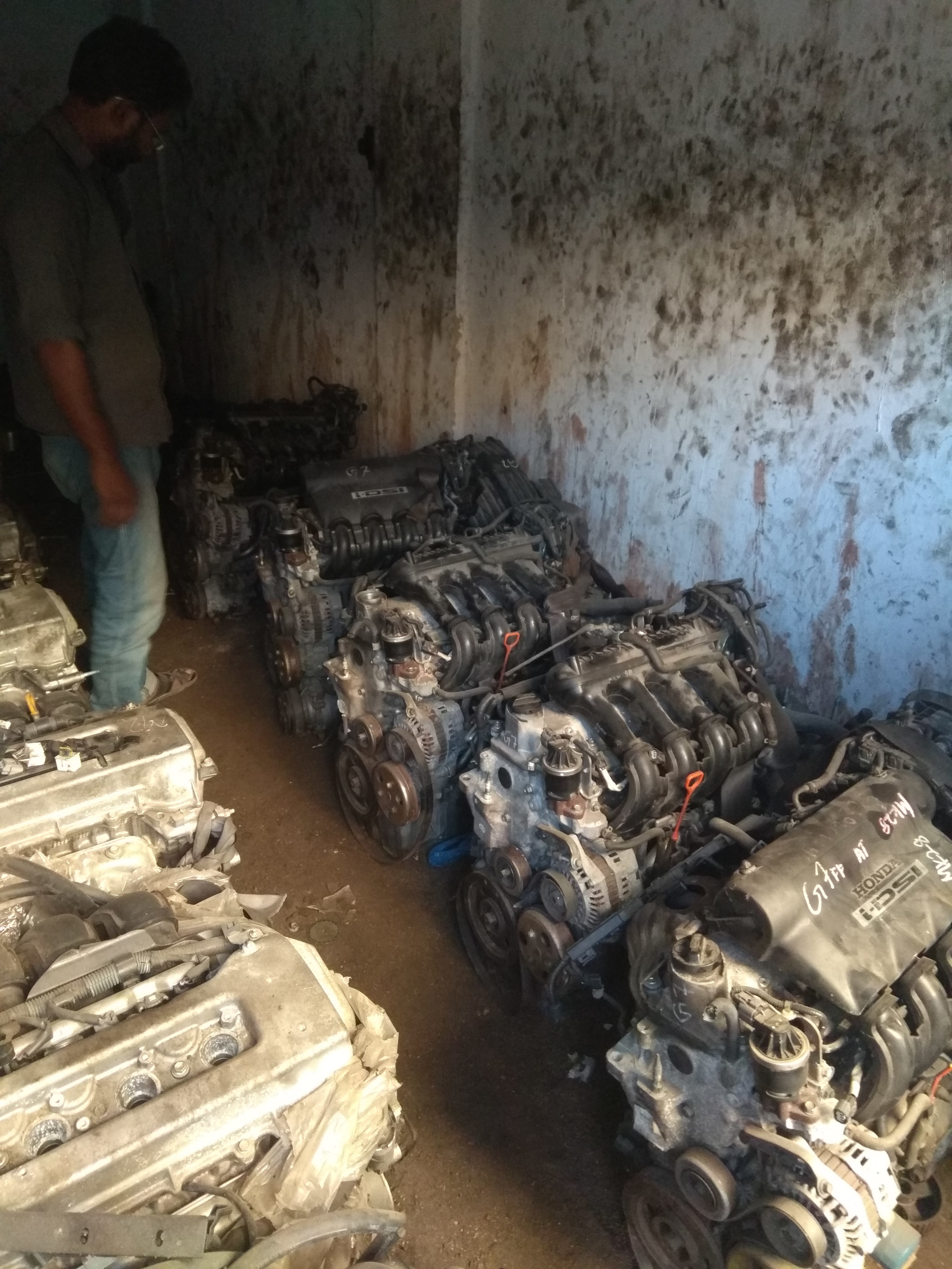

Make sure, its not physically damaged first from anywhere - then make sure the cylinders are not rusted, and before starting assembly of it, take it to a machine shop for honing the cylinders lightly so the glass mirror glaze is wiped out, That way the new rings you are going to use will seat in proper.
Clean, Clean, Clean the engine after machine shop.
