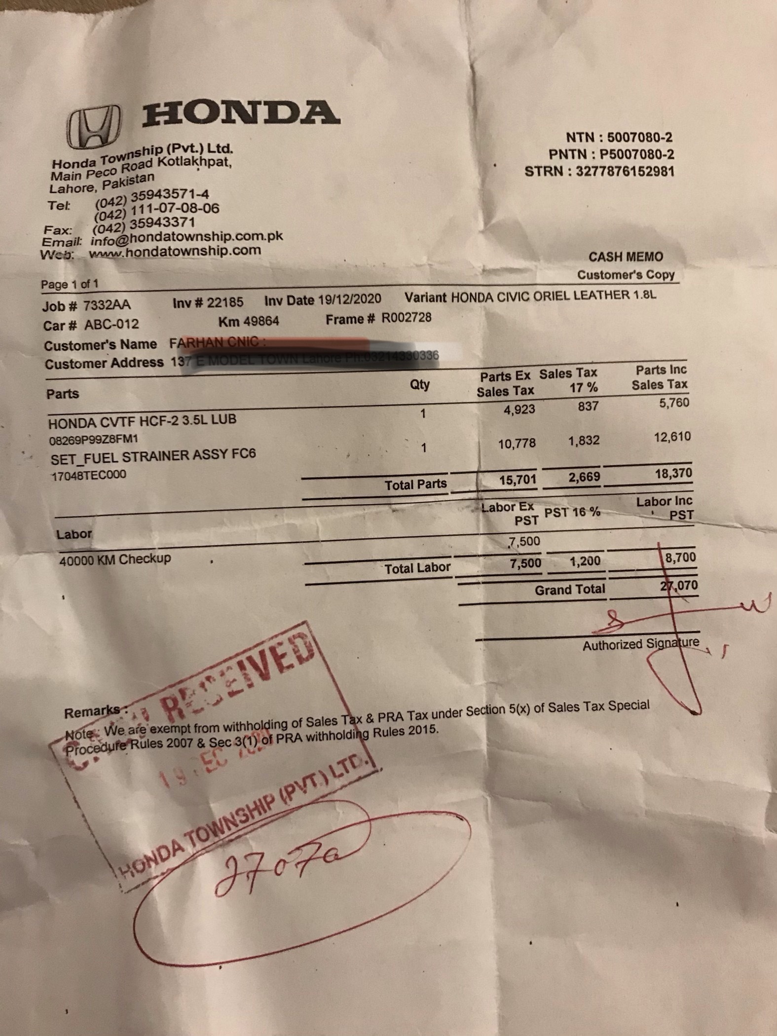

Dealership recommended tuning + Fuel filter replacement cvt oil change . And air filter 3.5 k. Seperate. Total 30.5k . Nothing solved.
Scanned through dealership . No codes detected
Good to know that no error codes were found, but charges seem huge.

Honda fort supervisors checked the plugs but didn’t insist on changing. Unable to diagnose. Owner must have perfect knowledge. Otherwise dealerships will rip you apart. Such incompetent. Honda provided them with inadequate training.
You got replaced the Fuel filter, CVT oil, and Air filter. Still problem persisted. Were these really bad or just hit and trial done by Honda 3S?
If latter is the case, then perhaps they don't know anything about this car.
