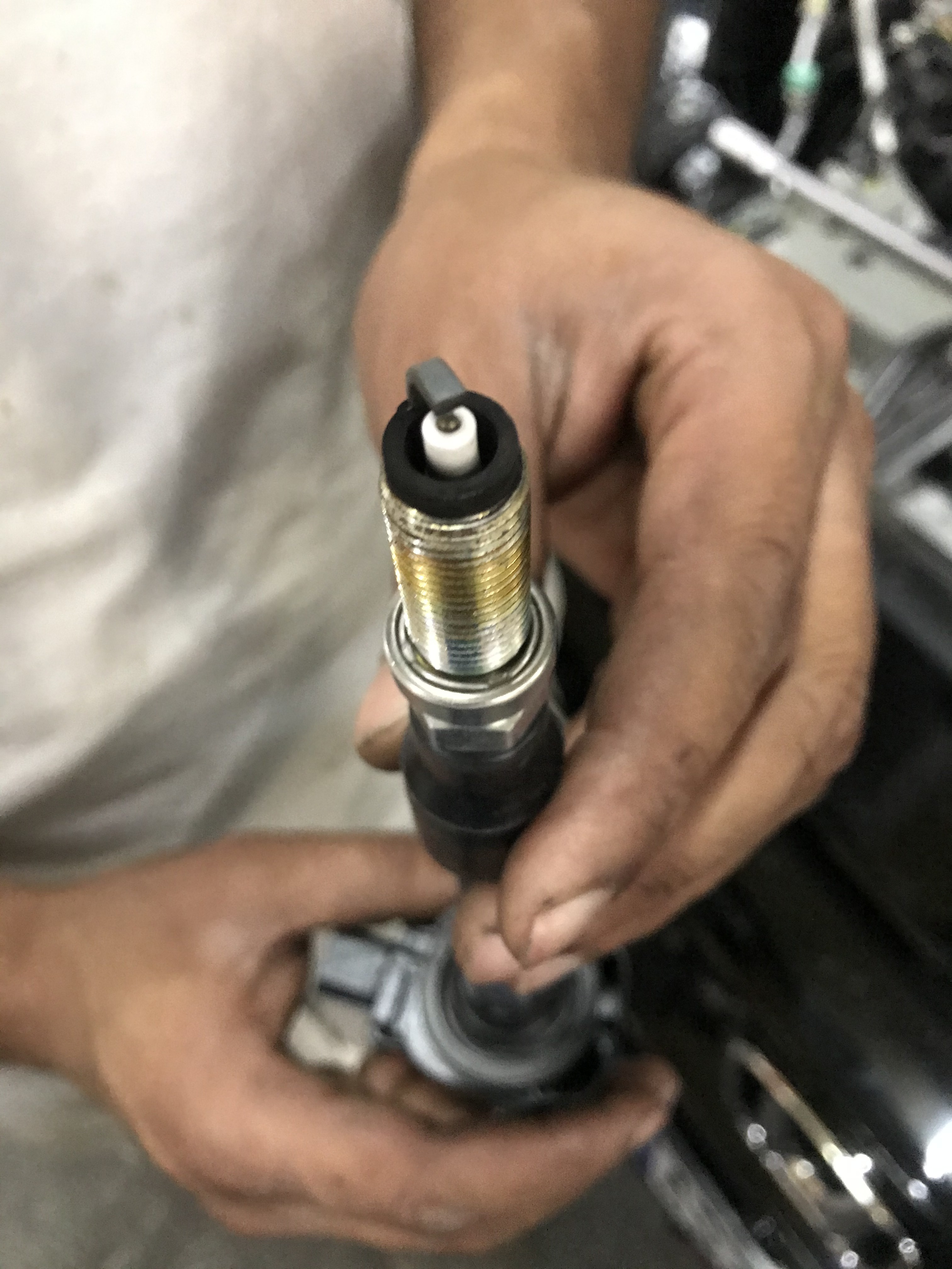

Due to MMT the spark plugs which theoretically should last till 80k to 100k kms used to fail prematurely at around 16 to 25k kms due to mmt.....
It can be experienced by pulling the car till top end speed on safe road like Motorway / ring road. You will find car will not go past 170 / 180 kms .... you will feel it stalls at 180....
@asadnaeem1 i had done borescopy and compression test at that time, different people suggesting diff hit and trial methods but some tuner friends advised me that the car is new so just change the spark plugs which ultimately found to be the culprit.
These precious metal spark plugs shows up at high rpm , high load conditions,
I have June 2017 Turbo, its 1st set last 18000 kms whereas the 2nd set lasts around 30k (ran around 5k on Euro 5). Recently on the 3rd set since 2000kms
I have found the plugs less orangish and more greyish black after Euro 5 fuel so i hope they will give a good life.
