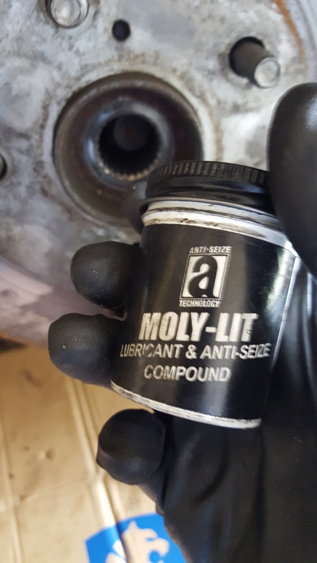

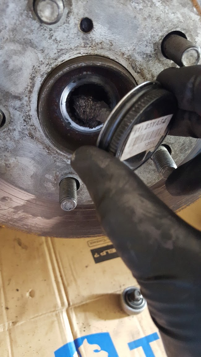

I bundle all other jobs together into one, e.g. I recently put it on jacks to service its transmission, I also pulled out its axles and replaced the CV joint boots and grease with new genuine items as they were old and crispy. To remove its CV axles you need to undo the balljoints - I replaced them too with brand new greasable parts as I found them a bit sloppy (320,000 kms).

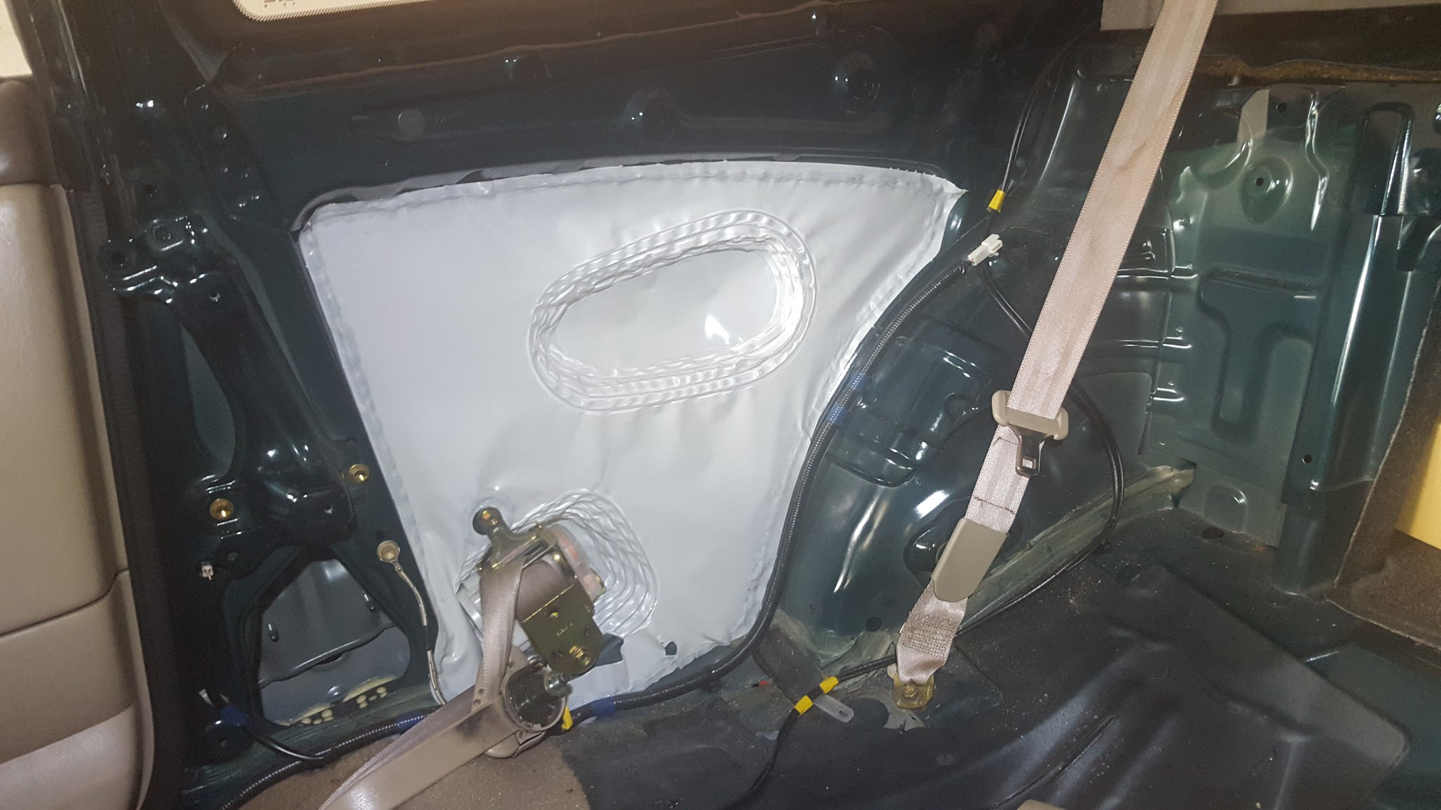

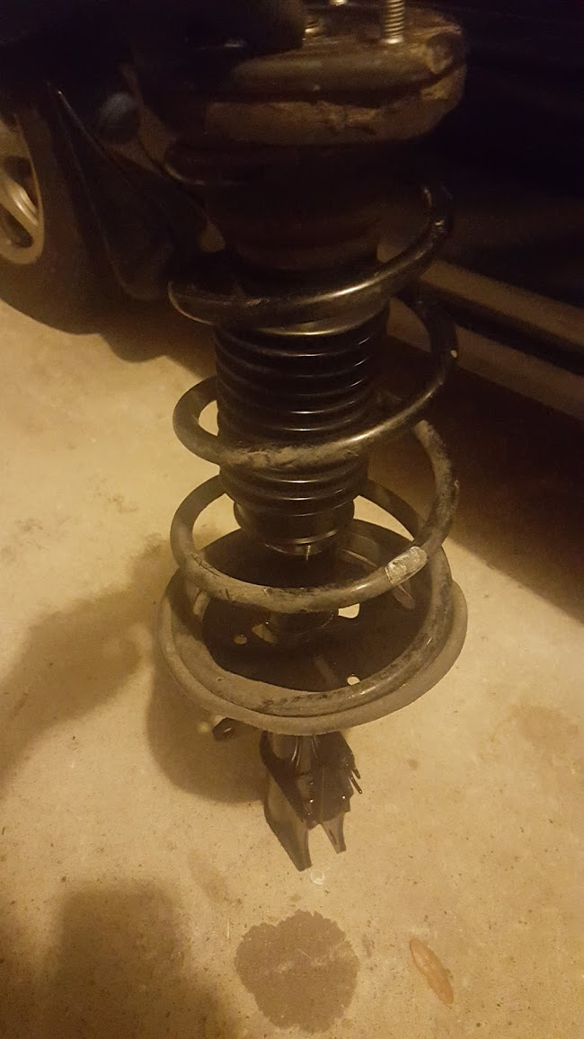

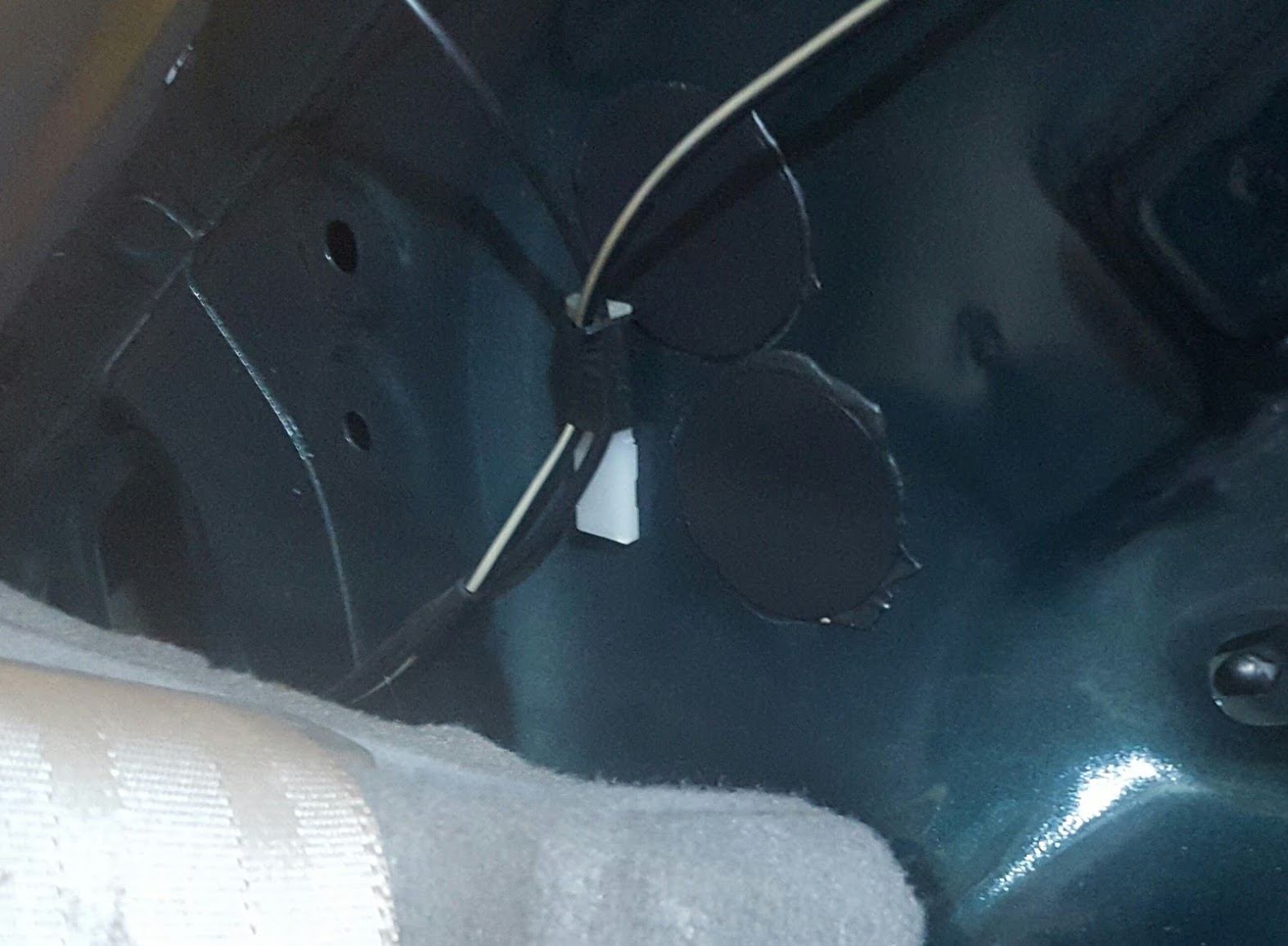

Similarly when I tore out the rear struts for replacement (blown out) I replaced all 4 antiroll bar linkages. I also repatched the holes in the interior and redid the vapour barriers as the barrier and patches had fallen off.

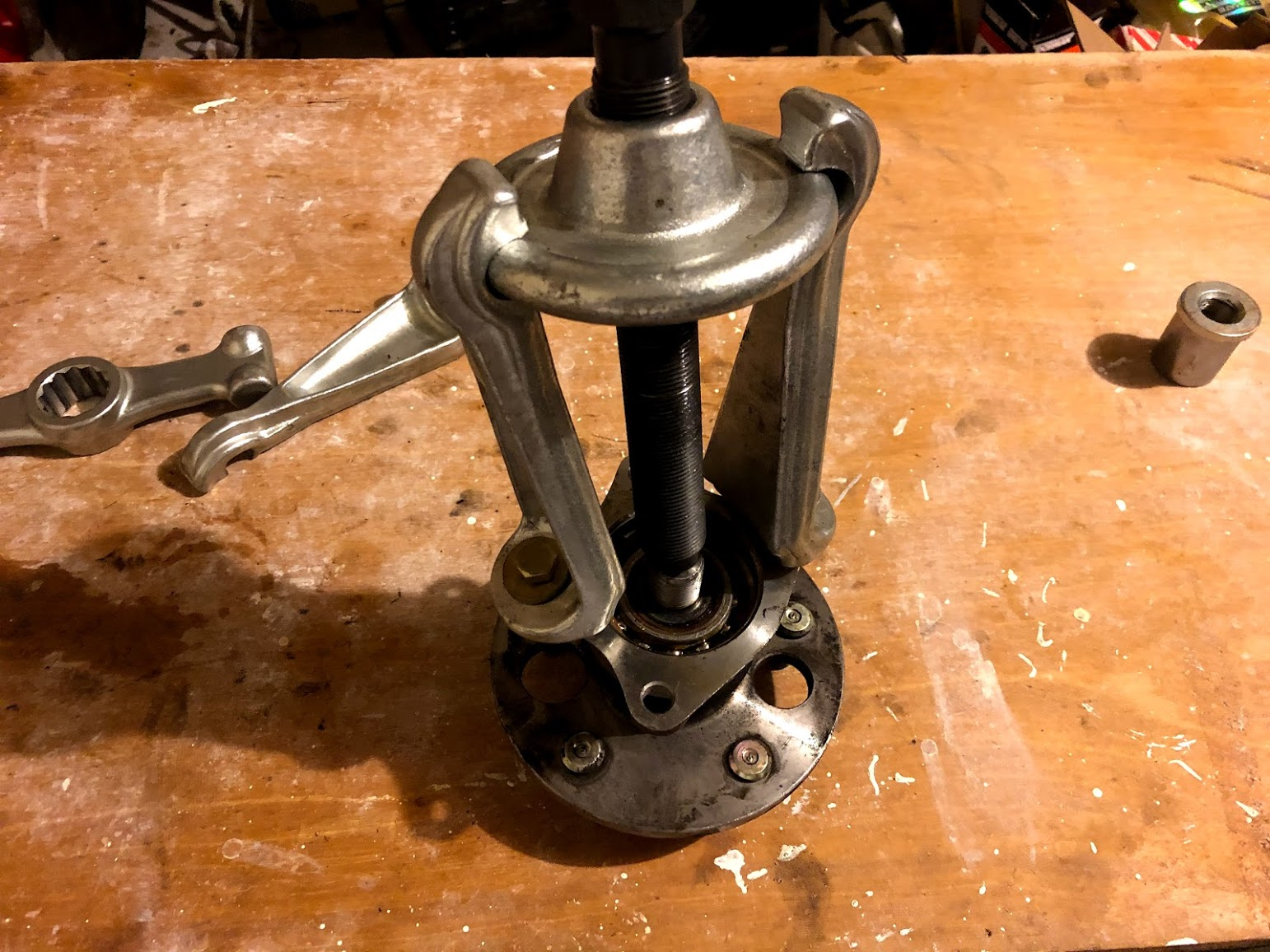

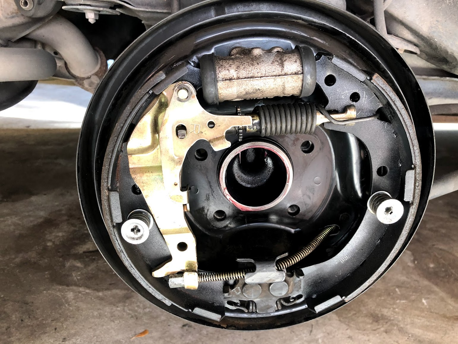

Similarly when I did a brake job (new rear shoes) - I replaced both bearings too. Fronts will get replaced with next set of disc pads and rotors. I further went deep and disassembled the new bearings to pack with very high quality grease because the bearings were not genuine toyota but NSK replacements.
