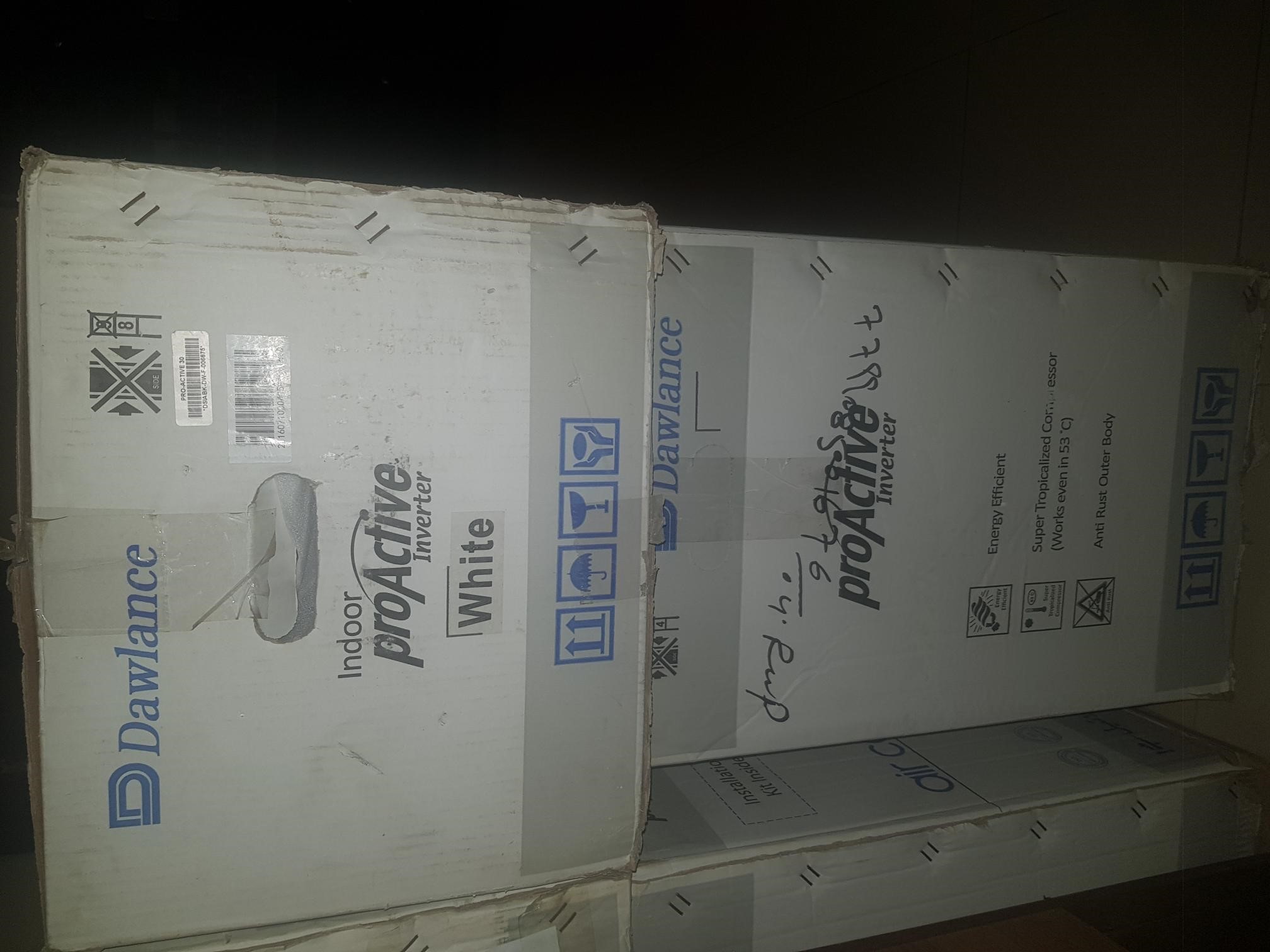

A new unit at my relative's house, they got it installed in last winter. Now when it was required to use the AC for the first time, they came to know that the AC is not cooling at all despite the fact that everything is apparently working.
