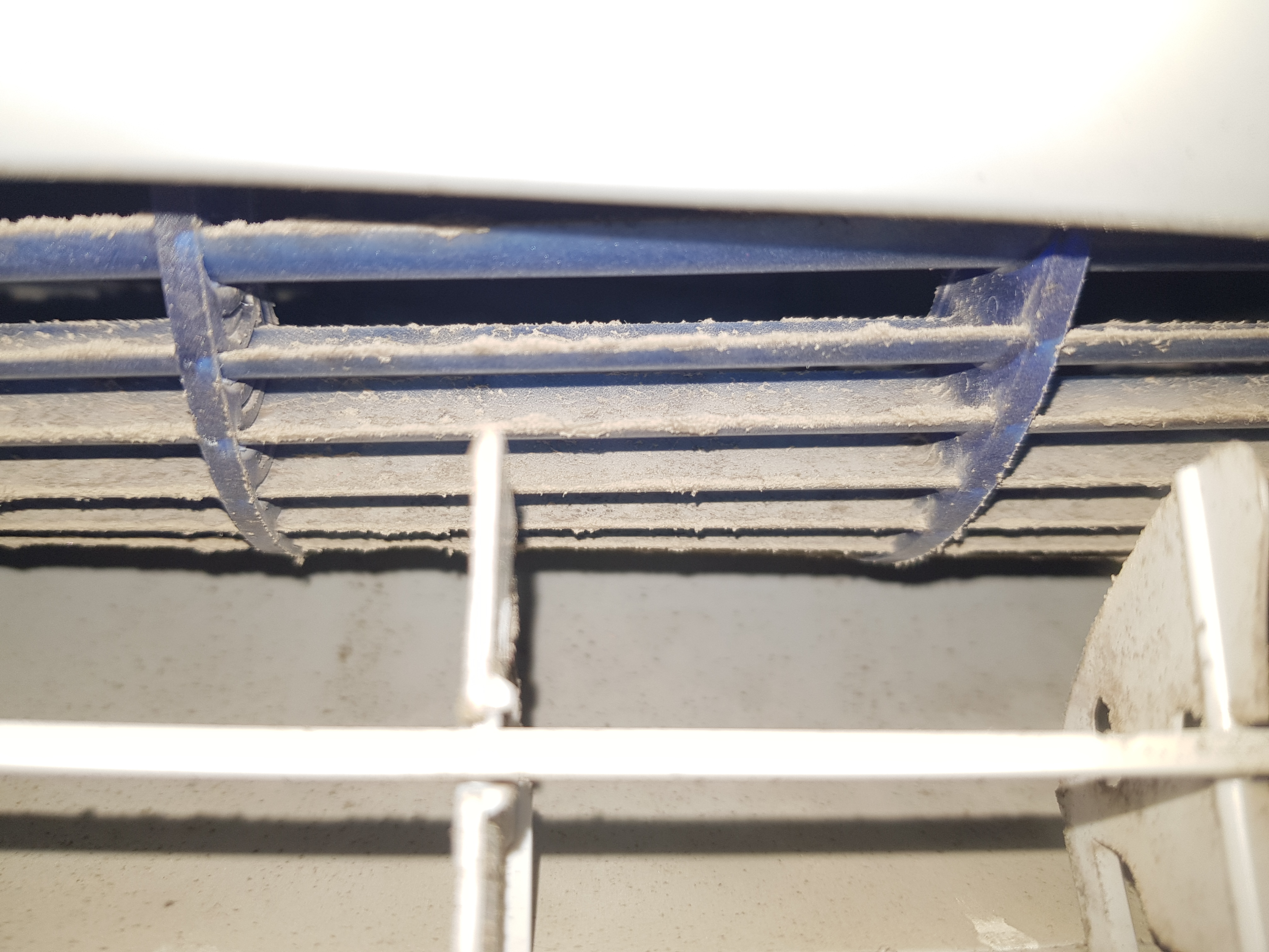

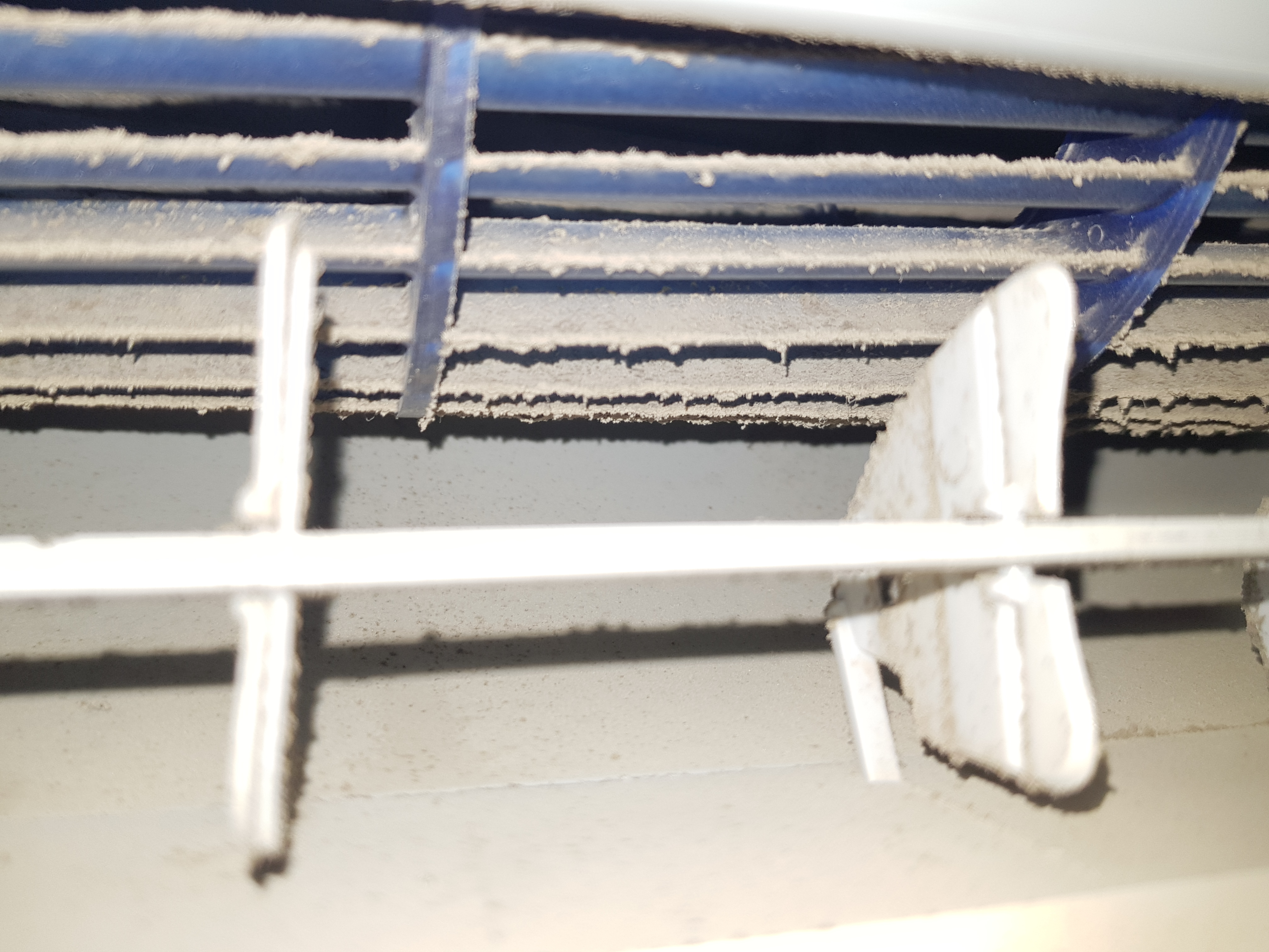

Upon inspection, there was sort of fungal/mould accumulation on the blower fan, though evaporator wasn't that bad or choked. Blower was the main culprit for foul smell.

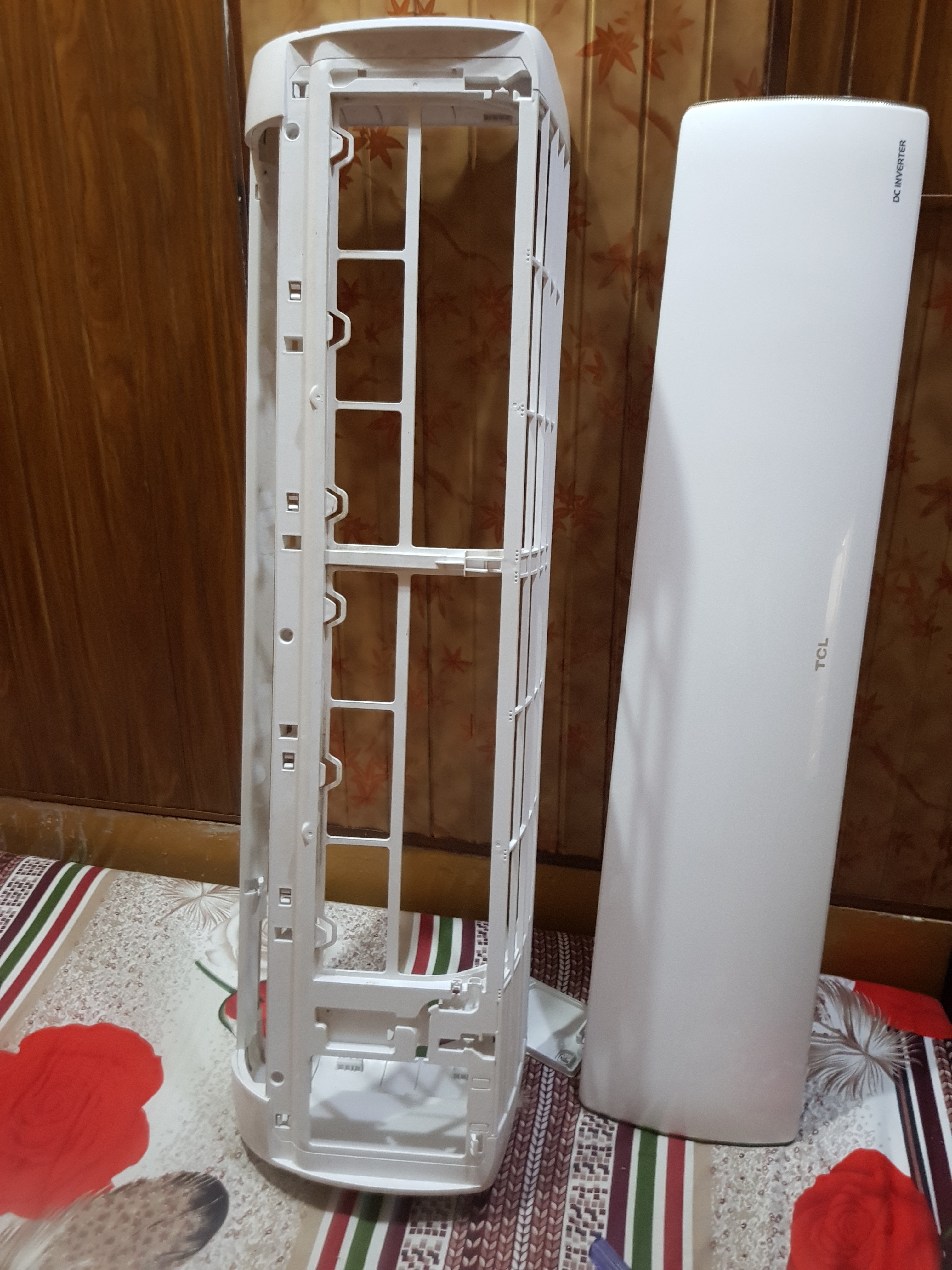

I removed the top covers & casing along with fins carefully as it was my first time, it was easy job khair. Covered the circuit board with plastic bags.
And Hit that dirty mouldy blower fan with medium pressure settings. Alot of dark black grimy & mouldy water came out of drain pipe.
All these are BEFORE pics, didn't took aftershots as aftar time was approaching.
