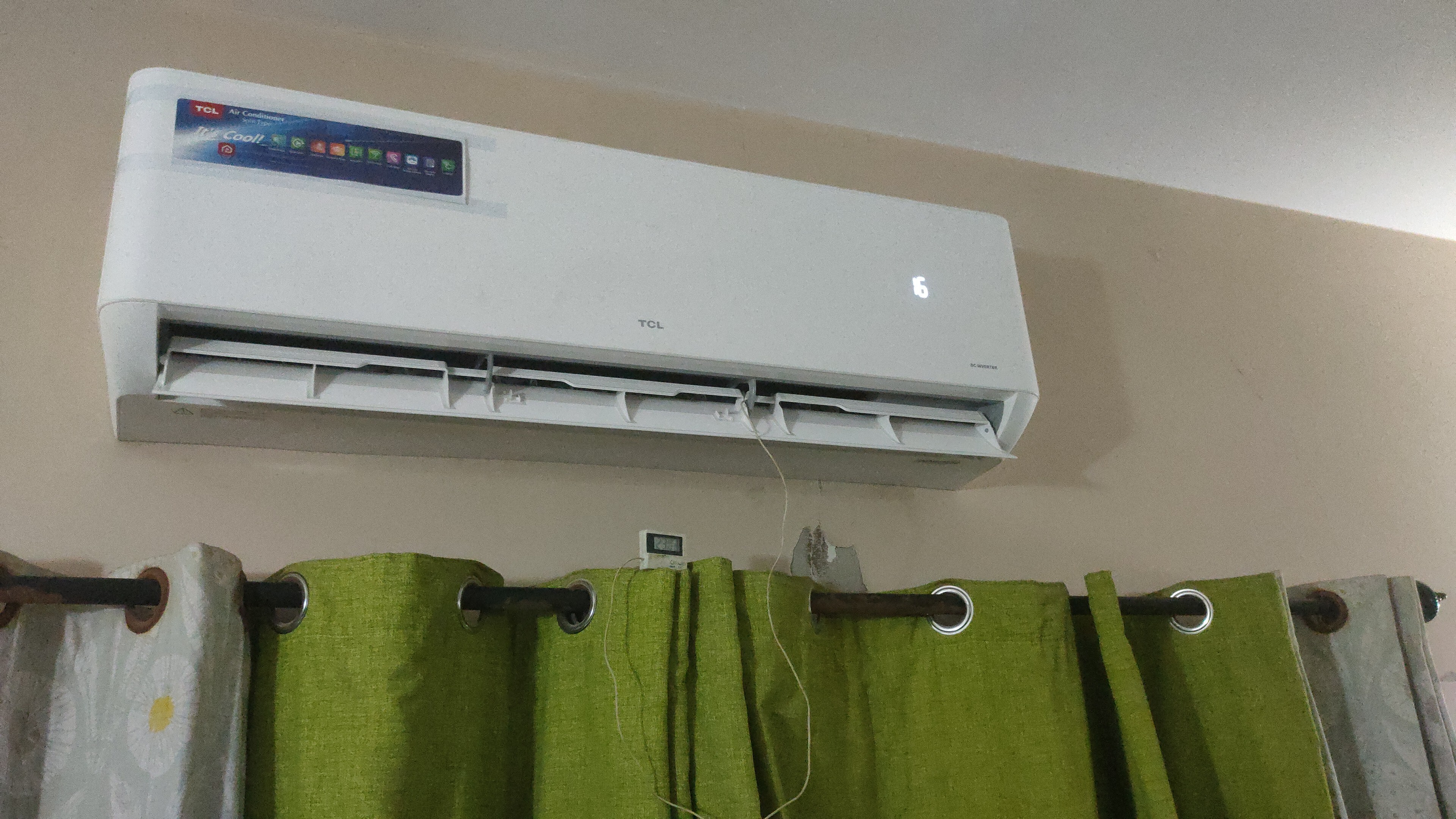

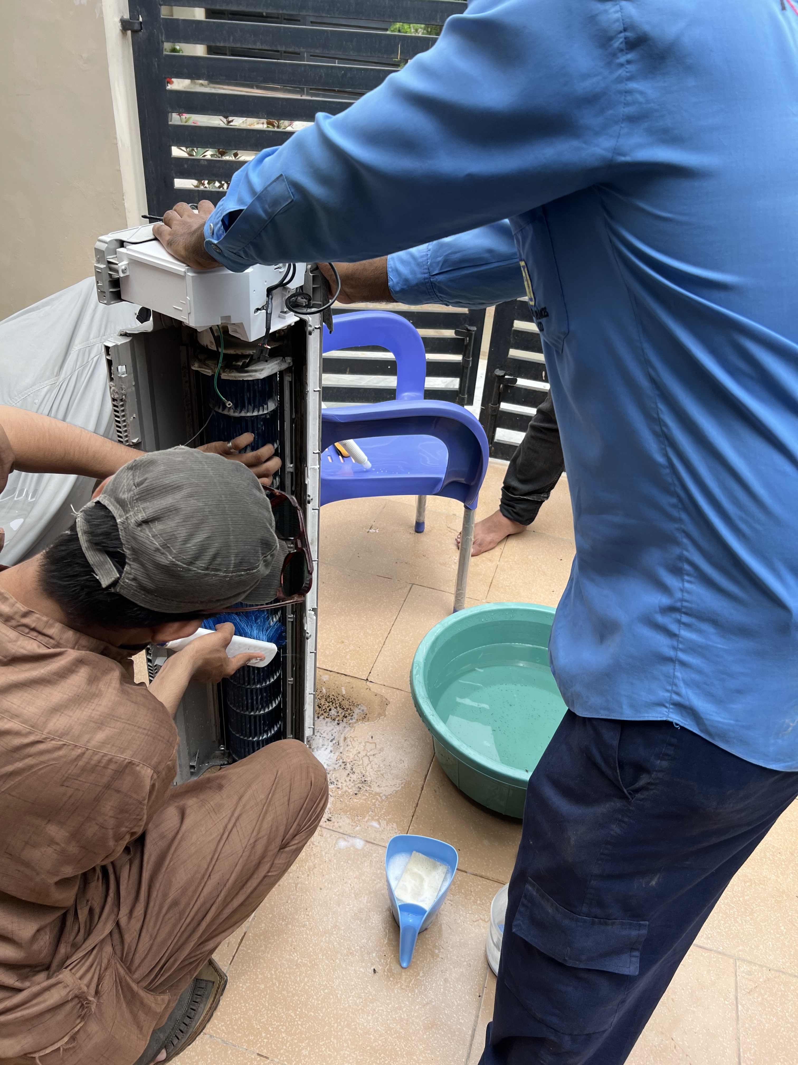

As I lodged complain around 6pm and the Kenwood technician (to my surprise) hopped in @ 11am in the morning.
Checked the:

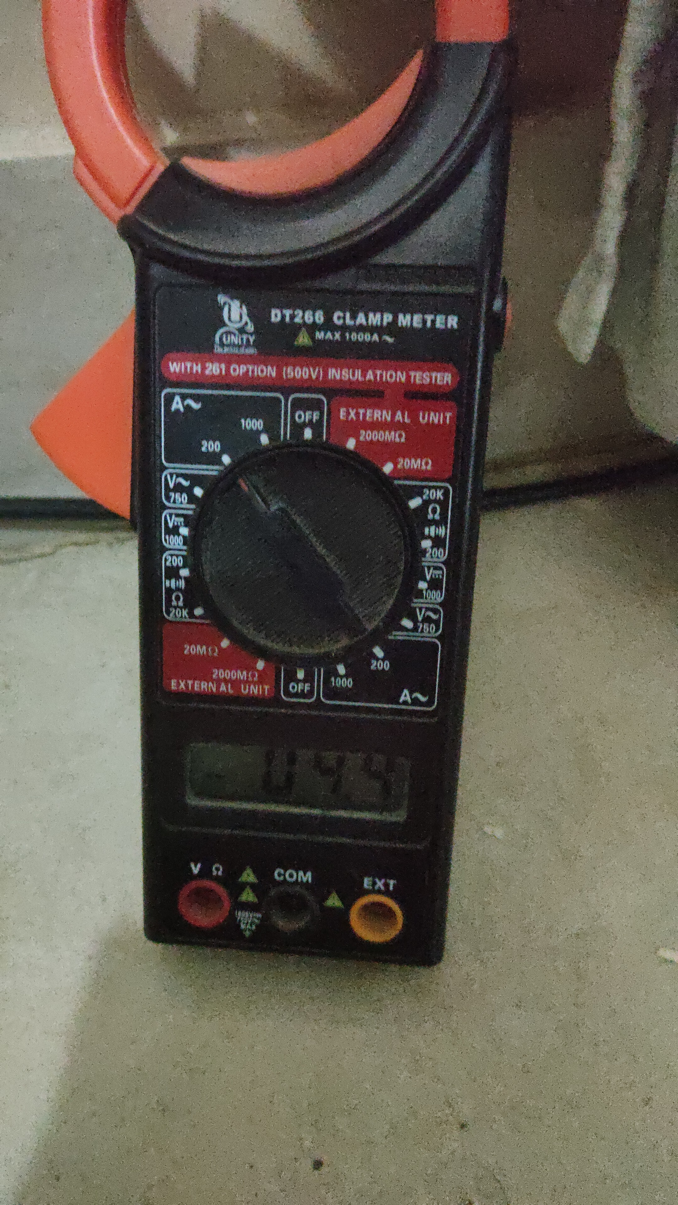

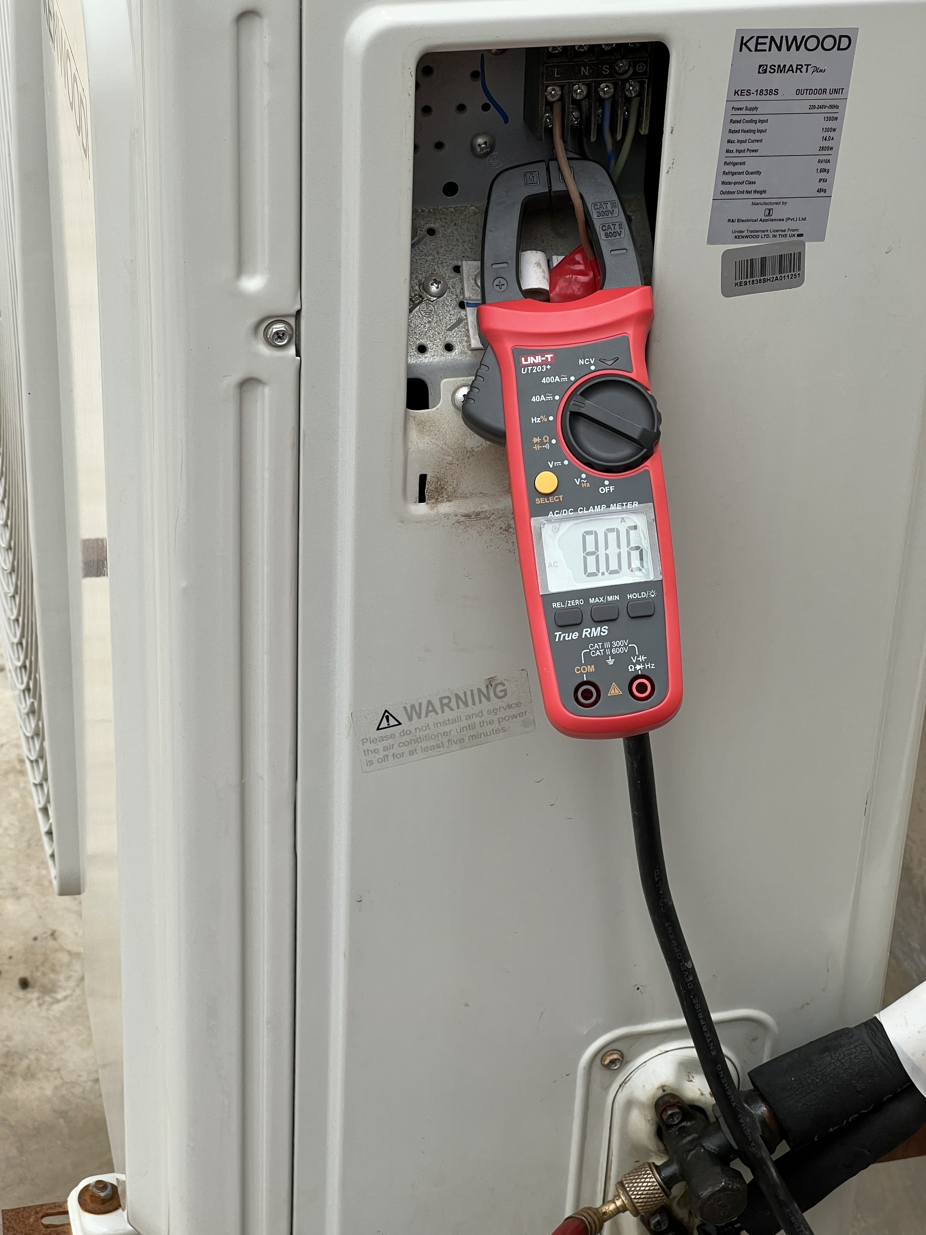

Outer & inner pipe joints, opened the top cover and put his hand in it while the AC was running (I asked him if I should have it turned off but he said it's fine) got shocked a few times (could be his fetish, who am I to judge
) said outer is fine.

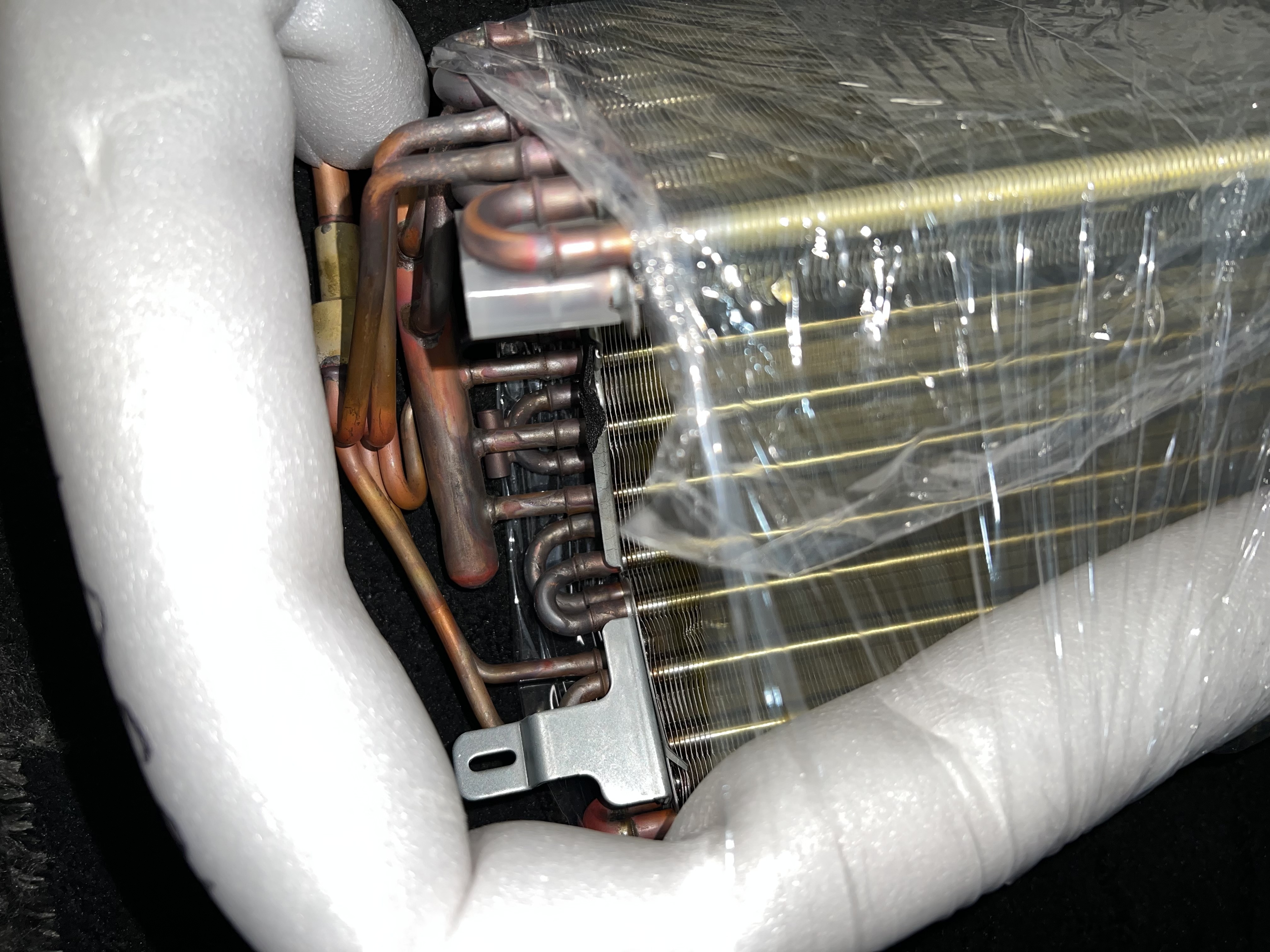

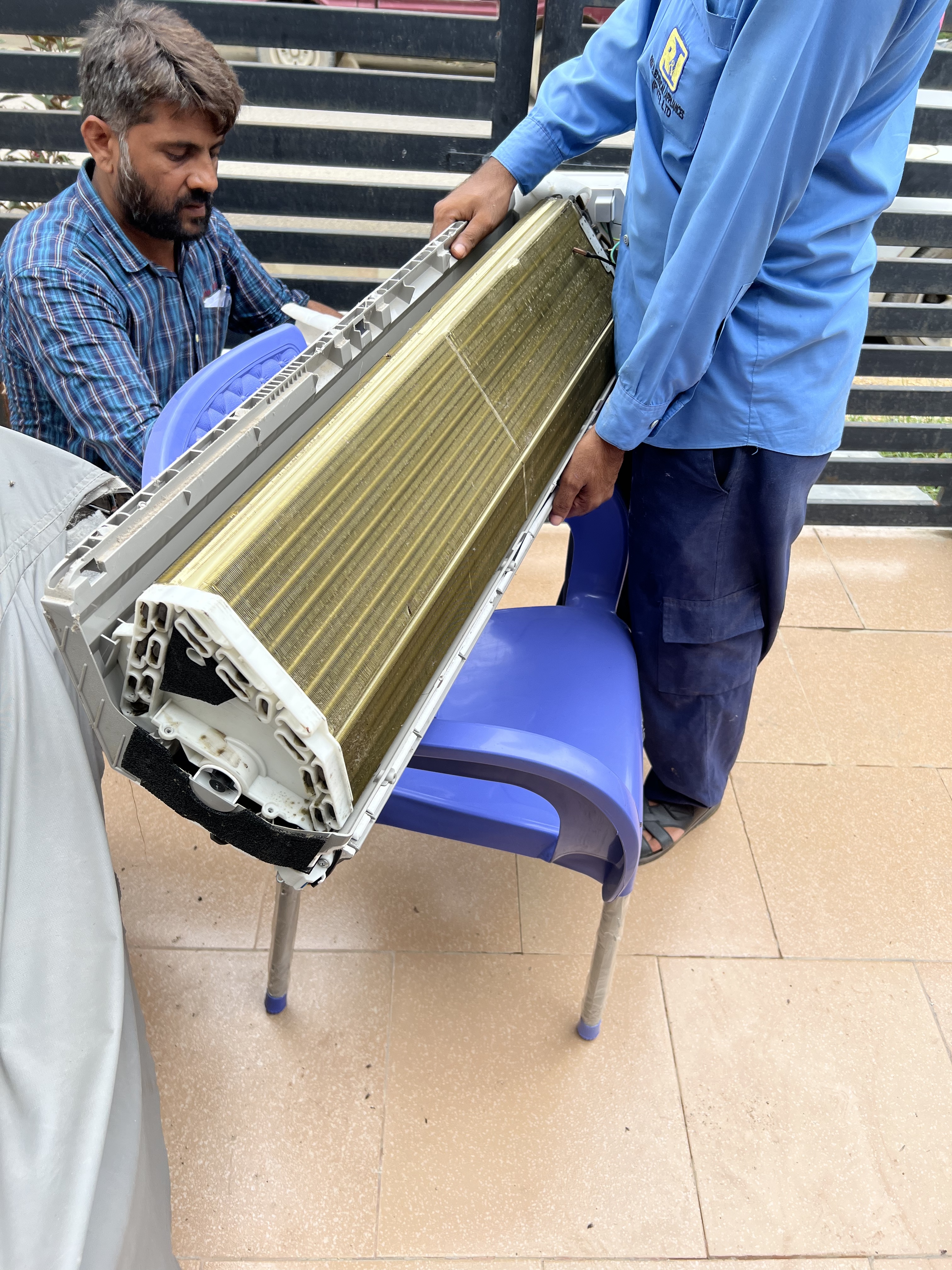

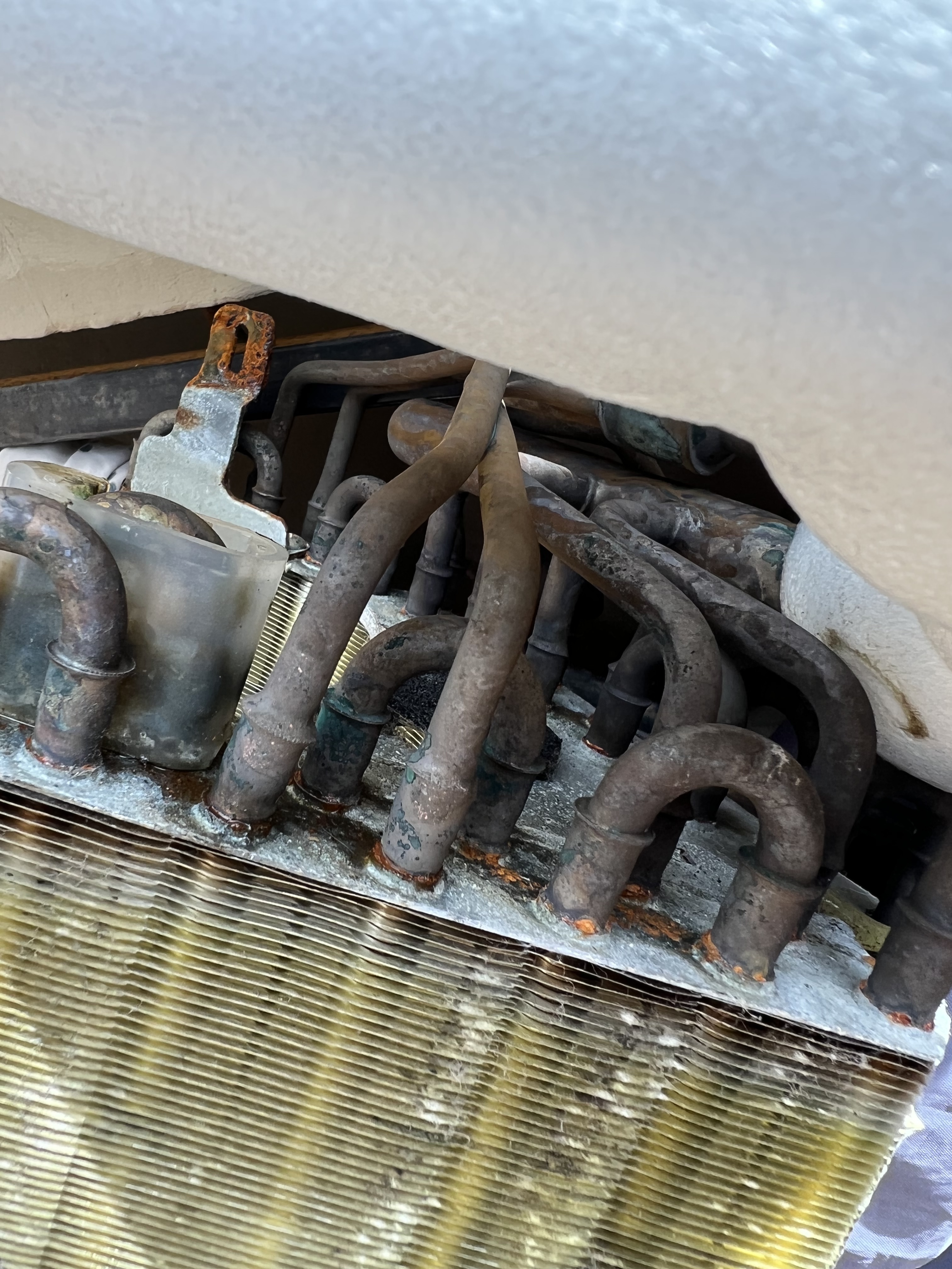

Inner pipe joints, said they are fine too. Opened the inner and found a what he said is a very minute/minor leak on the left side of evaporator/u-band I think.
Said unit will be sent to service center, I said what will they do? He said they'll do what's best. I said what's your best exactly? He said probably a repair or u-band replacement, depends on their mood. I said:
and told him buddy I don't want no repairs on this gawd-damned 4 months old AC I bought for a freaking premium from black market
Kher after much back & forth he said to have me write my request on this complaint report and hope for the best so I did.

Either go for repair (as its a minor leak) and if it gets leaked again you can have the evaporator coil replaced with new (until it's in warranty period)
Go for evaporator coil replacement but you can only have the evaporator coil replaced only once in a warranty period, So if goes bad again you'll have to pay 18500 for new evaporator replacement.

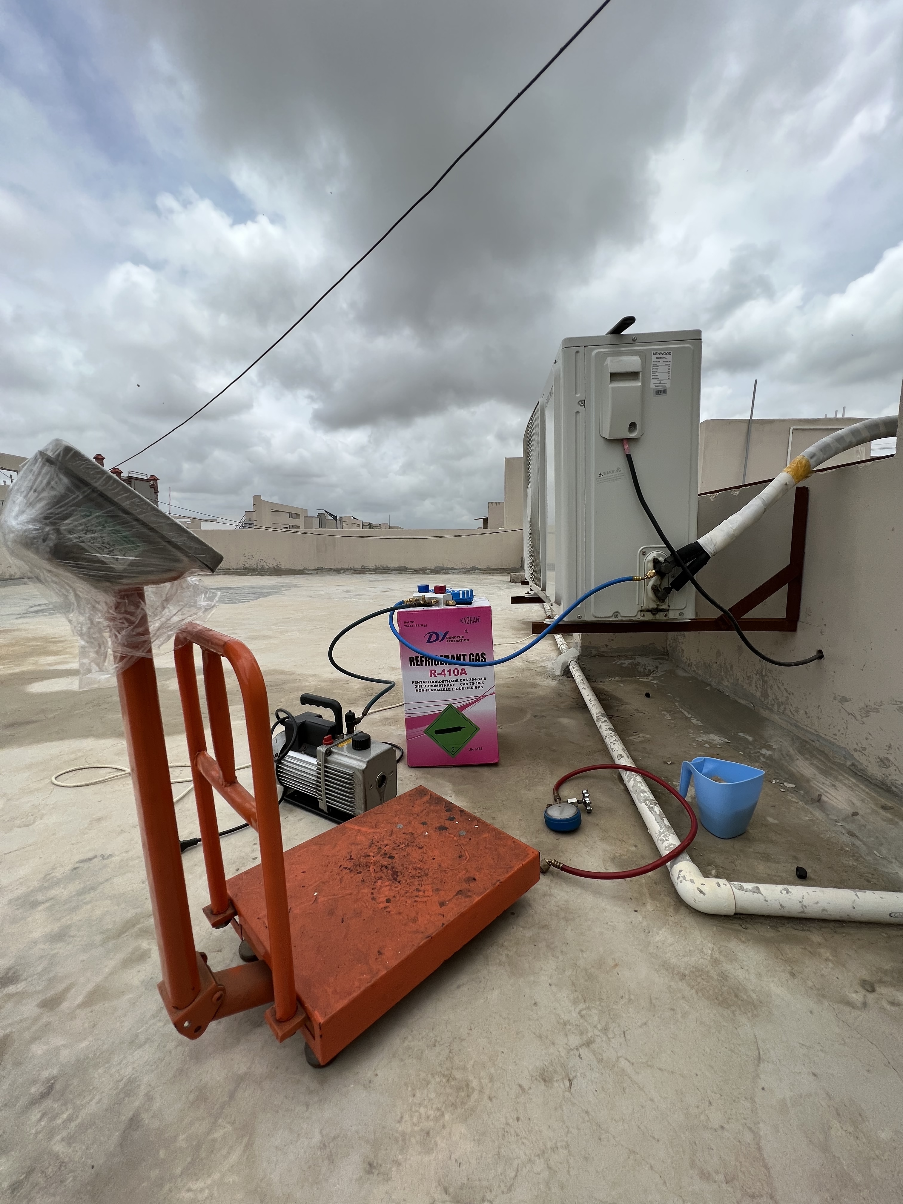

Me being me, I opted for whole evaporator coil replacement as if I'd have gone for repair the unit will be needed to go to service center then god knows how many days it would have taken. While for whole evaporator replacement Zubair bhai said he'll send the guy with the new coil, he'll replace it at my place and voila! Work done. So I okayed him
After a few hours I get a call from Irfan from Kenwood, he starts the conversation with "Sir apka AC kal kab uthwaon" /// Like he didn't already know what conversation/deal I already had with Zubair bhai for evaporator replacement at my home. Kher Mr Irfan sahb kept on pressing and telling me home replacement not possible, he'll have to pick the inner & outer (to my surpirise) as well and he'll have to order the new evaporator coil from factory then it will come then it will be replaced then they'll do pressure testing servicing etc etc and then the unit will be sent back so it can take days.
