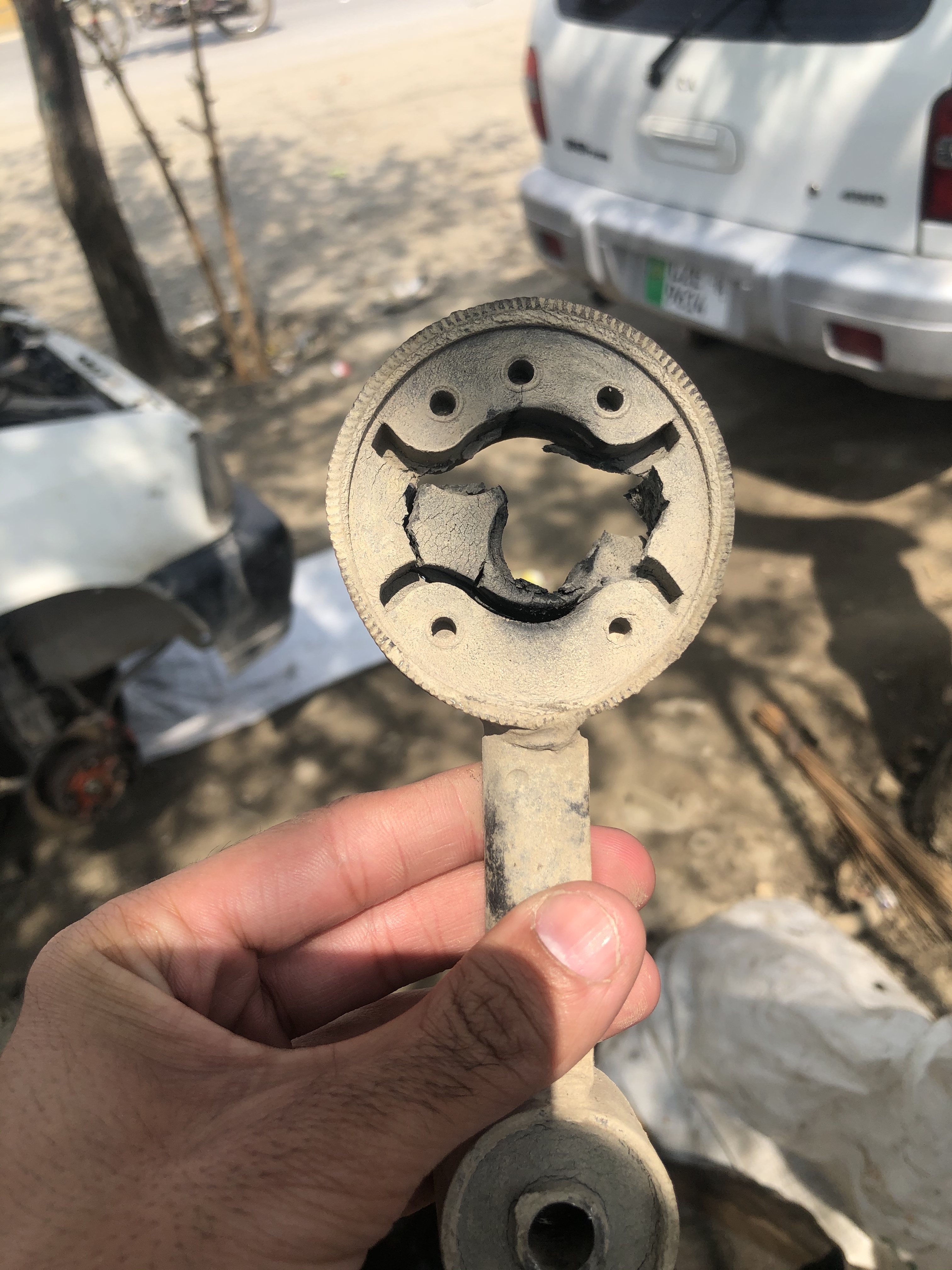

a lot of people told me that it will be fine if you replace its rings...but my mechanic said it needs complete engine overhaul...its mileage also got worse..recently i figured out that its oil pump is also faulty because the engine oil check light would be continuously on while idling.

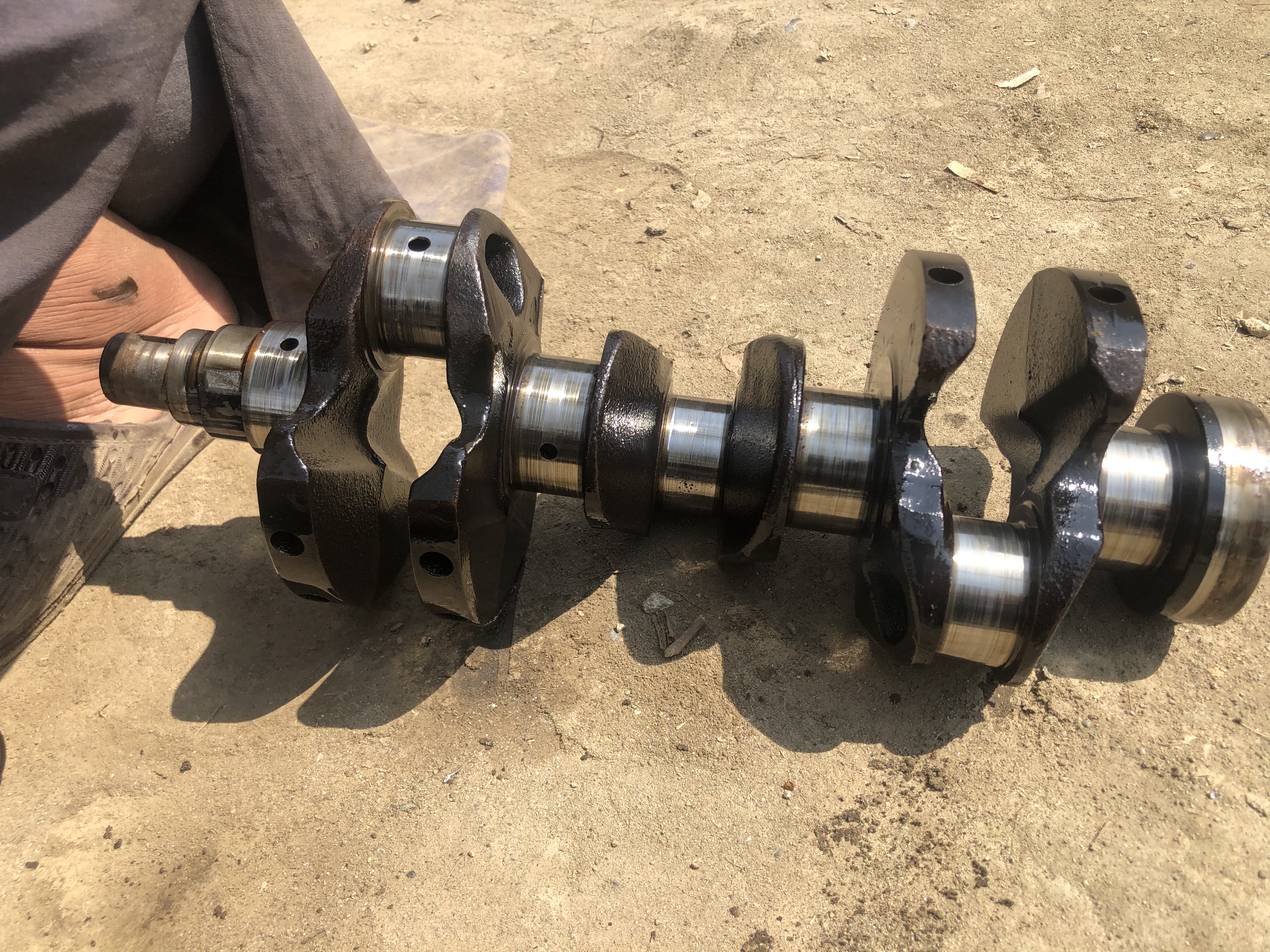

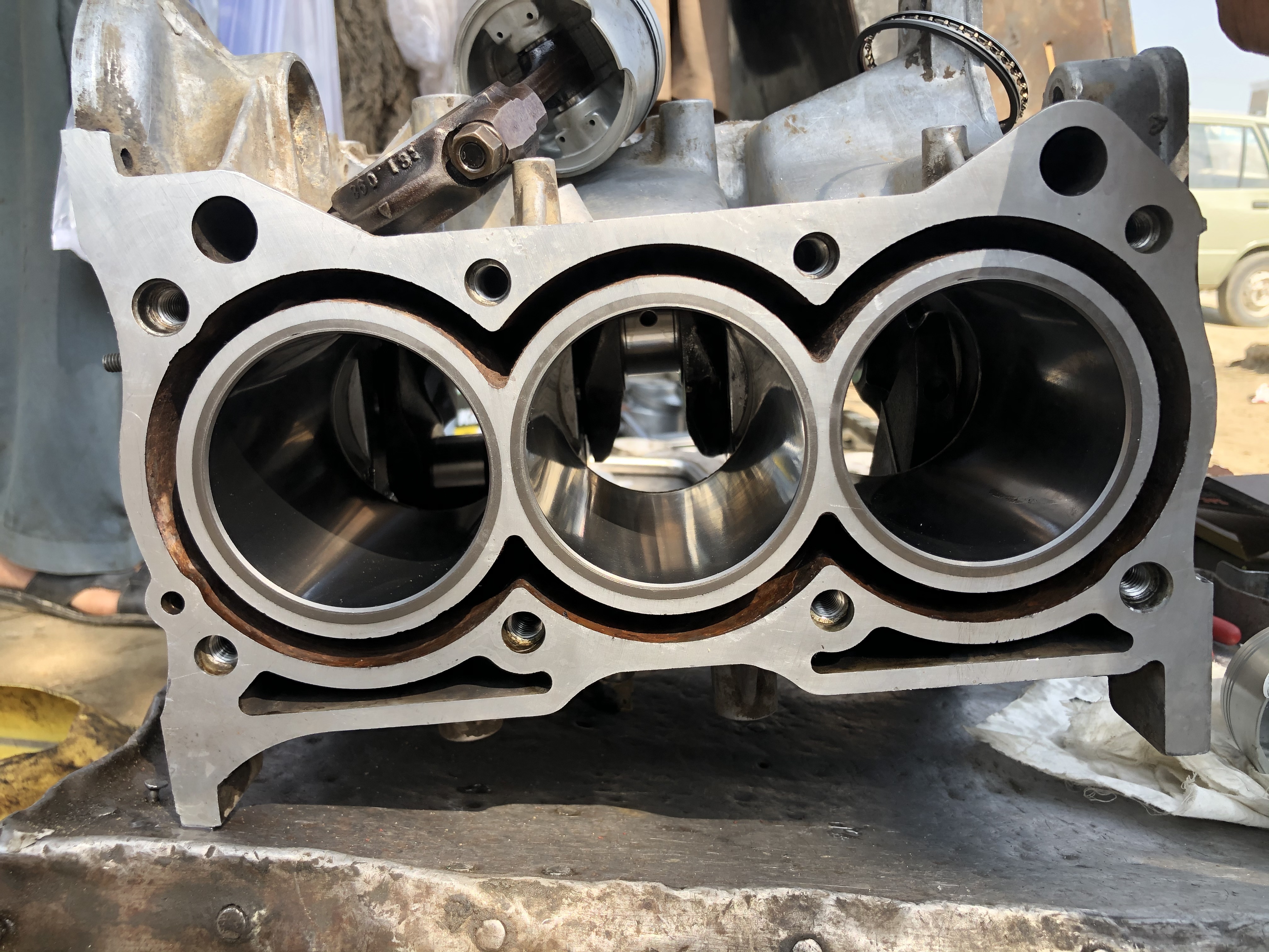

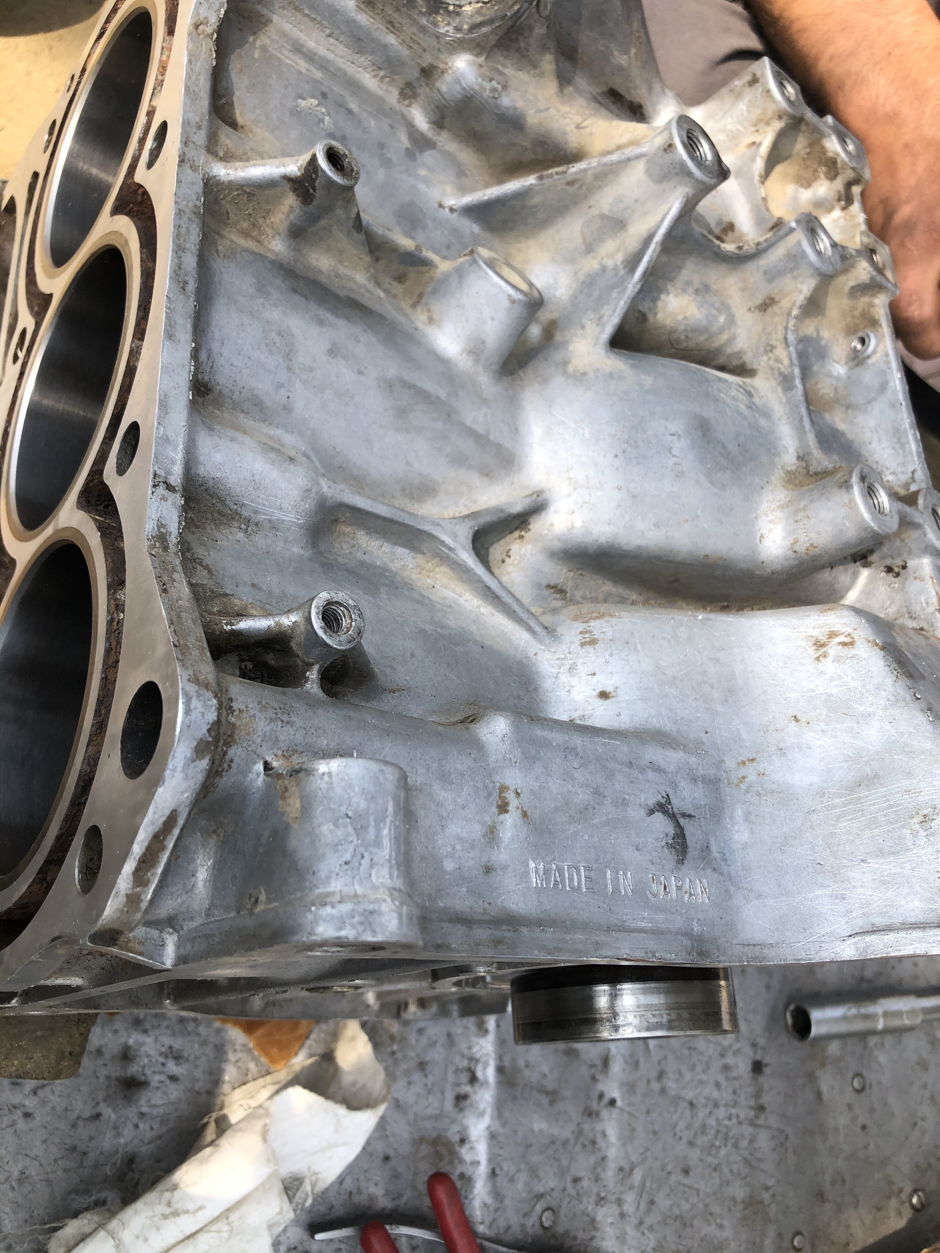

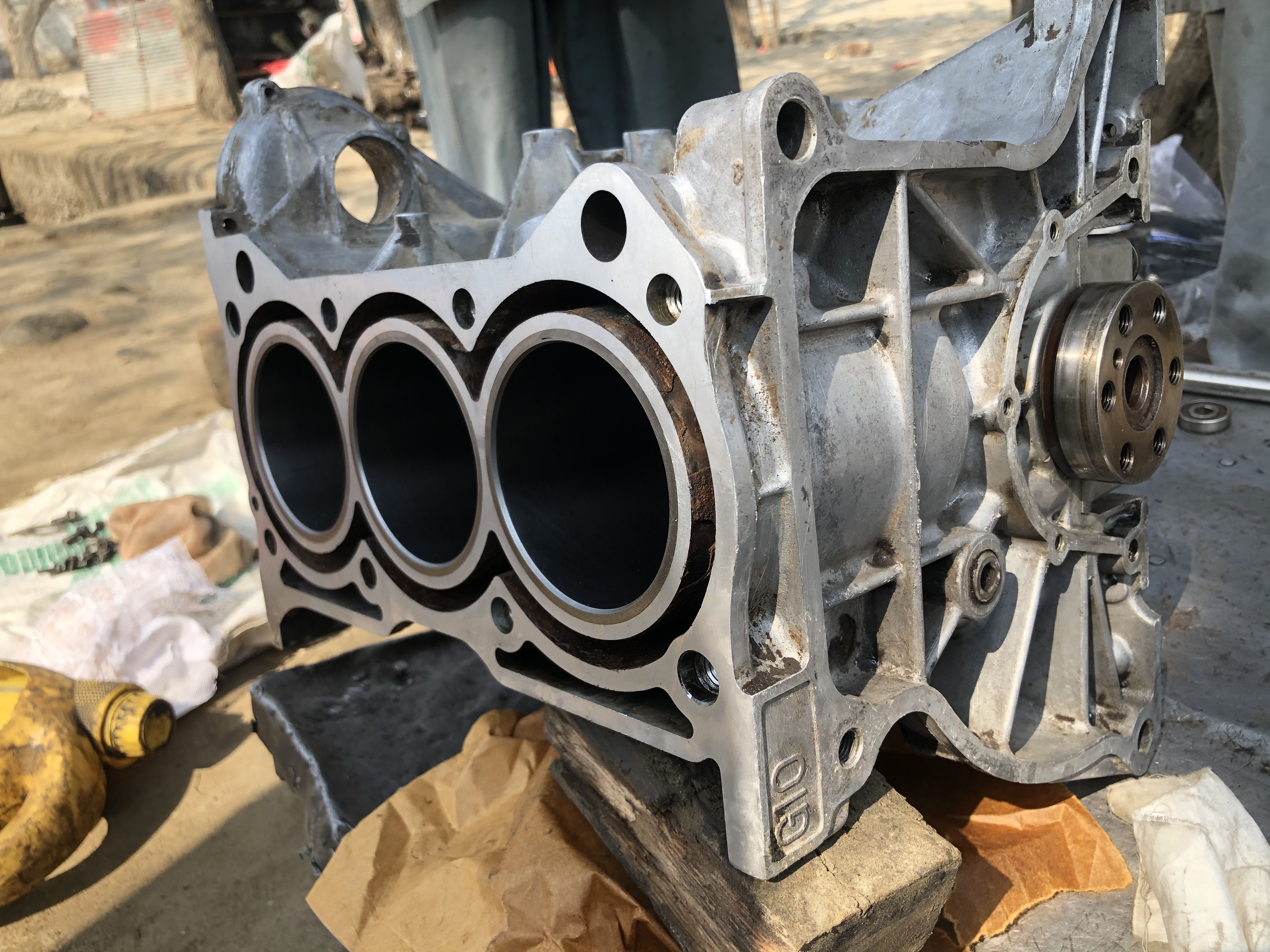

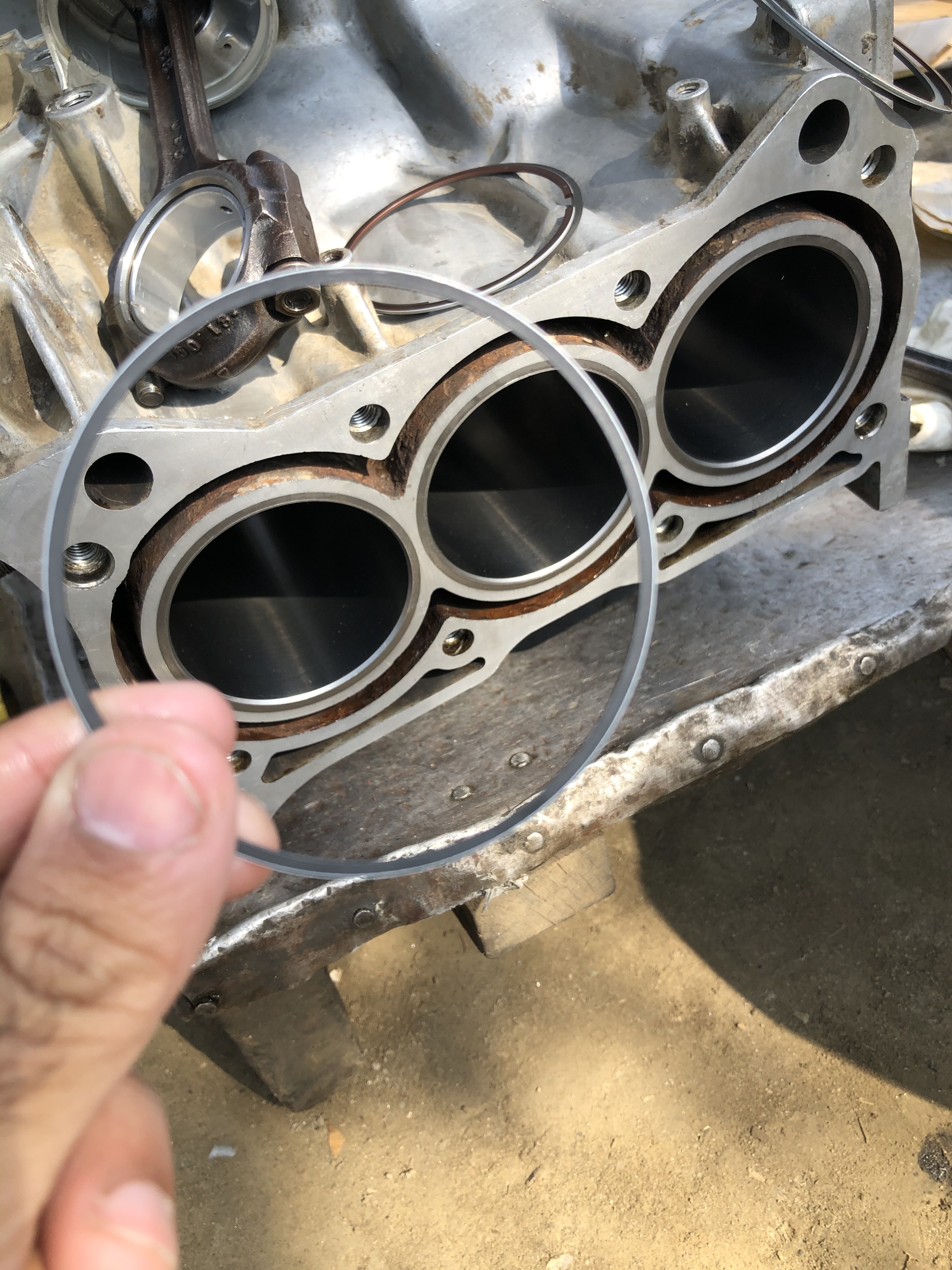

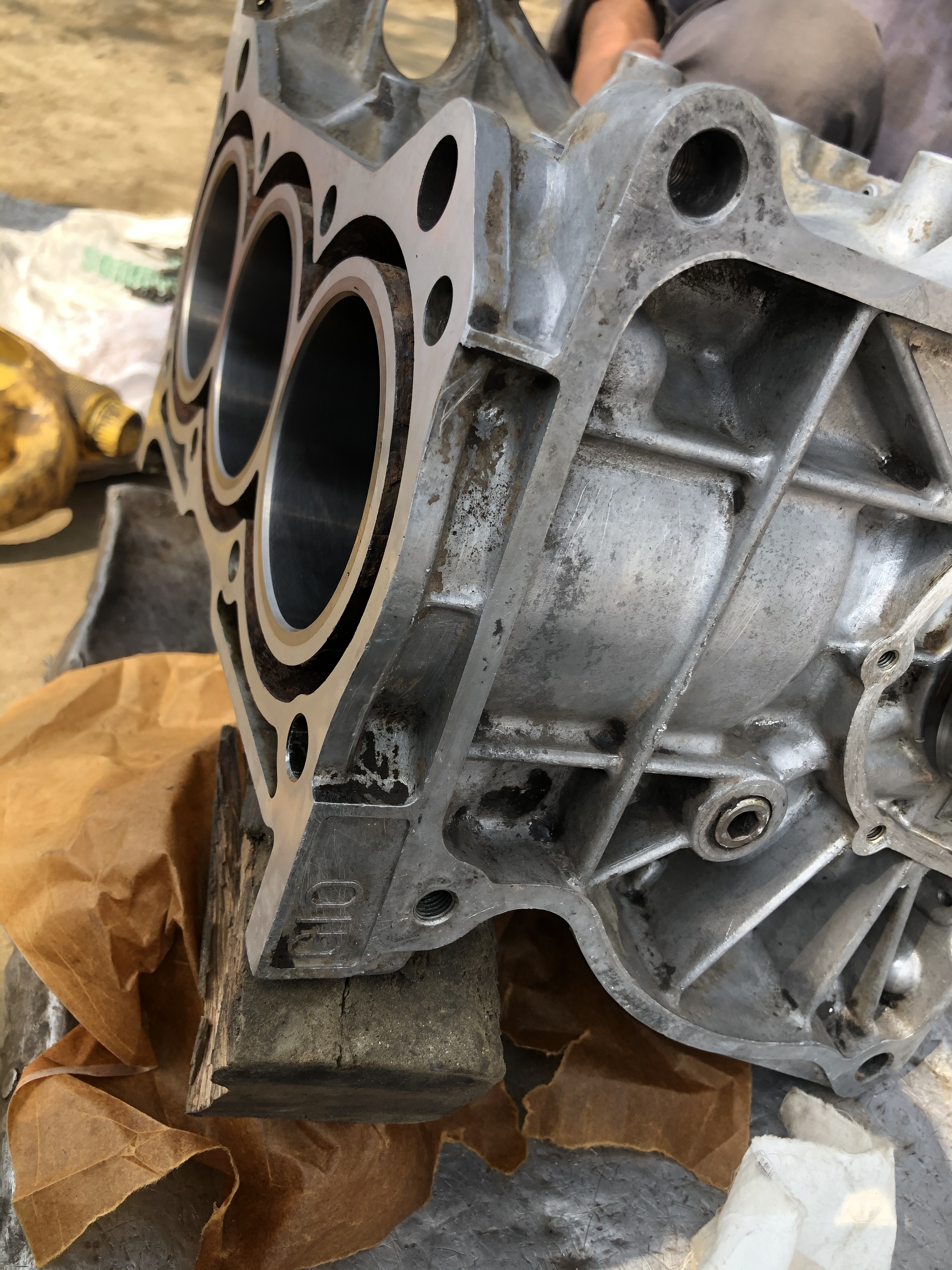

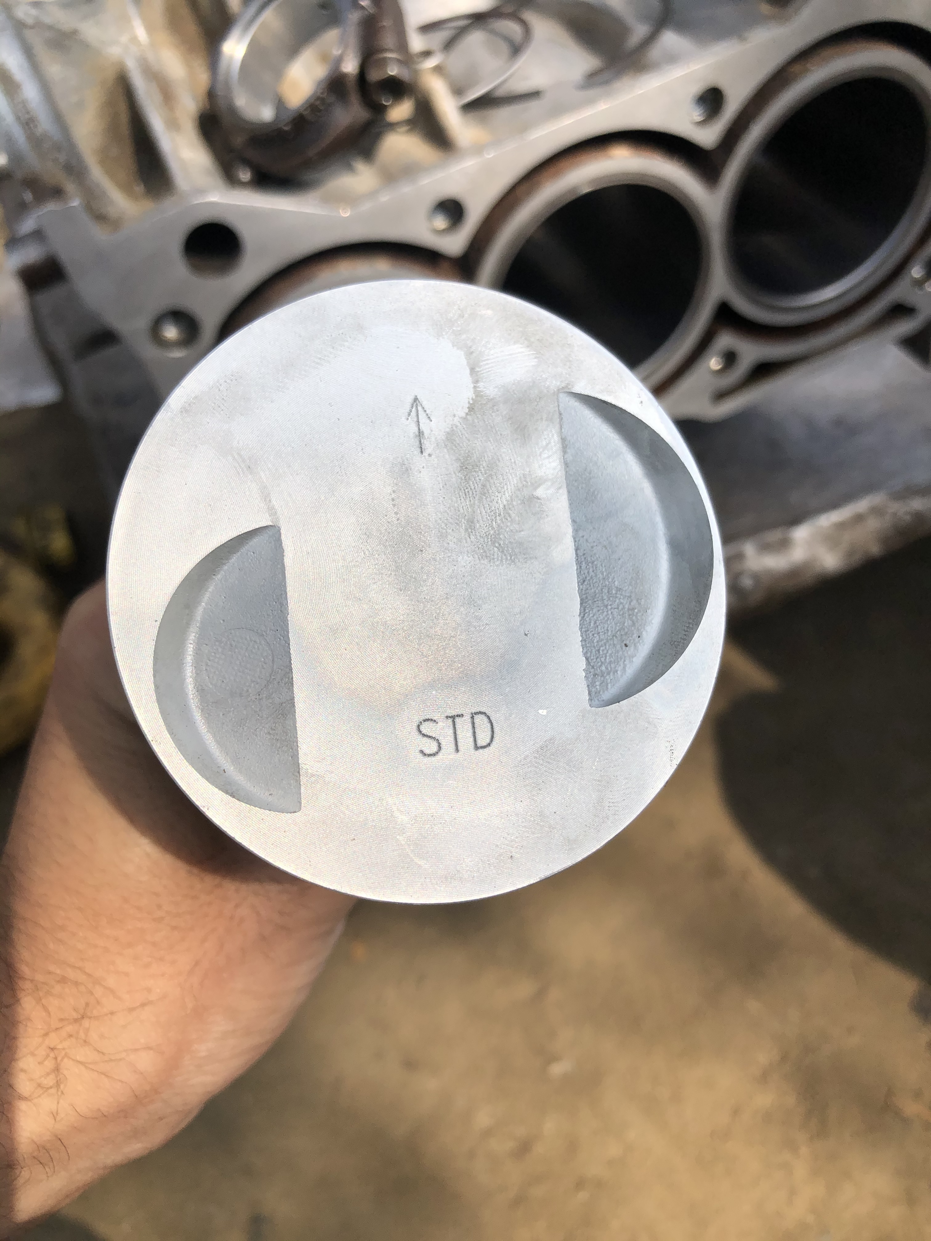

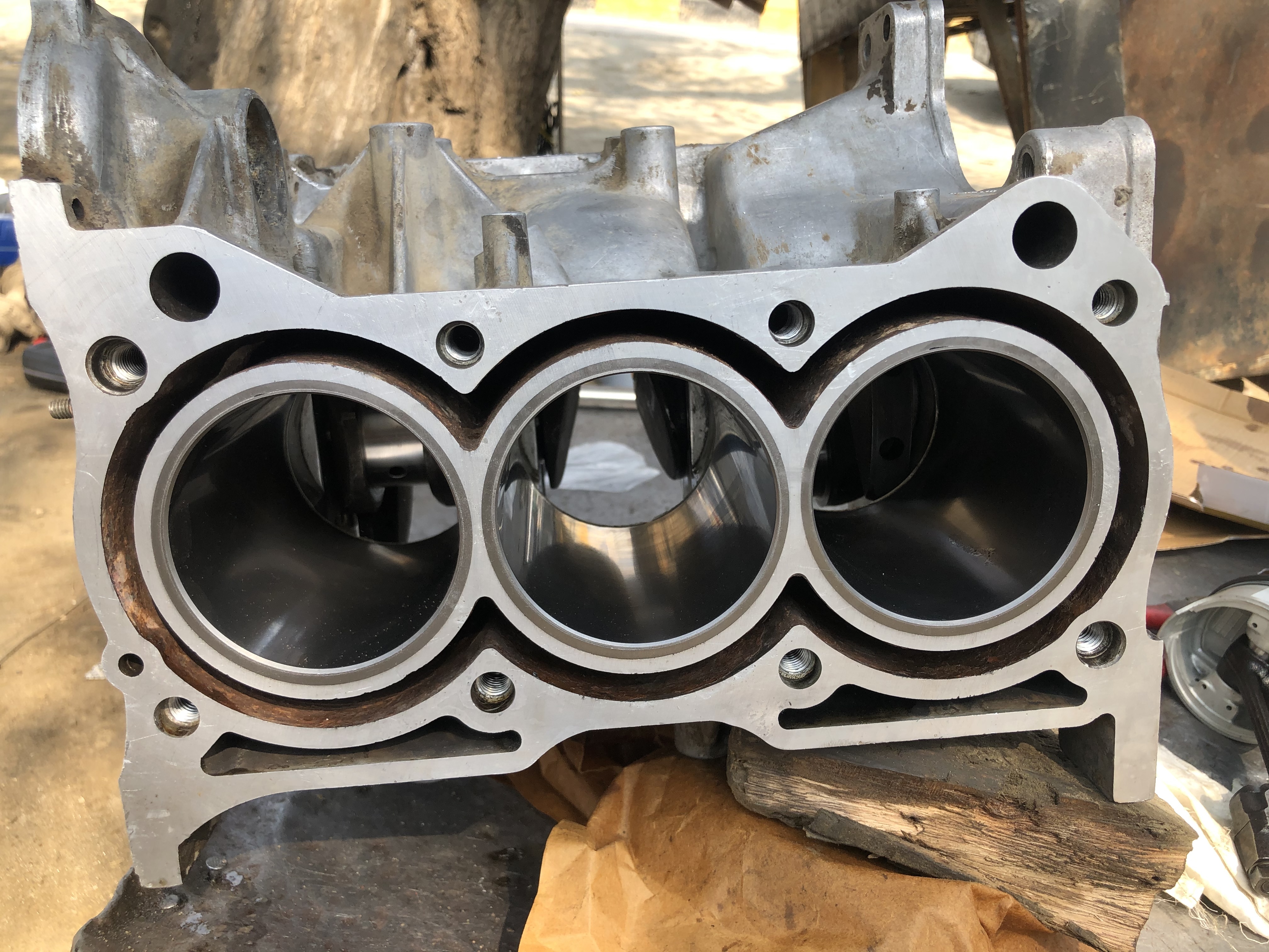

The engine got overhauled for the second time...last time it was in 2014.. engine was never opened before.... its cylinder diameter was 0.50 from the last bore...i asked mechanic to take it back on standard bore rather than re-boring it to 0.75 or 1.00...
Following things done in Engine overhaul:
1-Cylinder got bored into standard size by placing glass (that is what they call it)

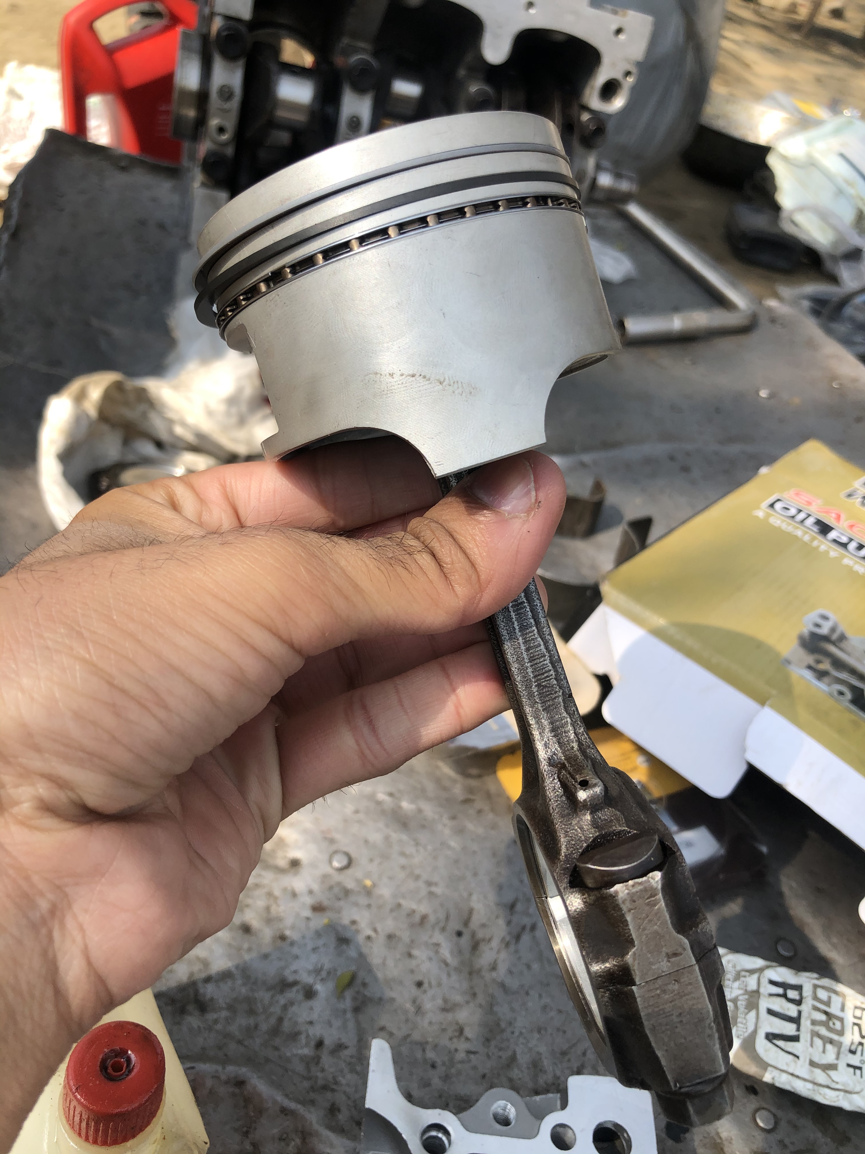

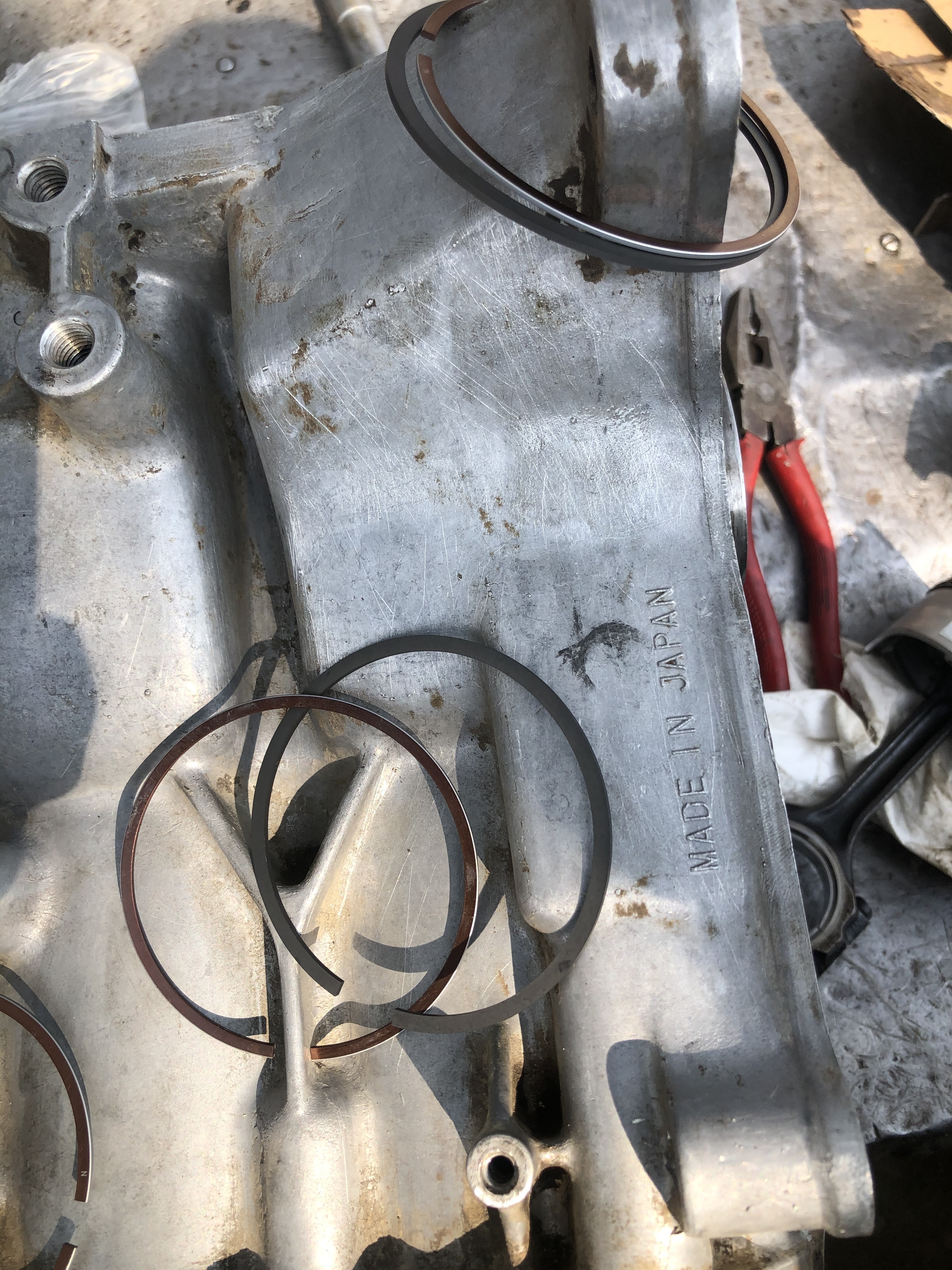

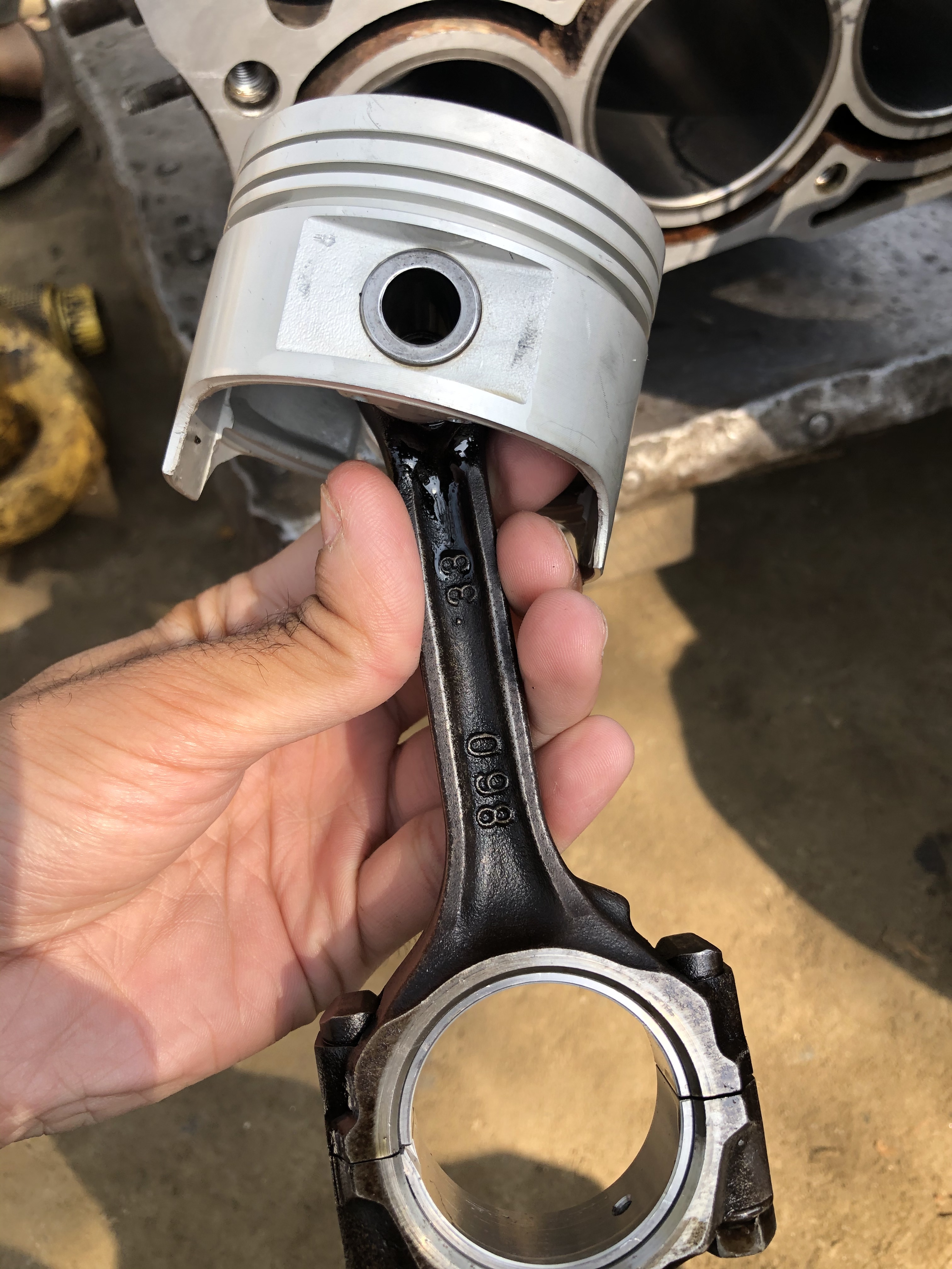

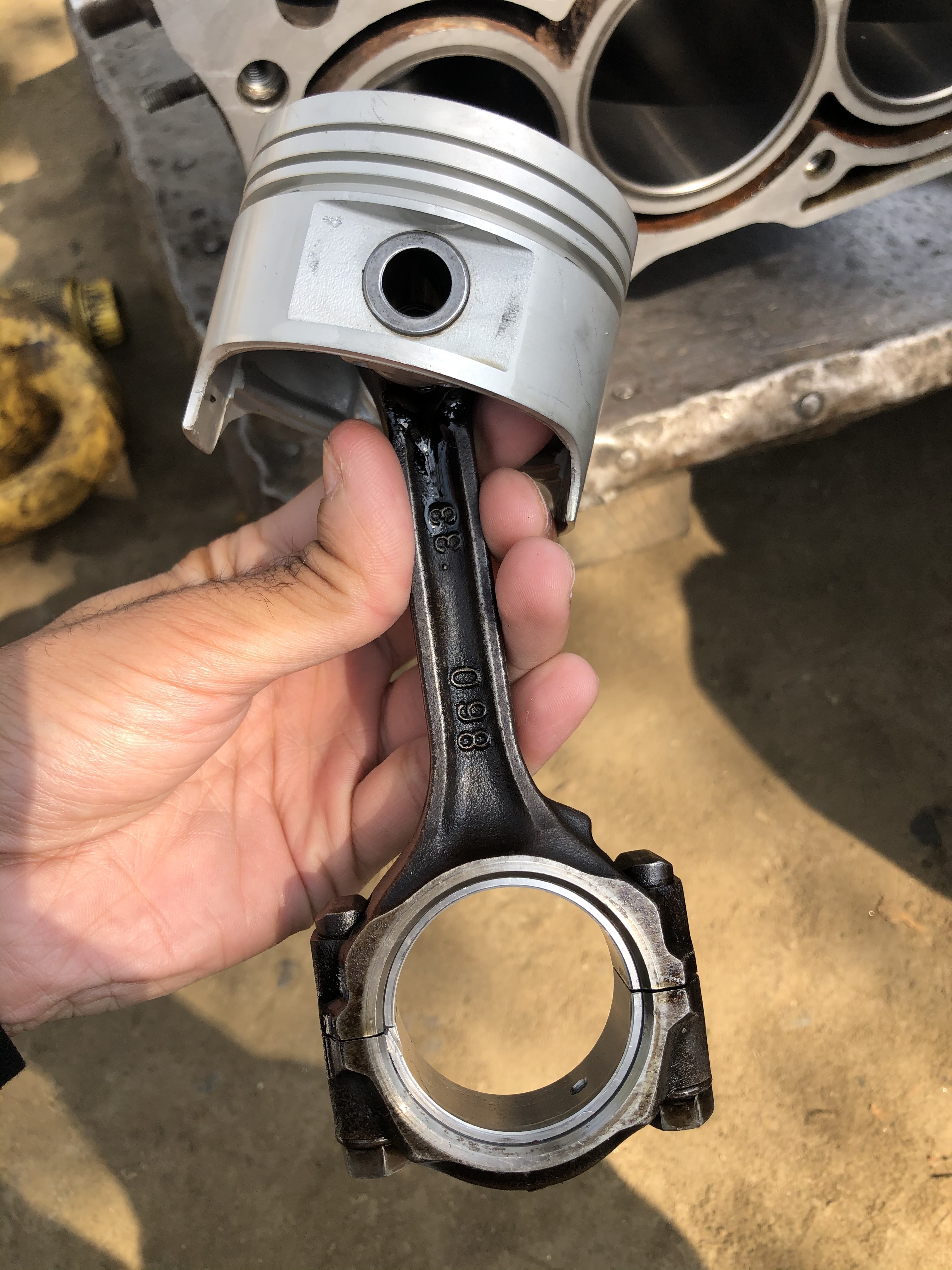

2-Standard size piston and rings placed..
3-Oil pump changed

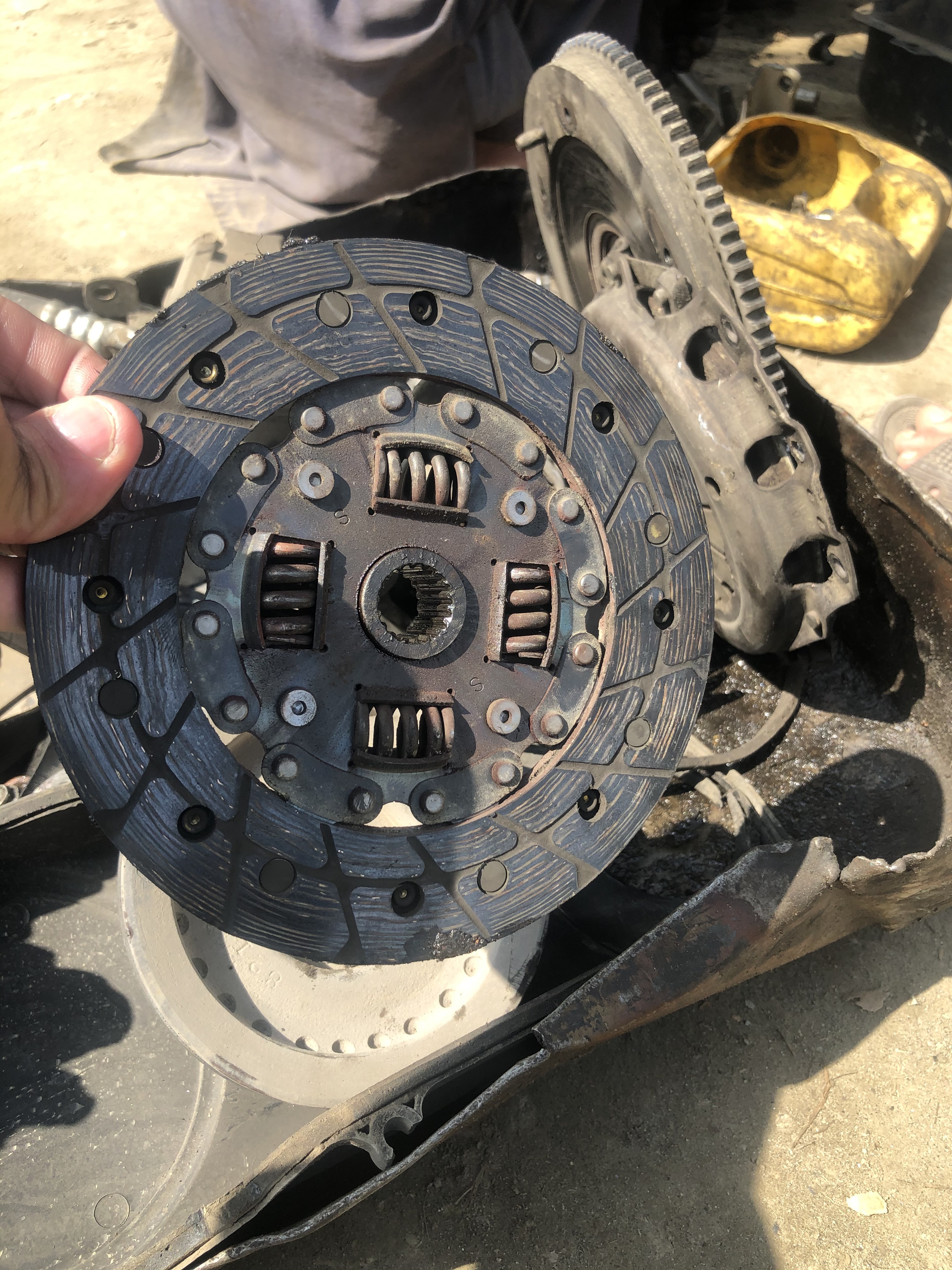

4-Clutch plate changed
