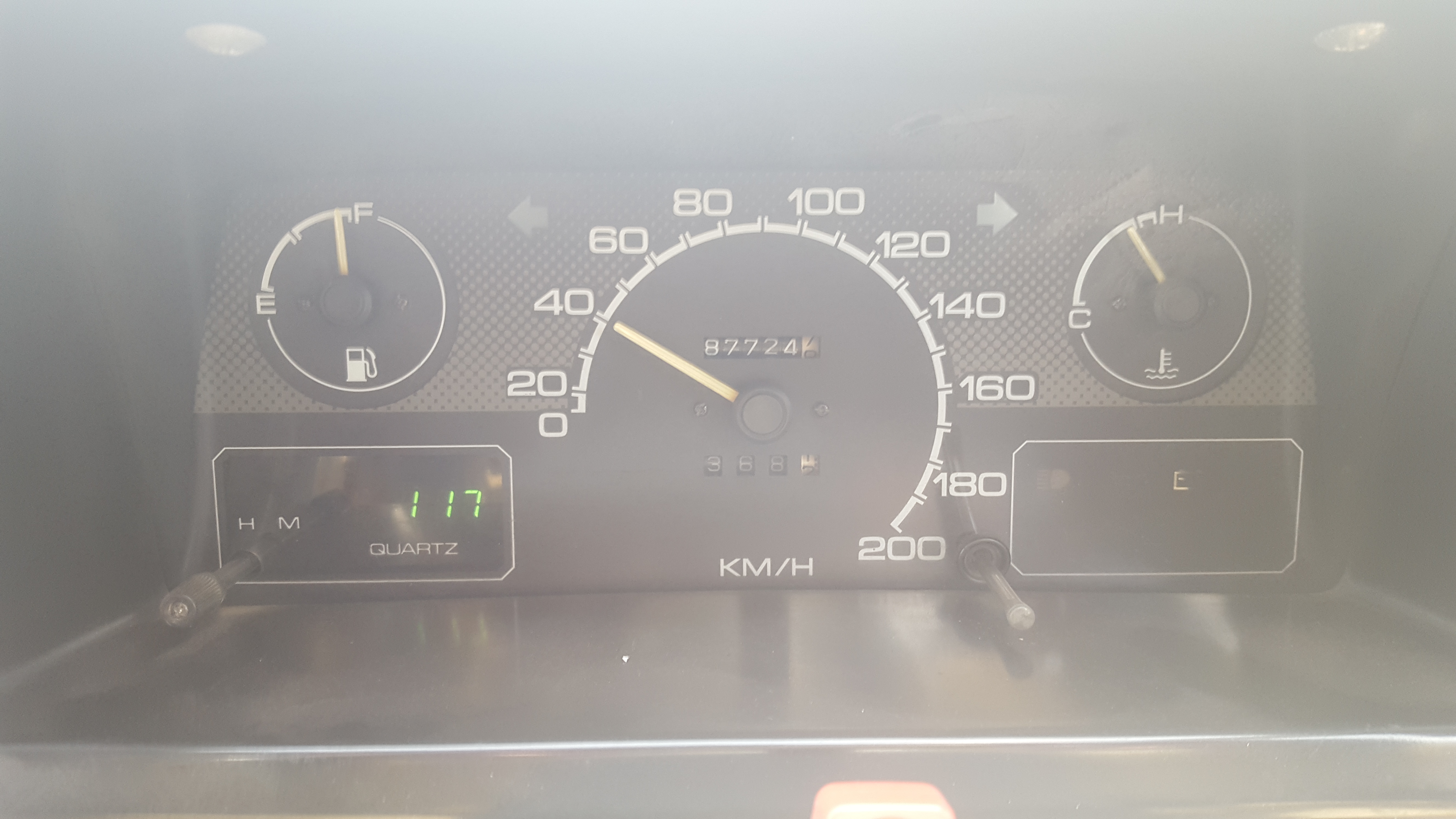

However, the temperature gauge climbed up and stayed there during the journey, I parked the car, while the engine still running I placed hand on the bonnet and it was cool. I opened the bonnet and touched the radiator cap, it was at ambient temperature, I mean one can place hand on it for as long as he want, no heat. Placed hand on the tappet cover and it was also not too hot. No signs of engine heat up like pressure or steam in reservoir bottle. The radiator fan was switching on and off on the same high level of gauge. I switched on the air conditioner as fan becomes direct on that mode but the needle remained on the same position as shown in the picture below.
At night, when the car was cool I opened the radiator cap and coolant was full. When I reached Islamabad, the temperature gauge came back to original position i.e. half mark.
