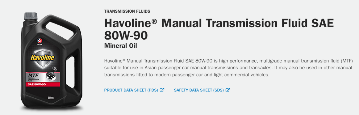

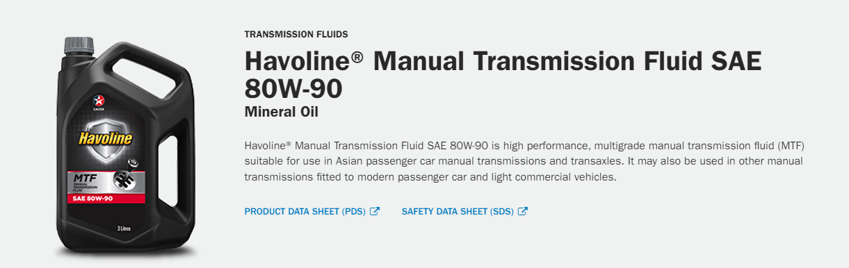

As @Mun33b said, you poured the wrong oil grade as a band aid for supposed oil consumption. You should have done a compression test at that time, checked for leaking seals, bad pcv, etc. An engine does not one day start consuming oil, it's a gradual failure.
Also, if it was a light oil consumption because of worn rings, that is completely normal for an engine of said mileage and did not warrant the usage of a thicker grade oil.
