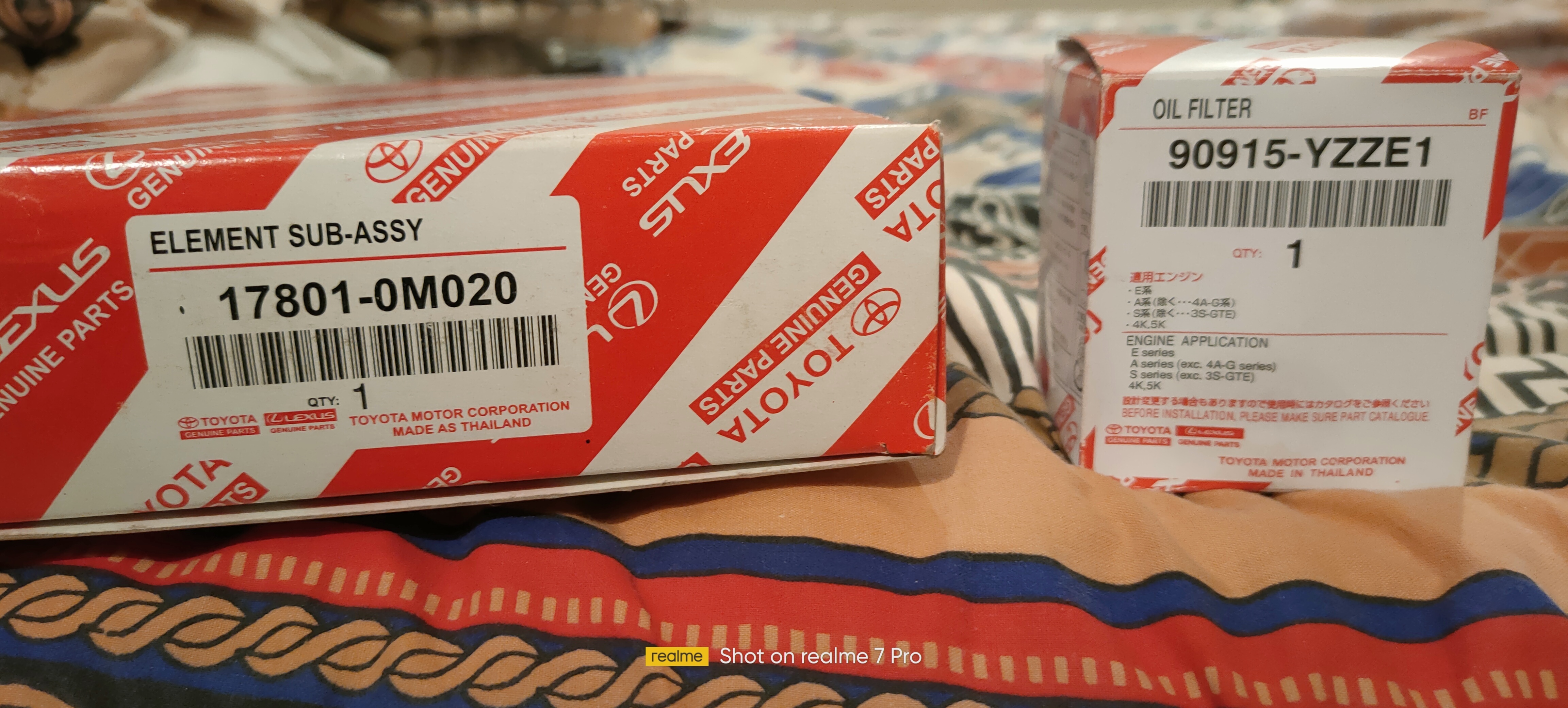

Go with fully synthetic but with oem oil.filter from dealership
Bought this air and oil filter from Daraz yesterday Planning to get them change with synthetic oil

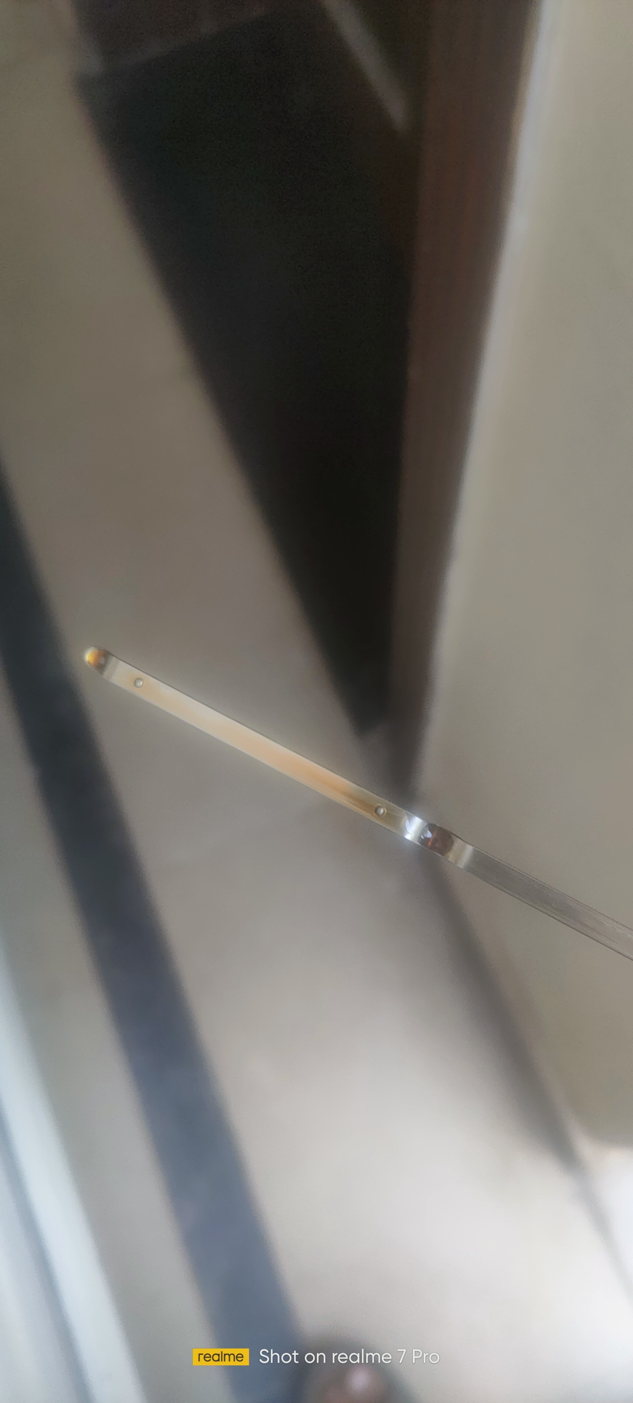

So this is the oil dipstick level after 3.7 litres with oil filter change too. Isn't it look too high? I mean some part of oil is above the upper dot.
Yes its fine.
