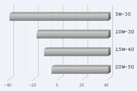

Right now I've topped the Aisin 5W-30 greenTech+ Full Synthetic oil with Caltex Delo Gold 15W-40. That's a calculated viscosity of 10.67 cSt @ 100C, with 11.9% Delo Gold. Even if I had a 50/50 mixture, I'd still be in the viscosity spec of a 30-weight oil.
Although, If I end up having to change all of the oil through attrition over its remaining service life, I'll just switch to a full syn 5W-40 and check consumption and seals. Otherwise, heavier 5W-40 or permanent 15W-40 HDEO.
I still don't think I would ever have a reason to use 20W-50, but you can see that the only reason would be a band-aid, i.e. it means something is wrong with the engine.
