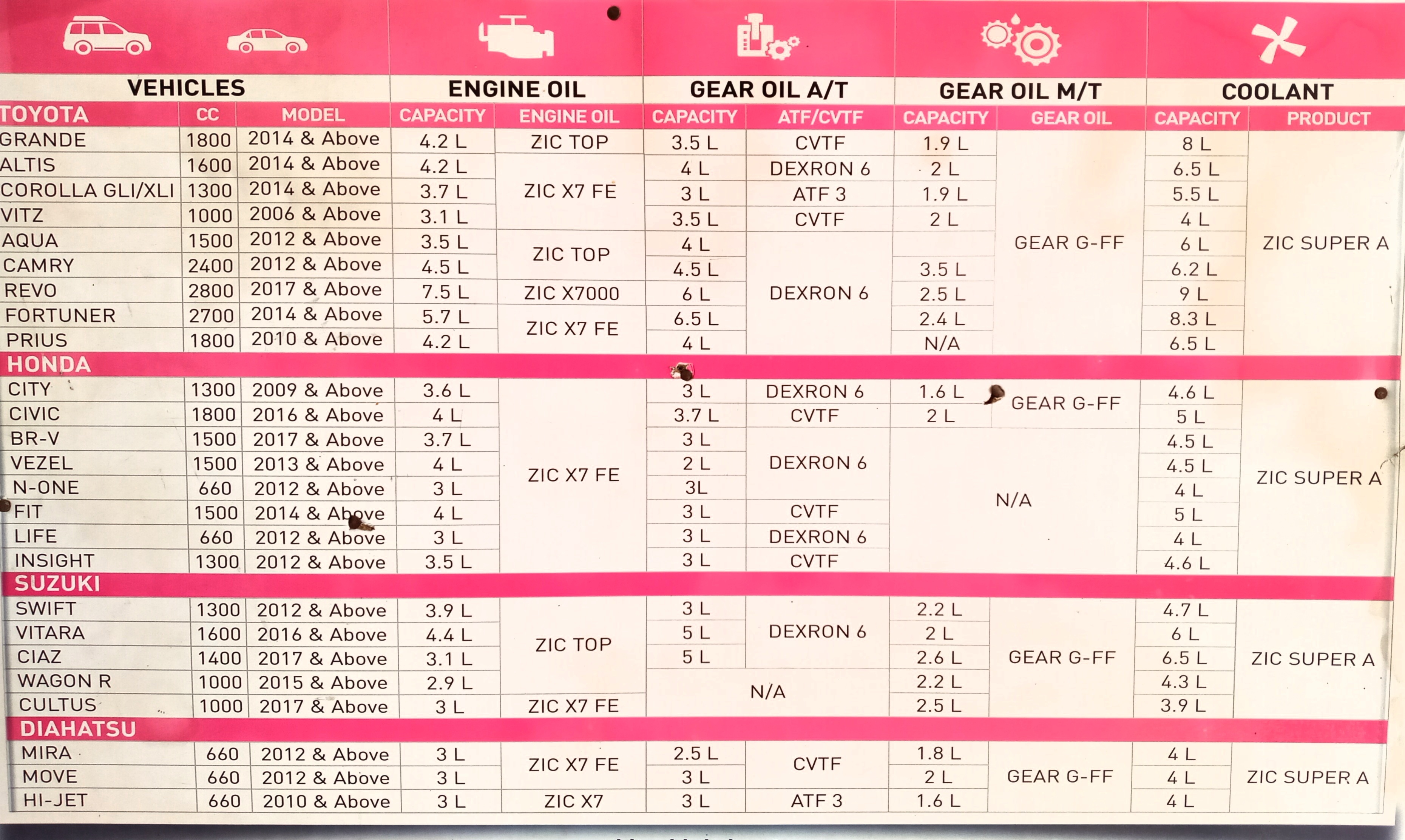

Yes, common issue in 1kr fe engines before 2014. Then the new spider shape post 2014 had improved oil burning issue.
You can either buy a 4L bottle of 0w20 or 5w30 oil, whichever cheaper. Then after pouring in 3L oil, save the rest of the 1L oil in bottle. keep checking oil level after 1000-2000kms. Once it is at half the dipstick, top up some oil from the leftover 1L.
Keep doing this (top ups), and that 4L bottle should run fine for around 8000 to 9000km.
Then you can change oil.
The other option:
Go for a cheap mineral oil which you just change at 3000km. Make sure it actually comes out cheaper over 8000-9000km. Try mobil mineral ones.
