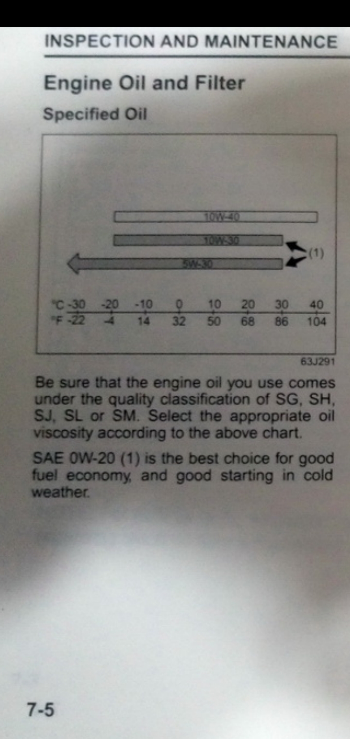

what about 5w30 instead of 0w40 or swift
I am myself using 5w20 also been using 0w20 but people think it's too thin and stuff like that. Whereas it's totally fine. My car is at 107k. Also used same in my city at 120k. Swift's manual says use 0w20 for better cold start and fuel efficiency.

0w-40 is wrong grade for Corolla. Sicne zic has this thry made a chart to sell it
0w20 is never recommended in Swift's manual RS413

The chart is not 100% accurate; quantities are not precise, and at some places, wrong engine oil grades have been recommended.
I think 5w-30 is fine, rather better than 0w-40.
Instead of following this chart, I would strongly and sincerely suggest to follow owners / users manuals, otherwise, one may end up in getting the mechanicals ruined.
