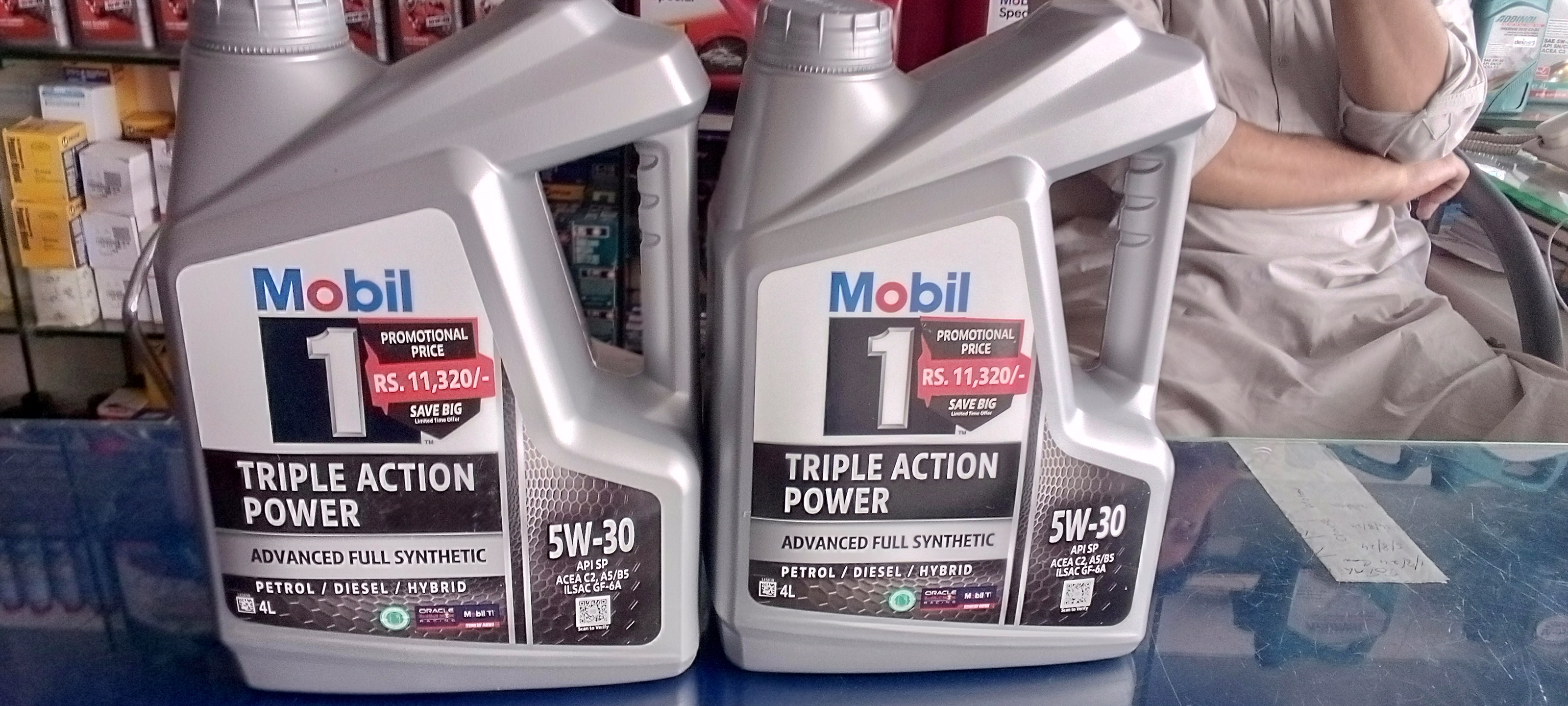

By the way, Rs. 11,320 for 4L as stated on the sticker in the picture you posted is not a great price. I bought the same oil for like Rs. 12.5k for 4L.
You want some real savings? PSO makes a quality full syn 5W-30, 8k for 4L. Their semi-syn 10W-30 is super appealing to me for all my cars - it's under 7k for 4L and IIRC so is Havoline Formula 10W-30 - that's also API SN, and their nearest price competitor - remember, when companies compete, the consumer benefits. I just got Idemitsu 5W-30 full syn for my Civic, 7k for 4L.
