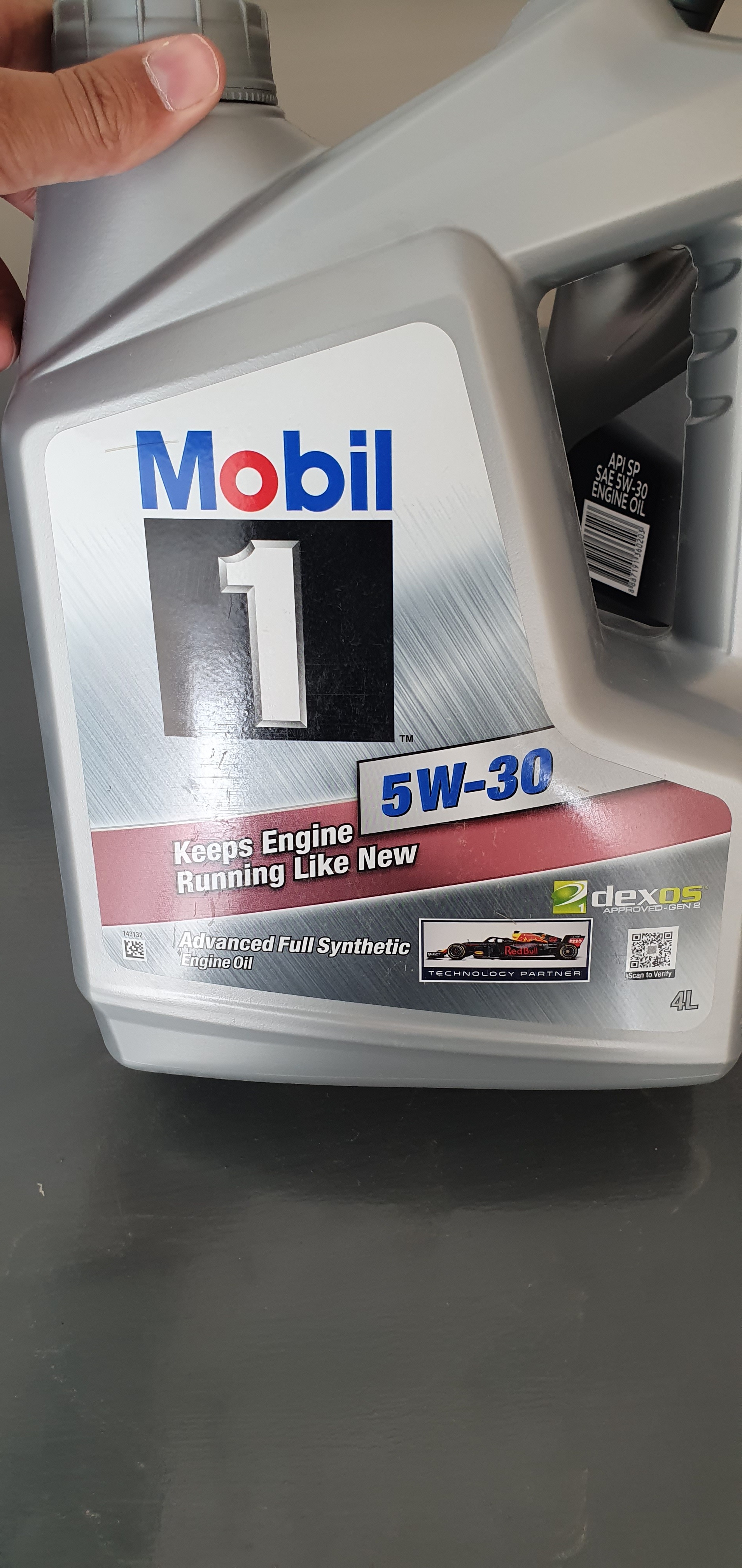

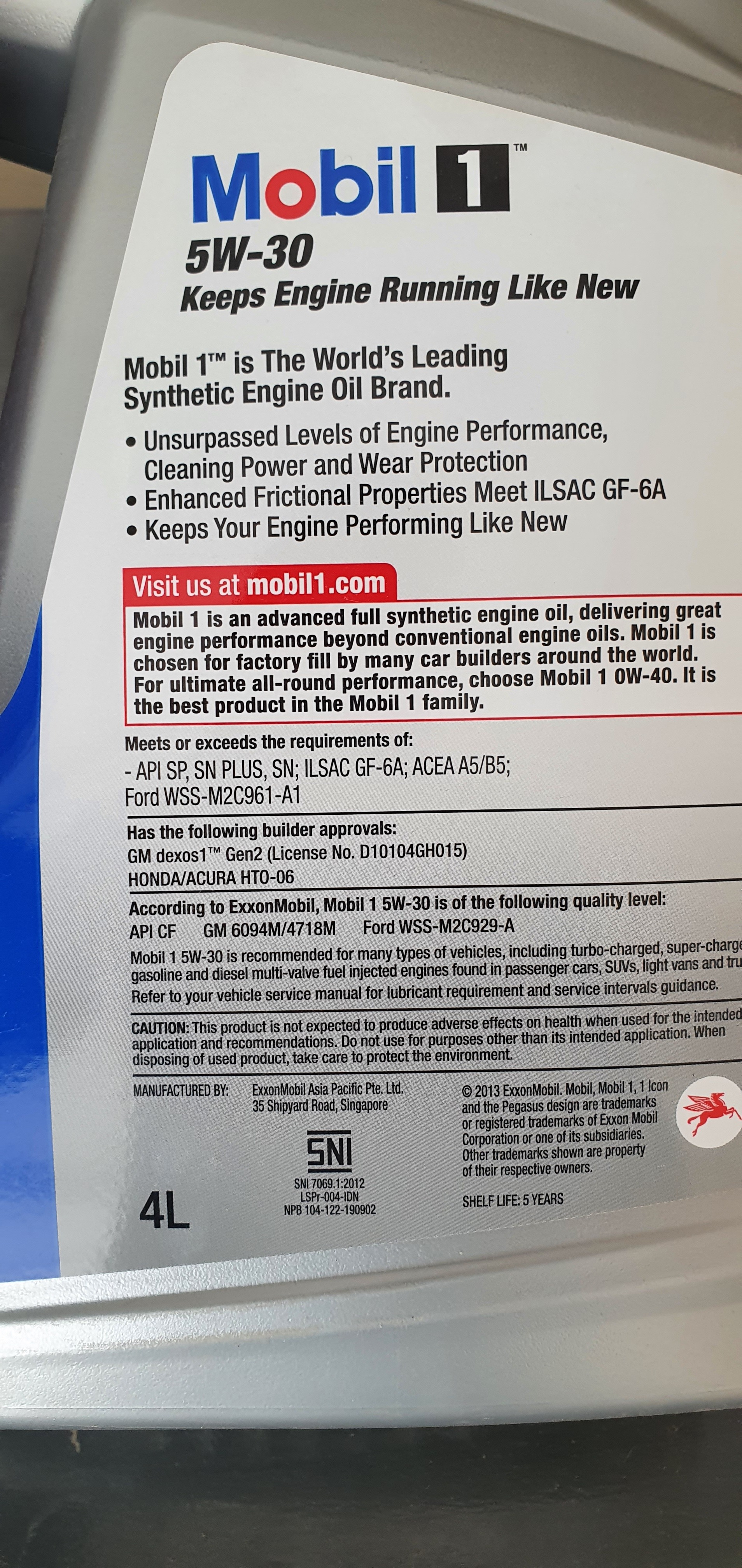

Anyone using Mobil 1 5w30 in Fortuner Sigma 1gd ftv this is the only oil i found according to specs mentioned in owners manual Is it worth buying this expensive oil for Sigma

1gd specs ilsac gf6a?
