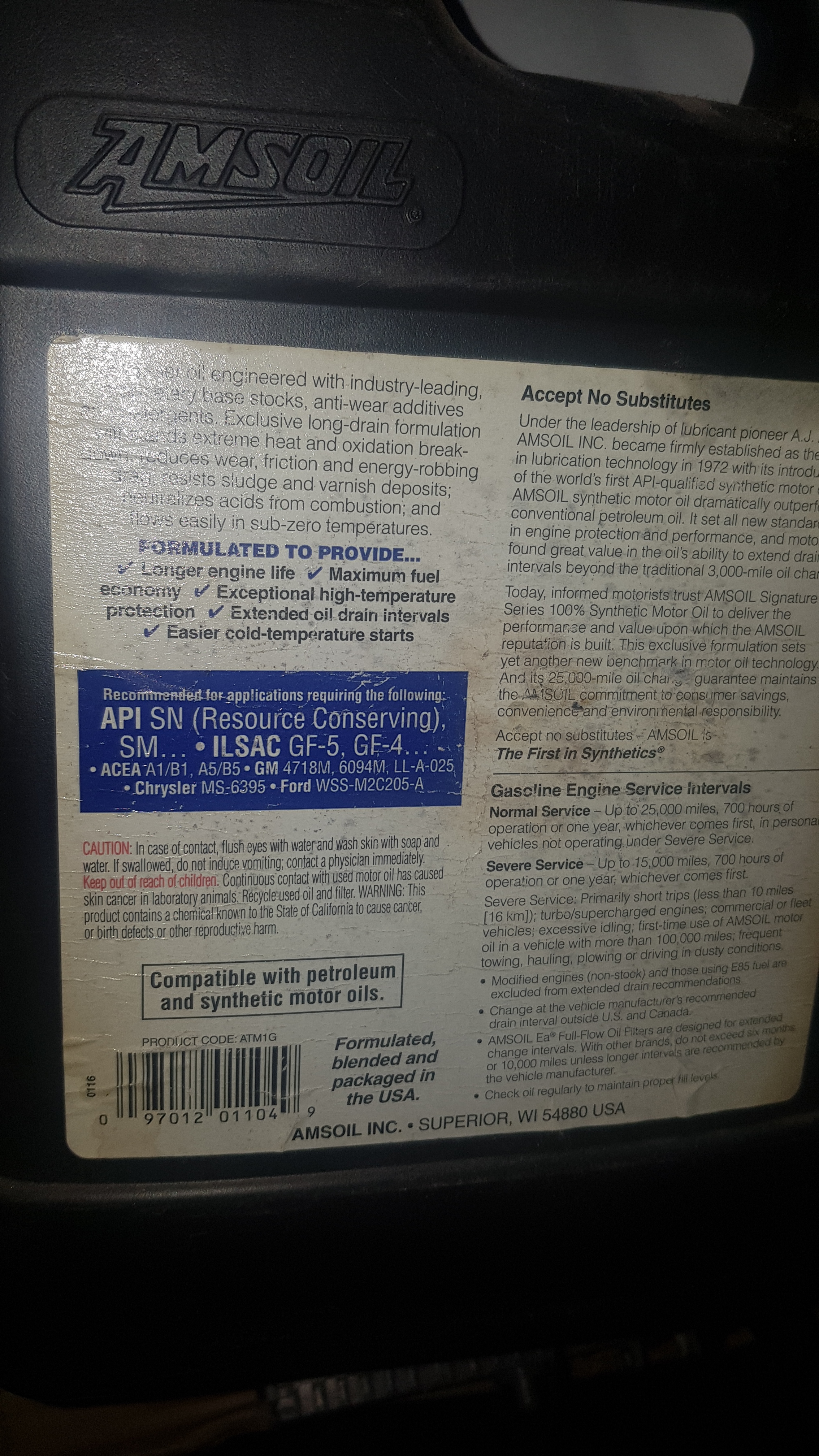

Amsoil Signature Series 100% Synthetic Motor Oil (For up to 25,000 miles, 700 hours of operation or one year, whichever comes first):
Do not exceed 12,000 miles or one year with other brand filters unless longer intervals are recommended by the vehicle manufacturer.
(Source: https://www.amsoil.com/lit/databulletins/g2880.pdf )
Issue is, people do not bother to go in to the details. They just rush by looking at the physical appearance and appealing looks of the things, and get their engines ruined and damaged, and when they rush to claim the damages and warranties, engine oil companies will not take responsibility. Its also the duty to general public, to do some homework, instead of falling prey to such marketing gimmicks, traps, etc.
Amsoil is also not wrong in their place. It is clearly mentioning to only drag up to 12,000 miles, or 25,000 miles, if mentioned in the owners / users manuals, and as per my limited knowledge, I have not come across any passenger vehicle manufacturer, which recommends drain intervals of 12,000-25,000 miles, or 01 year, or 700 hours of continuous operation (whichever comes first), despite having may be larger oil sumps (Yes, they have mentioned to observe engine oil level regularly, and top up when reqd.).
