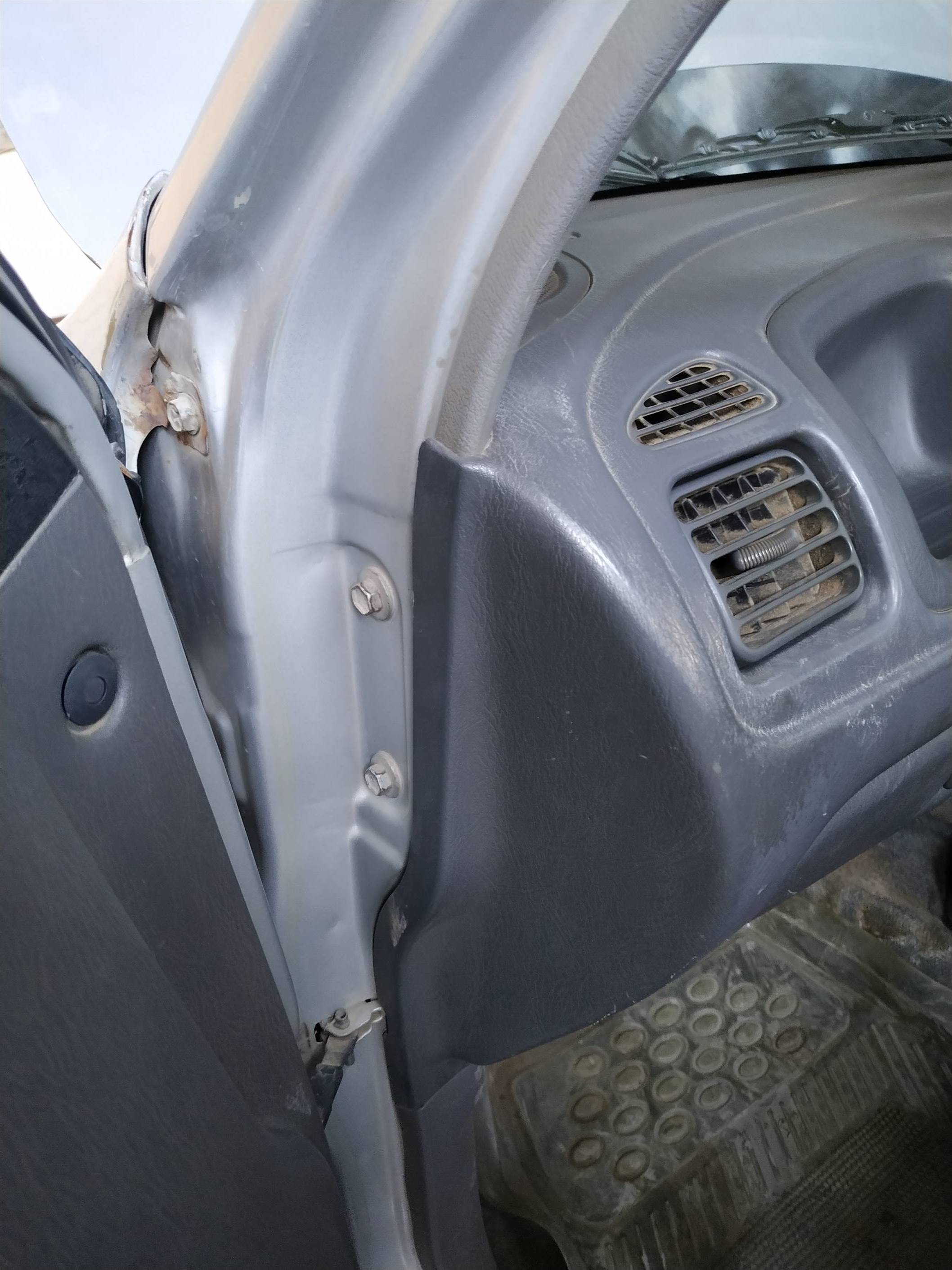

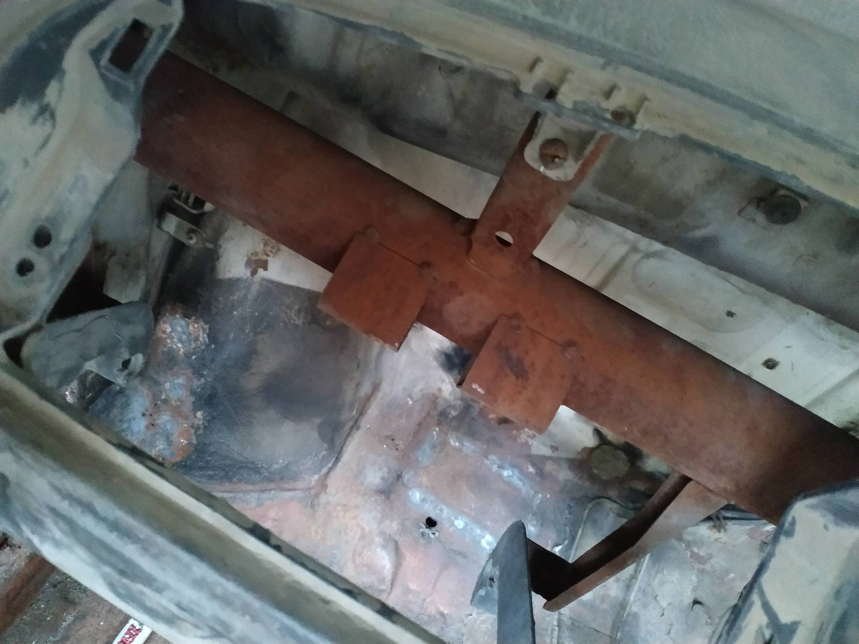

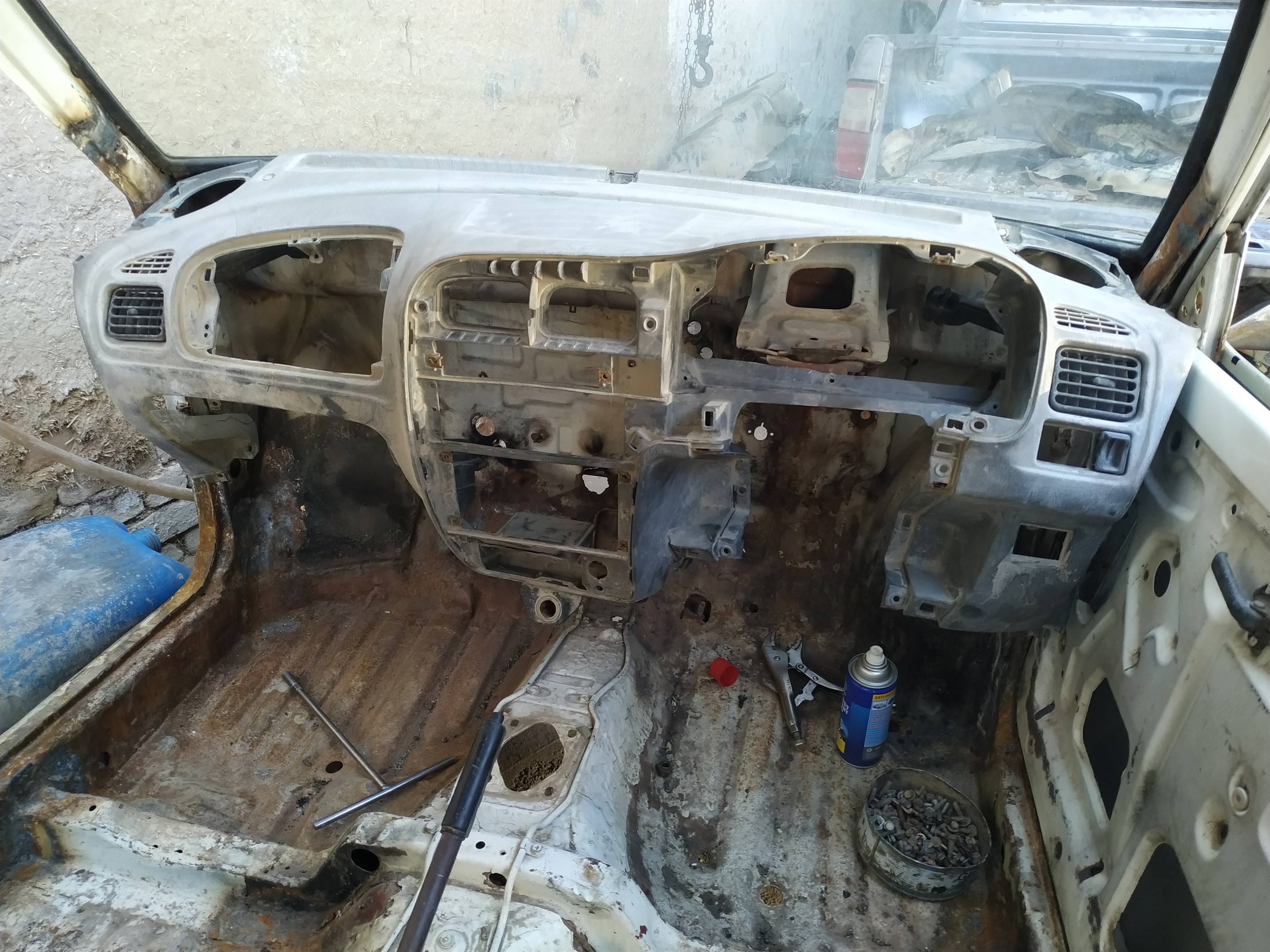

"Does the center rod beneath the dashboard supports the body frame or not? Or it is for support of components under dashboard?"
The only place where the Rod is tethered and fixed with the Body is on the side pillars (two bolts) as seen in the 6th Pic.... I think that does supports the Body in addition to its purpose of supporting equipment (blower cooler, power steering, dashboard itself)

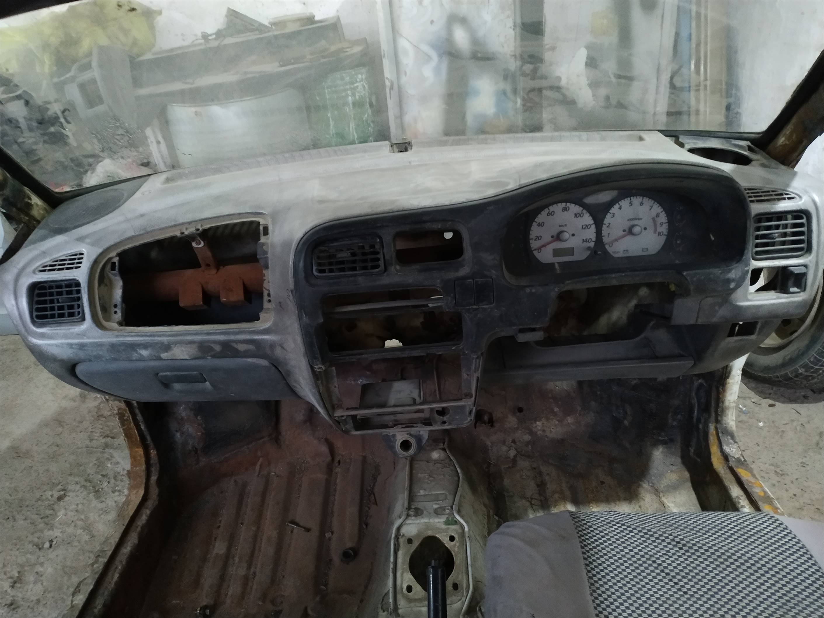

"Are the doors hitting the dash when closed?"
In the first pic you can see that the right side door is closed..... the width of the Dash in near perfect and door closes without any hindrance. However, my denter is of the opinion that a little bit of adjustments are required.
"What about window winder handles? do they clash with the dashboard or not?"
I think no issue for door winder handles would occur. I'll be using power windows so i didn't gave much thought to that. I'll thoroughly see it for your concern on my next visit and will then convey the feasibility and status of window winder handles to you bro
"How much space will be left between the steering and the seat while getting in or out?"
For testing purposes i installed Mehran driver side seat which is a little bit higher than VXR's seats..... i had no issue getting in and out ..... But i'll be fitting VXR seats and my denter says that it will give even more space for entry and exit as well as leg space ...

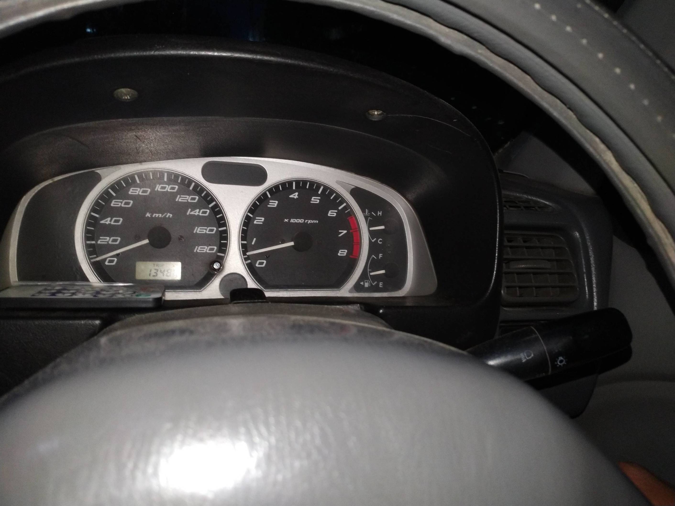

I'll be posting updates regularly and insha-allah the dash will be in perfect fitting as seen so far ..... the main thing i am happy about is that i will be able to use EPS steering, 4 vents powerful blower, awesome RPM meter, place for double 2 din android as well as the overall looks.... this dash is dirt cheap here in quetta for about 8k and abundance of its spare parts ... with the constant support and guidance of you guys i hope to make a great project mehran ....

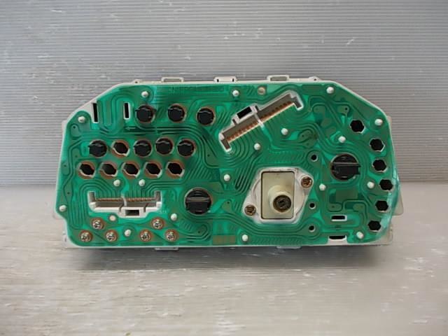

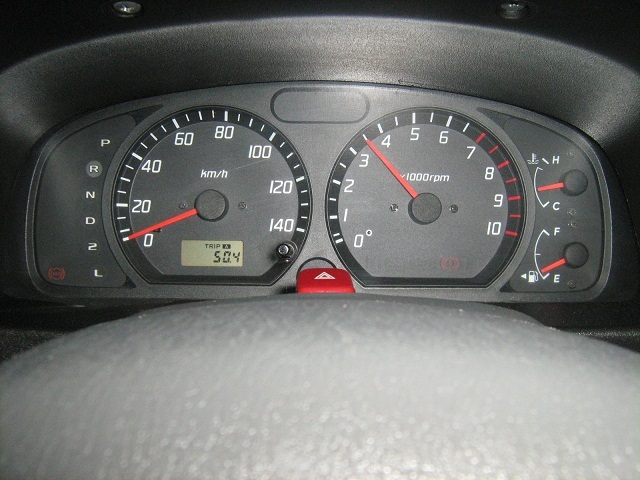

I'll Install one of these RPM meter in it:
