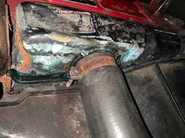

The best way to check t-stat is to start the car, open the hood, and hold the to pipe of the radiator. after few mins there should be a spike the the temperature of the pipe as the t-stats open if it is happening then t stat is fine and may be you temperature send unit has gone bad.
I think you should remove the temperature sending unit and check its resistance according to manual using multi-meter.
