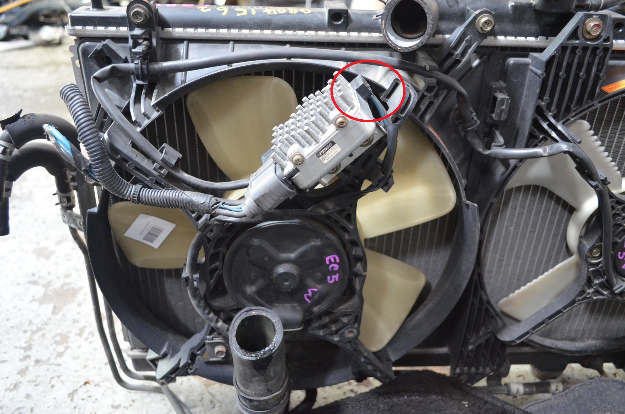

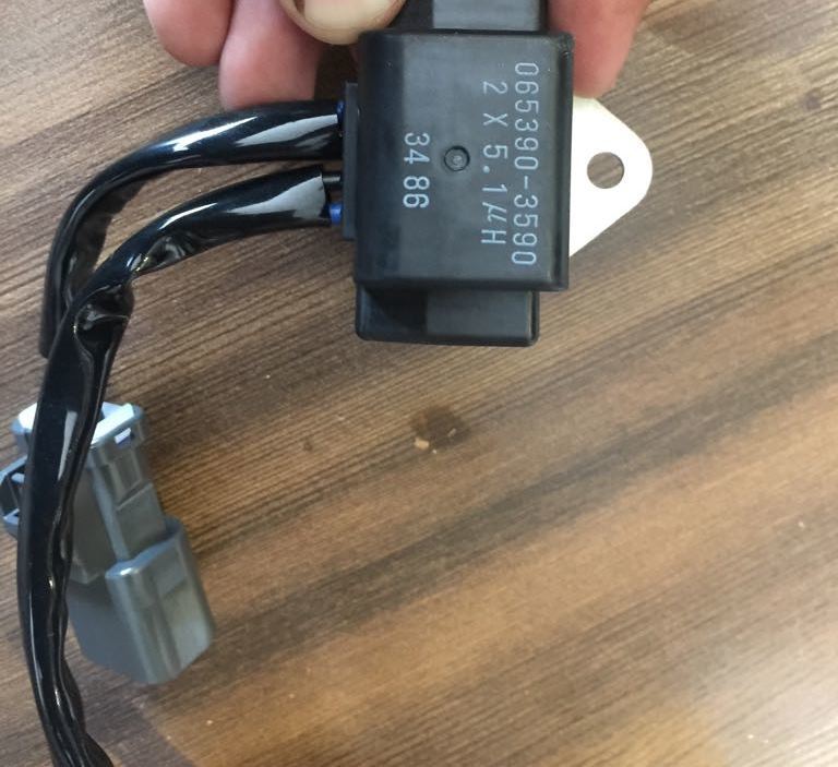

I am facing this problem in my gallant 2.5 vr, fan worked changed speed from low to high relay, fan module all checked but fan worked normally at both speed I mean not that fast like the local cars fans, faced some heating issues only during stops at traffic as soon as I move the needle would get normal, but when I direct them by just pulling the ECU wire out they run at full speed and no heating issue at all even if you are with AC on for 2 hours at full stop. So the issue is more air needed by engine. I spent many hours and hard earned money to increase the speed in auto mode but all in vein I can't be changed because that's how they designed the system, best option use direct in summer and auto in winter, no harms to engine in direct mode just the car will take 2 more minutes to reach optimal temperature.
Can anybody please help me get the fans at high speed on automatic.
