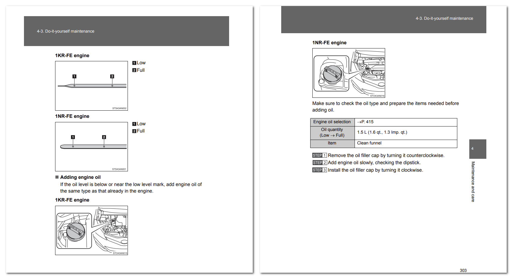

While going through the user manual, I came across this,
When oil level on the dipstick goes from full to low, you've lost about 1.5 L. I assumed you'd lose 3 L.
If that's the case then I've lost about 750 ml after 1550 KM of driving in the city. 1550 because I looked through my old screenshots and I was wrong about the 1100 KM figure.
From the next page in the manual:
Engine oil consumption
- The amount of engine oil consumed depends on the oil viscosity, the quality of the oil and the way the vehicle is driven.
- More oil is consumed under driving conditions such as high speeds and frequent acceleration and deceleration.
- A new engine consumes more oil.
- When judging the amount of oil consumption, keep in mind that the oil may have become diluted, making it difficult to judge the true level accurately.
- Oil consumption: Max. 1.0 L/1000 km (1.1 qt./600 miles, 0.9 Imp. qt./600 miles)
- When driving at high engine speeds or with a heavy load, when towing, or when driving while accelerating or decelerating frequently.
- When leaving the engine idling for a long time, or when driving frequently through heavy traffic.
- If your vehicle consumes more than 1.0 L (1.1 qt., 0.9 Imp. qt.) every 1000 km (600 miles), contact any authorized Toyota dealer or repairer, or another duly qualified and equipped professional.
