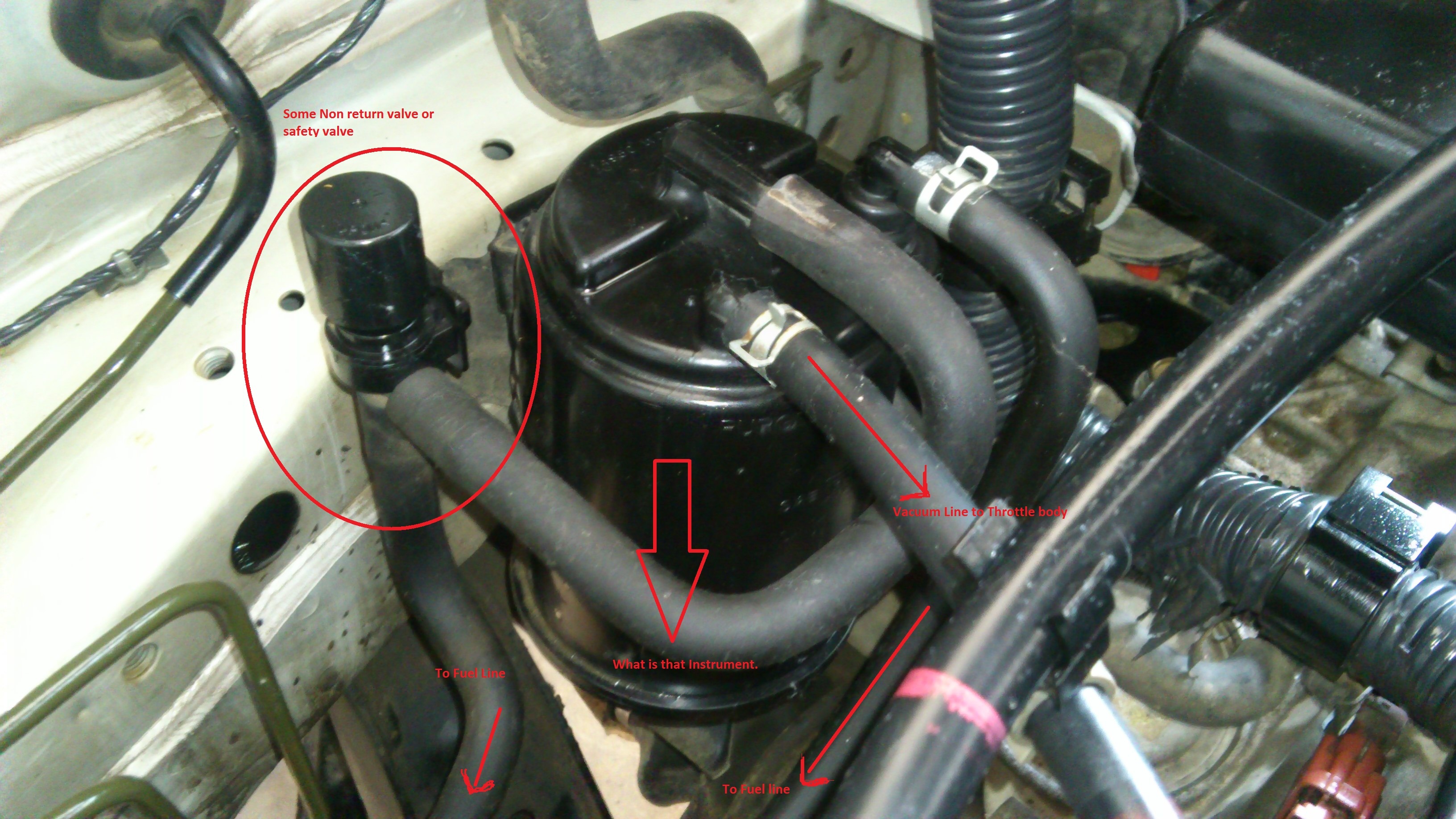

One more thing I would like to ask, there is a canister like thing installed in engine bay beneath the air filter housing. Three pipes are connected to it. One from the throttle body (Vacuum line), other two to the fuel lines going to tank. What is that thing and what is the purpose of that canister. Is it serviceable or a replaceable part?. I will post the pic soon.
