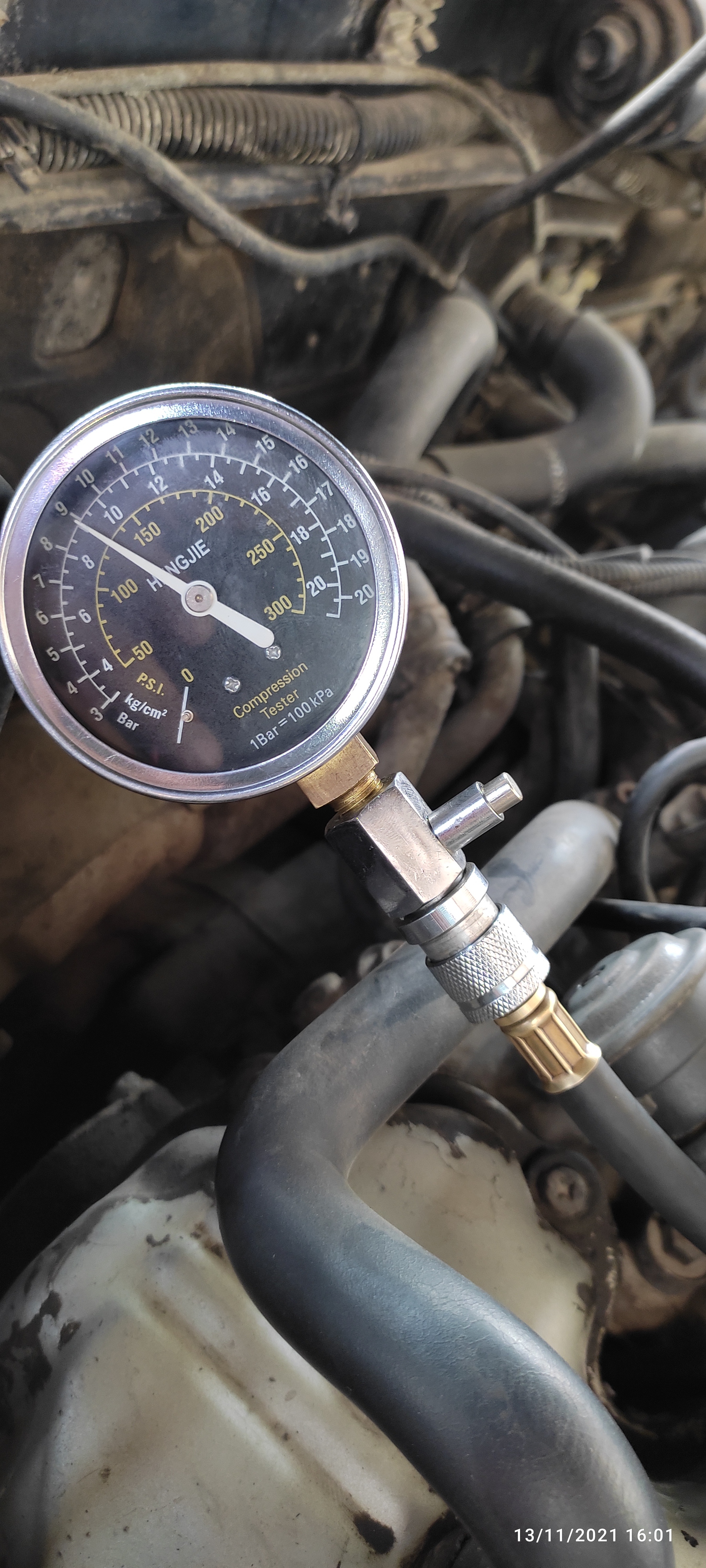

Performed compression test. Here are the results.
Driver side cylinders
Cylender # -----Dry.----------------Wet.
01.------------------130 psi----------- - -
03.------------------130 psi----------160 psi
05.------------------130 psi----------- - -
Passender side cylenders
01.------------------130 psi-----------170 psi
03.------------------085 psi----------115 psi
05.------------------140 psi----------- - -
