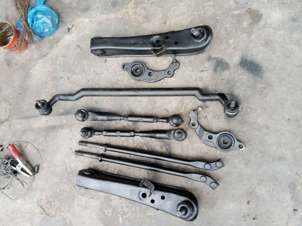

I will try to upload the pictures tomorrow from PC . Current progress......
